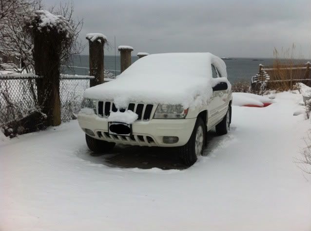

Jeep is back home, it seems to behave much better on the gas I get here at home, weird. Here are some pics from the recent snow that prevented Jeep work for a couple days:

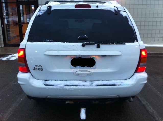

And another pic of my quad taillight mod, this is a good pic to show brightness:

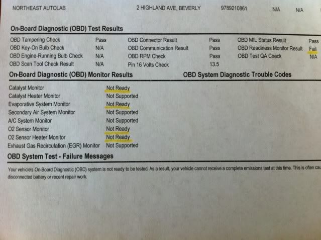

Then I failed emissions because the monitors weren't ready yet @!#$%^. Gotta do another drive cycle

Wanna come do my Jeep? The dog is a nice touch.
I like the snow out there. I bet you've been having fun. What's next on the agenda though, any major mods/ugprades?

Snow has been pretty good but its horrible when you want to do work on your Jeep. Cold, can't kneel on the ground. Also snow means salt which means corrosion on Jeep . Its a neverending battle

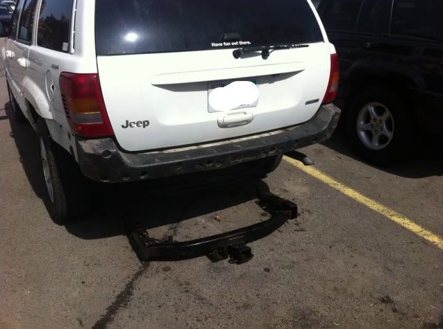

Alright it was a complete pain in the butt and a half but I finally got the hitch on. Today was a much better day, everything had been soaking in PB and came right out. The two broken off bolts are there and will remain there until I get home lol. The good news is I dont have to tow a u-haul with only 2 bolts on each side. Turns out theres an extra bolt hole in the front that I noticed the uhaul guys didnt put on, must have been too lazy to do it. All I need to do is get a bolt about half as short as the ones I have now and I'll have 3 bolts in. I used some washers and misc hardware to space everything perfectly and its solid as a rock. I painted it a couple coats with flat black. Now it looks even better than the pic above. Then I finally figured out how to get the rear bumper off (just had to stop being a puss and yank on it). My harbor freight dremel couldnt do anything (kept dying out under any pressure) so I cut the outline for the bezel creatively. Scored it with my nice new Craftsman utility knife (thanks mom!) and then used a cerrated rigging knife to saw through it. I used a soldering iron around the edges to make sure it stayed clean. Yes, it was completely ghetto but I was working out of a parking lot without all my good tools. At the end the dremel was handy for lightly sanding the edges to smooth it all out. IMO it looks great, not as bad as I thought without the bezel. Eventually going to order the bezel once I have extra cash though. For the wiring I just have a hopkins 7-pin (bolted right up despite my doubts) but I might eventually get a factory socket. My wiring harness is in the mail and I'll just chop it up and splice it to fit this one. Yay! Now for some pics.
Buh-bye old structurally compromised U-haul hitch:
