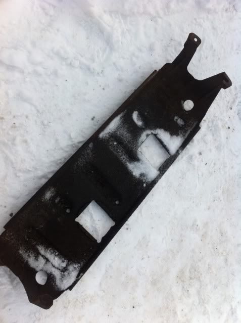

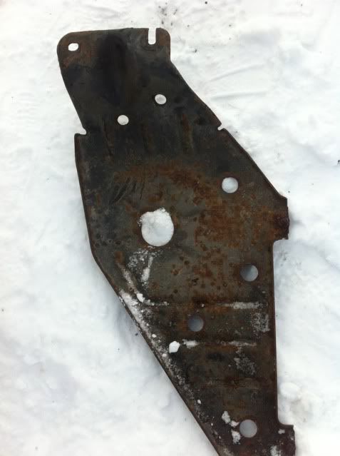

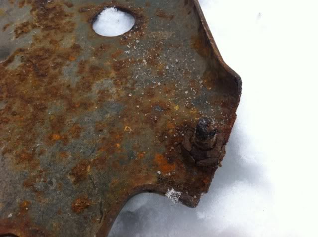

Alright, maybe you guys can tell me based on these pics I took (yeah they're already off the WJ how nice is that?) but I think somethings wrong with the transcase skid. How does it mount up?
Looks like there are bolts snapped off in here
The front skid is in amazing shape all the "rust" you see is actually just debris and oil, its actually in mint condition. and wipes clean.

^ I picked up the above pictured skids, $15 each so it was a good deal! I grabbed a bunch of bolts hanging out in the interior that I thought were the right ones, we'll have to see... I think I need to get those bolts out that are in the transcase skid. Oh, and my Jeep reeks of PB blaster now because they're sitting in the back until I install them lol

On the transfer case skid, the two holes at the top of the picture mount to the "frame" while the holes on the right side of the picture mount to the crossmember. I believe you also need nutserts for the skid to mount to the "frame".
