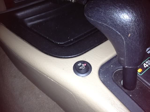

All done! Heres what I did tonight!
Got the seat out of the Jeep (4x 15mm bolts and 2x harness plugs) and into my room, took the switches off the side (3x phillips screws and 2x harness plugs)
Undo all of the plastic long J clips, the ones for the seat back cover are hidden and may give you trouble.
Then start peeling back the bottom seat cushion only to discover hog rings, YAY hog rings! Just cut them with a good pair of electrical dykes. I hate hog rings, use zip ties when you reassemble, works just as well.
Got the bottom cushion nice and centered and stuck down, but had to trim it because of the design of the seat
Got the seat back cushion up there, unfortunately, also had to be trimmed, but still covers more than factory heated seats do
Stuffed the wires through (tip, cut a slit in the foam where the wires route) and zip tied so they wont get in the way Then pulled the cover back over and refastened all of the J-hooks. Use zip ties where you previously found hog rings.
Made a little slit in the carpet by the seat and ran all of the wires, grounded by the airbag computer, ran the power to the front by the cig lighter
And after diagnosing a bad connection or two... we have HEAT!
The ebrake was a pain but I figured it out so I have an e-brake again, yay. I had to apparently wind up tension in the spring and then theres a lockout spring you flip down while you attach the cable then you tap it and it unlocks and pulls the cable tight... My cable wasnt getting tension because it became unhooked at the distributor, which via the FSM I learned is underneath the carpet via a flap under the rear center seat. Thats also where the ABS g-force sensor is.

That is a pretty cool place for the switch actually! I like it! I fixed my heated seat, it was so nice!

My picture doesn't do it justice, it blends in really well with the interior. What did you do to fix yours?
