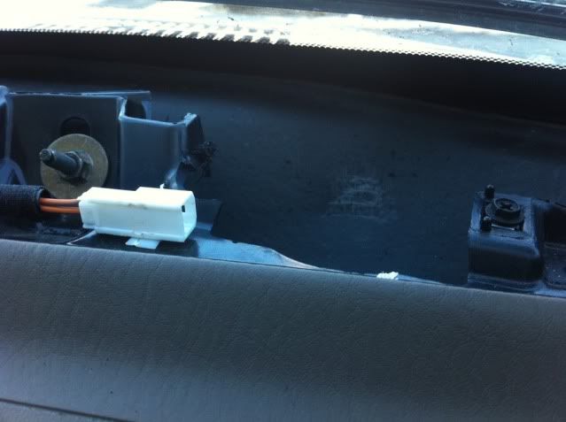

So anyways, last night I couldnt drive without dash speakers so I tossed my kickers in and they slipped in decently, the upper dash piece over them clipped in pretty well but not fully so I'm going to reinstall those today with pix. I also plugged in my iPod adaptor but again, I didnt put the cable exactly where I wanted it so I will redo that today with pics as well. Going to at least get my inverter outlet clipped in place today, its a dremel kind of day today haha. Still a bunch of cleaning to do, my grandma never was the cleanest person in the world. The shifter blinds absolutely SUCK to clean for the record. Last night I completely vaccuumed, treated the leather, armor-all'd the dash, and generally cleaned up the interior. Engine bay is a wreck I might deal with that today too

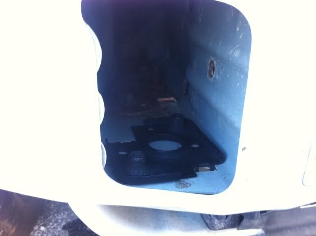

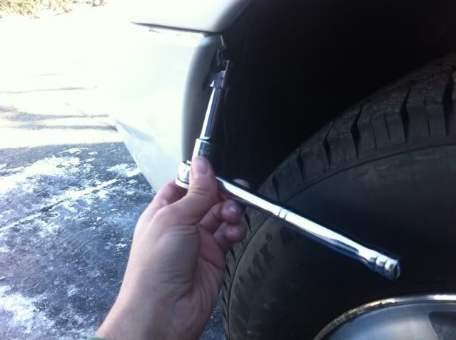

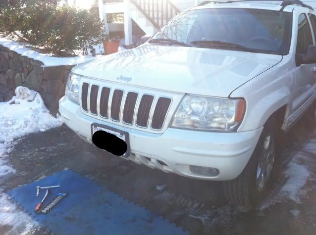

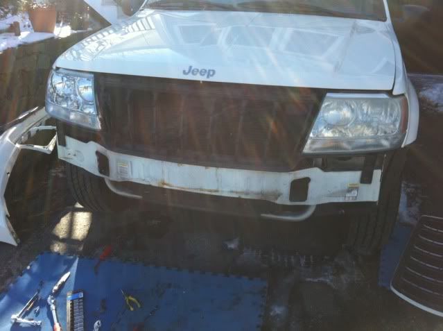

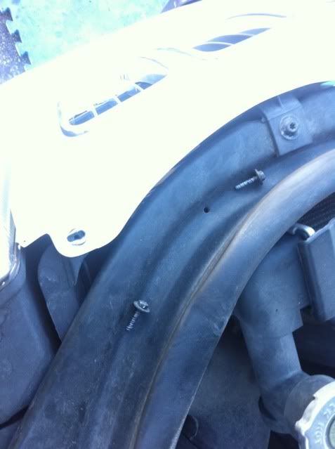

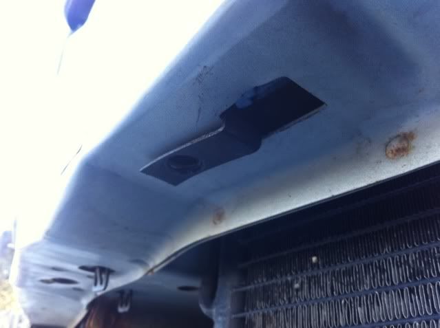

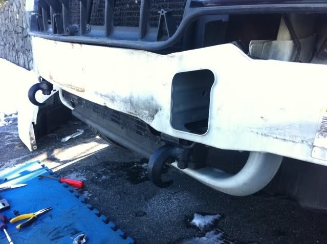

Got my tow hooks on. Pics as promised. Before the teardown:
snipped the heads off of all the fenderliner clips. On reassembly I tucker the fender liner behind bumper cover so it holds perfectly without the clips.
My panel popper was perfect for undoing the bottom push clips
10mm screws on each side of the bumper cover
Four screws on top of grille and three inside grille:
Bumper cover slides right off (unplug fog light wiring first if you have fogs):

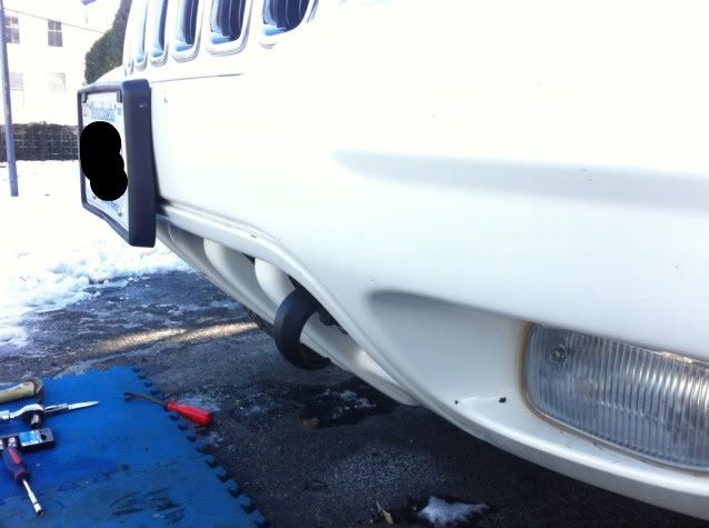

Mounting plates clip right into place
The U-nuts were tricky, I put them in pushing towards the front of the bumper then I gripped them with pliers and twisted right into place. Was seemless.
Tow hooks all mounted up!
Bumper cover back on!
p.s. if you're like me then you'll completely forget to plug your fog lights back in and curse yourself once you're inside. Its too cold to be out and under the Jeep again I'll get around to it lol

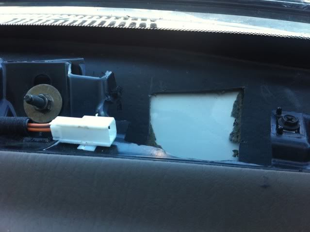

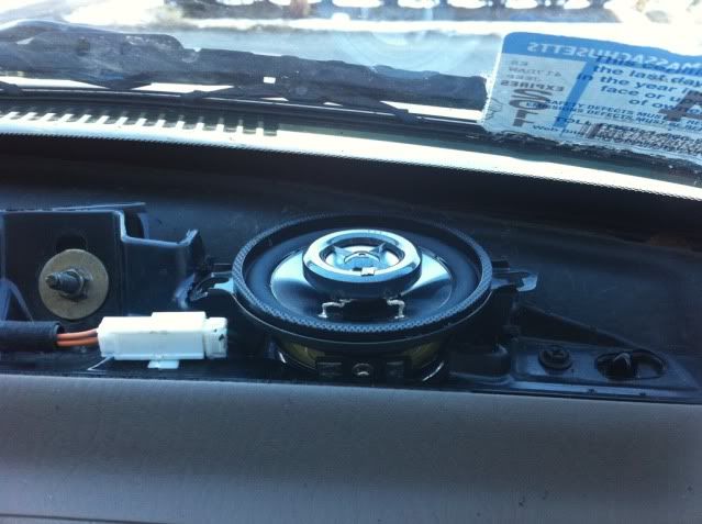

So heres what else I have to show you guys. Kicker KS350 install. Despite the pics, I ended up dremeling off both of the mounting points for the factory tweets.
You can see where the speaker was rubbing the insulation so a razor knife took care of that
Nice fit snug and down low

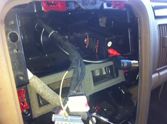

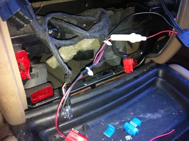

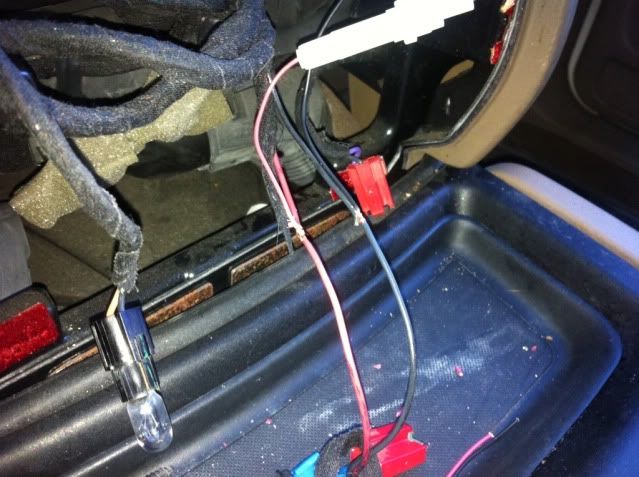

Sealed up and zip tied
Theres my PIE interface on the side there. Slips in perfect
Plugs in just right

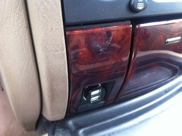

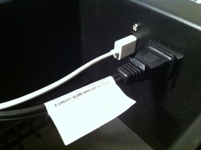

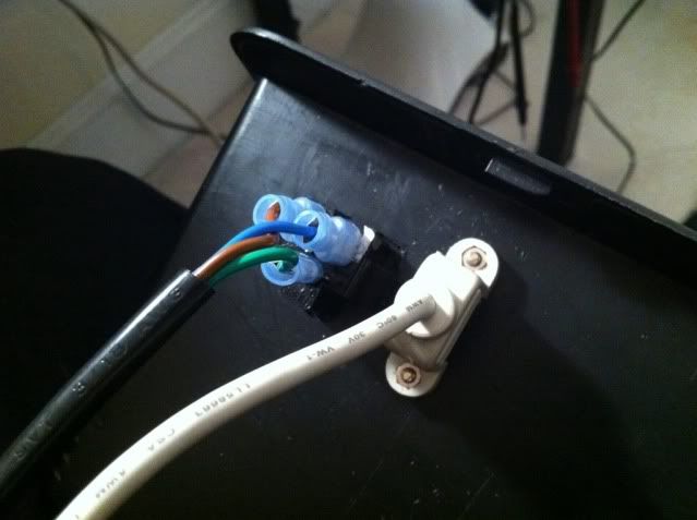

And here are my attempts at a power inverter install. Stupid me I didnt check for clearance so this will NOT WORK. Dont do it, I screwed up there is no clearance. Do it on the front below the change organizer. Looks nice though at least...

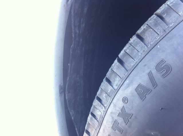

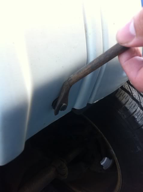

Also, pullin my mud flaps today unless somebody can convince me why I need them, looks like theyre just killin ground clearance

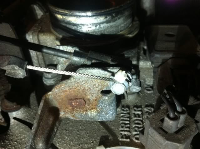

Cruise control was non-functional, found out the plastic end on the cable snapped. Doesnt look to be replaceable so I improvised with a zip tie. Works great!

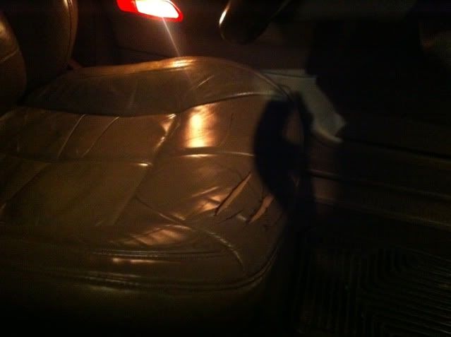

And cringed at my torn leather ;( really want to fix this
