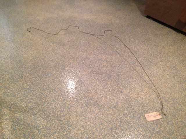

Hey guys check this out! Right from the dealership, Mopar solid brake line from master cylinder to the a-arm connector (mines very rusty and needs replacement)
And heres the shocking part:
What a deal right?!
Matt
What a deal right?!
Got one of them awhile back for 12 bucks hah only hard part is fishing the line to the rear ....have fun I have faith in you
Sent from my iPhone5 using JeepForum

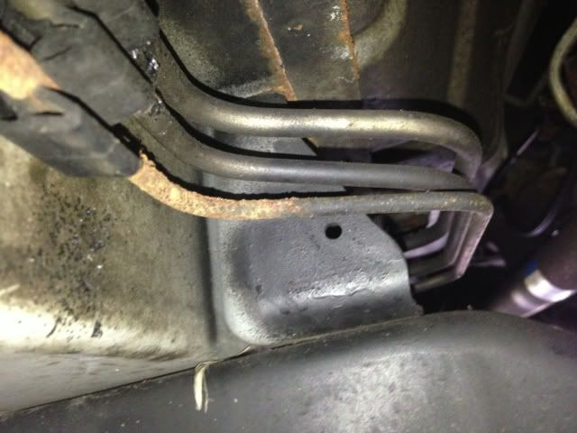

Nice deal! Yeah I'm looking at the bends right now, looks fun! I did some reading and people say its quite literally child's play once you've got it fished into place. I'm going to mock it up and see if I can get it into position and then do it, otherwise dealership gave me a reasonable flat rate quote on putting it in. If its out of my league I won't touch it but it looks surprisingly easy and a quick bolt in and bleed the brakes.

Well, if you want my honest oppinion, I think they know, and it is cheap to discourage anyone from second guessing the safety concern behind a brake line that rots out after 100k. Rest of my Jeep is really clean and free of problems like this but just this one area by the rockers seems to take so much abuse on the WJ. Look at that transition picture. Its clear that they did not properly shield this area on the Jeeps and that they must take some kind of straight road abuse. And look at the stainless steel fuel lines above that, they look perfect. Also. A big thanks to Squashman and his mechanic for bringing the safety of this line to my attention.
Edit: this transition picture:

It's really easy once you get it routed in the engine compartment

This is good news!
Seeing as I snapped a bleeder off one of the rear calipers checking to see if they were seized, I just ordered two new loaded calipers (new caliper, bracket, hardware, and pads) for the rears and I'll probably toss a fresh set of rotors back there too. You know while I'm in there I'm also putting a new e-brake hardware kit in there because I've never had an e-brake so tight I struggled to pull it to the top. Anyways, no messing around when it comes to brakes its a safety concern and a liability. This is starting to be expensive but you can't put a price on awesome brakes and my mechanic was going to charge way too much to replace only half of what I'm doing. I've got a vacuum bleeding tool that works awesome and the line hasn't breached yet so it should be a very painless bleed. If I can't get it bled right I've already got the money set aside to let the dealership do it using their fancy Starscan bleeding software using the ABS pump.
