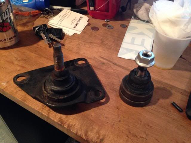

Alright all, I need a bit of help. I am reinstalling the stock A-arm but the ball joint is loose. Alas I have a new ball joint. A-arm is out of Jeep and I've separated the old ball joint from the arm but now I'm stuck.
Stock ball joint is pressed into the bracket, new ball joint does not have a bracket. Need to press old ball joint out and new ball joint in. I've got hand tools, a vice, and access to rental tools at autozone. Anybody know what I need to do this? I want to give the next owner a nice fresh ball joint in the rear (I know I'm too nice).

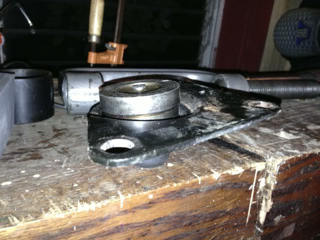

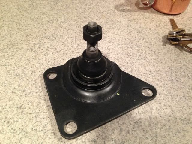

Got the press and it made childs play of the ball joint. But much to my demise I can't get the new one in. I had the hardest time in the world trying to get the new one alligned and going in straight. First time I tried it went in at a slight angle and I backed it off and tried readjusting and fixing it, and then in the process applied too much force and cracked my vice (really sad about that, that bench was a family hand down type of thing). Then tried my other vice and the thing kept slipping and still couldn't get it in right. Then tried applying heat and that went downhill. It boiled down to not being able to hold everything straight and apply square enough force (think, applying clockwise torque on the clamp) to get it to line up properly.
/rantoff I just ordered this off amazon prime and it will be here friday *hrmph*
Oh by the way if somebody wants that brand new moog ball joint and the plate and thinks they can press it on PM me and you can come pick it up at my house for $0. No I will not ship it.

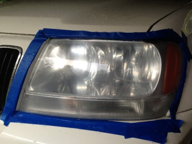

New A-arm ball joint coming tomorrow. Meanwhile I decided to pay attention to some details. When I pull the suspension apart again I need to look into a popping noise, drivers side floorpan area after braking on a right hand turn. Weird stuff. Normal driving nothing out of the ordinary. I also took today to clean up my oxidized headlight. Did 1500 grit sanding sponge and then some Meguiars plastx and it looks 10x better already, but still some higher grit paper is needed because a couple scratches still there from the pad. Also got some touch-up paint, smoothed out some of the small chips and scrapes and that was another tenfold improvement, exterior looks great right now.
Interior got a full vaccuum and shampoo and the Interior is now proper colored again (I went back to the sandstone seats and door panels). Working on that damn ball joint and suspension this weekend.

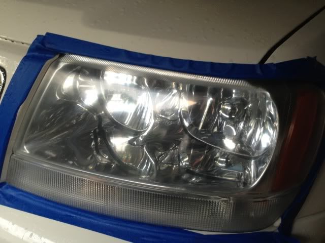

Finally got around to finishing up those headlights. 1000 grit wet sand
2000 grit wet sand
2 applications of meguiars PlastX.
Its not quite brand new but the improvement is massive and I got a good 20% light output back at night.
