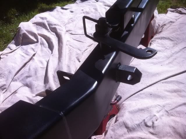

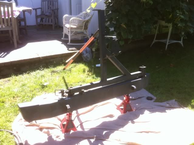

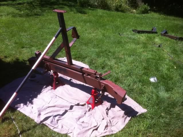

Workin' on the tire carrier today... painted it all up which took a while as I uncovered more rust :/
Sooo I sanded and scraped
Loaded it up with rust primer
And the final result with semi-gloss black turned out beautiful
Up close
And this is about as far as I got after getting distracted all night and so I decided to leave it here and put everything on in the morning
The two bumper mounting bracket studs on each side were a royal pain to get off I eventually got fed up and saw-zalled them apart. I also went to the hardware store and got all of the necessary fasteners including the button (hex) head bolts for the outer quarter panel so everything will look sleek and clean. Drill battery died on my trying to drill pinch weld holes which was the final straw that made me give up for the night. It was also kinda buggy out too. Everything is painted and dried and the four drill holes are marked so everything should go on tomorrow. Now I should really get a FS spare that tire carrier would be embarrassing with a donut mounted up to it

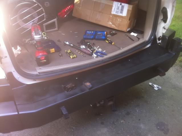

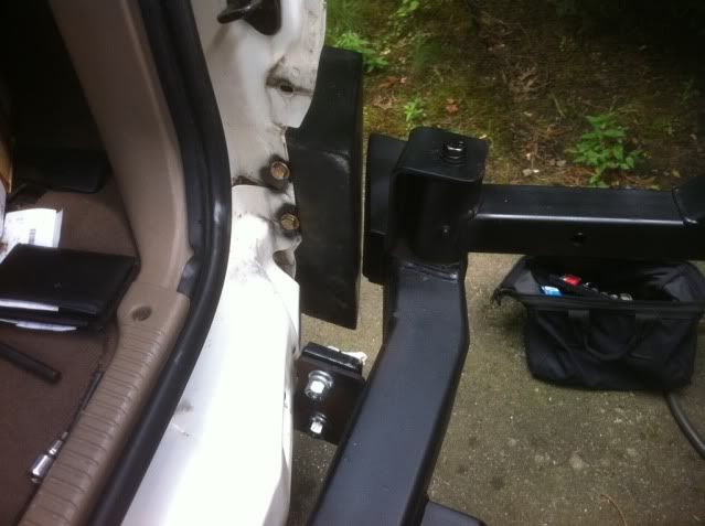

Where'd we leave off?

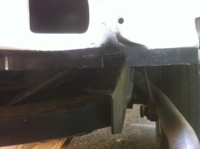

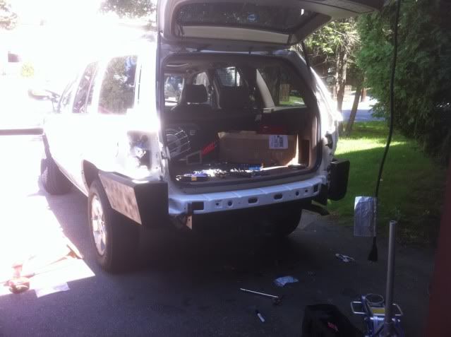

Had to cut notches using my saw-zall in the pinch weld for the brackets to sit flush to the frame rail
Holes drilled and rust-proofed for the side armor

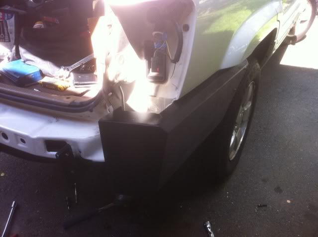

Side armor fitted
Bolts for side armor

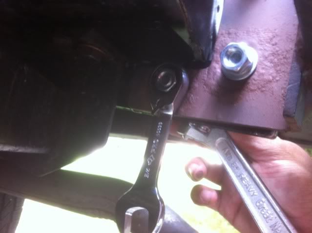

Front button head bolts for side armor
Ratcheting stubby open ended wrenches were the perfect tool here
Side armor and brackets mounted up tight
Got my buddy to help me lift it and get the bolts through
Adjust forwards/back before tightening down
Cranking down 3 main bolts per side
All mounted up

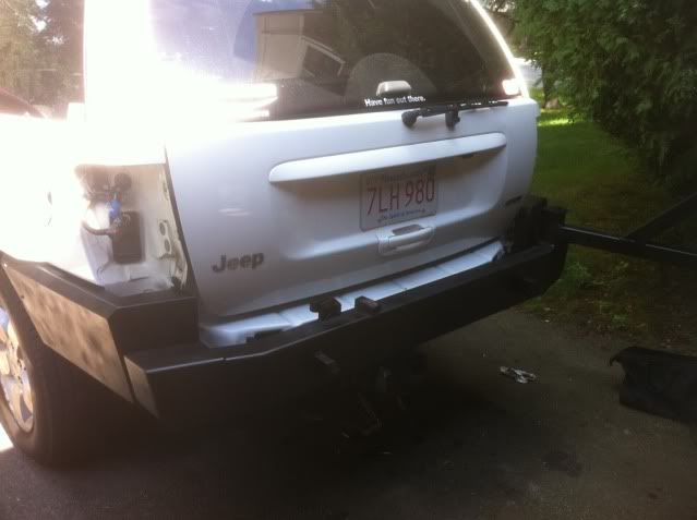

Maneuvering the trim piece into place, probably should have done this before tightening down bumper

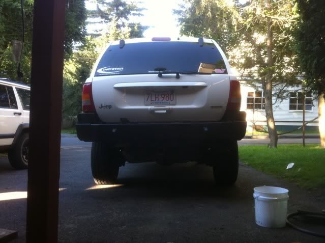

All fitted up and tail lights back
Side view
Factory donut does not belong

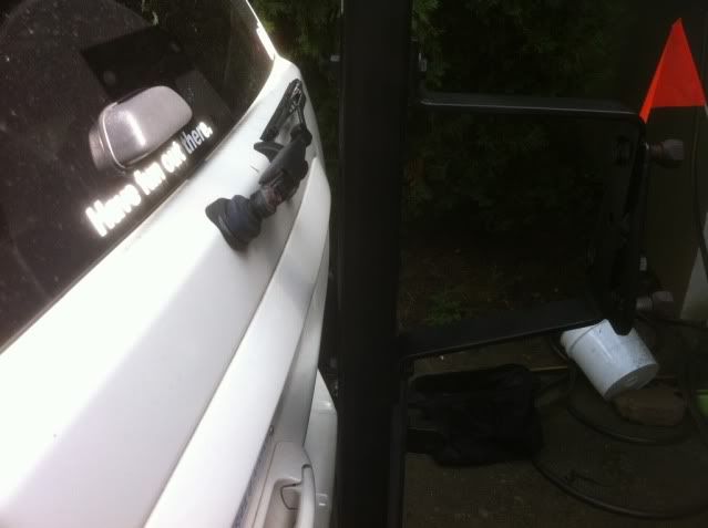

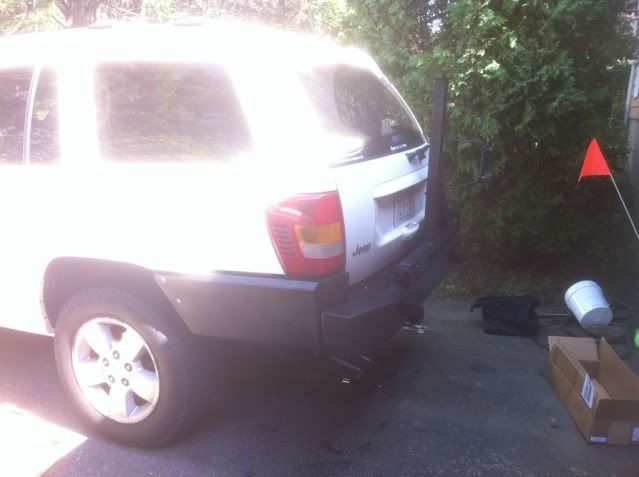

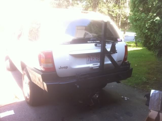

So I took the tire carrier off till I get my new tires
Side view no carrier
