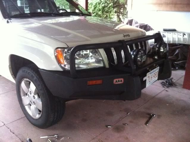

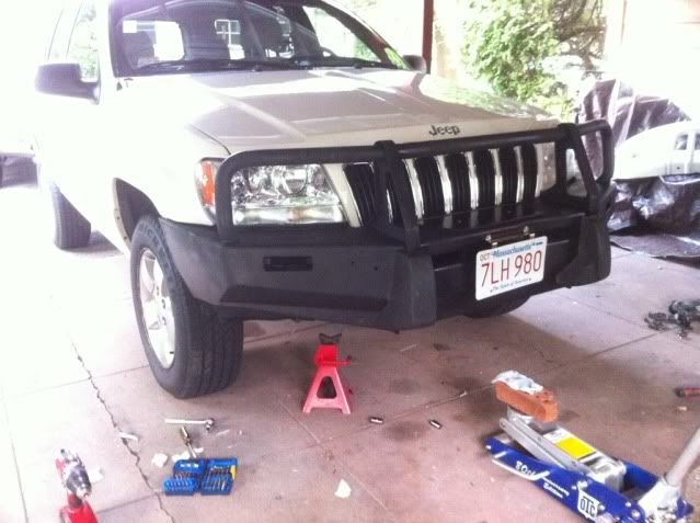

Aaaannnnd it's ON! the front at least. Still need to wire sidemarkers and drill lock pin hole. I'm having trouble getting it up high enough theres too much gap IMO

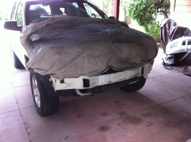

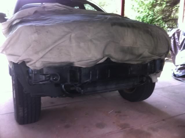

nobody really takes pics during their ARB installs so I figured I would. alot of them lol

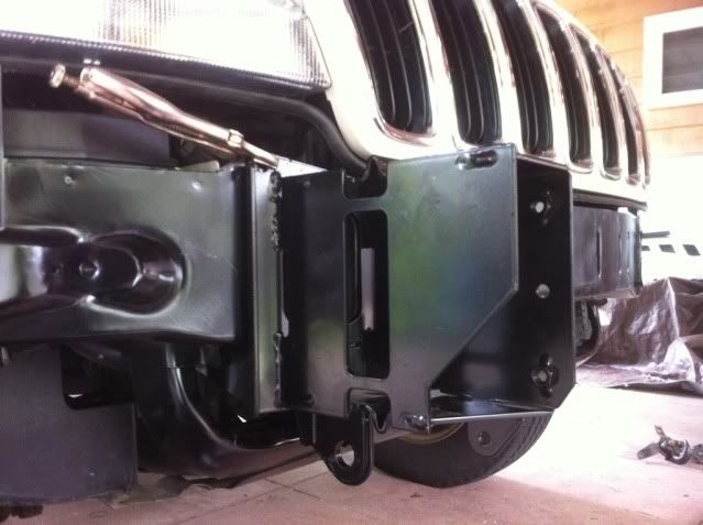

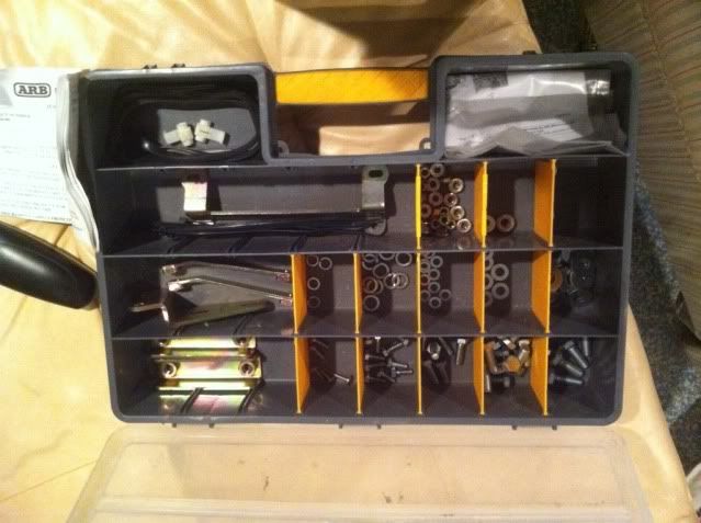

sorted all of the hardware out... helped me out a ton during the install

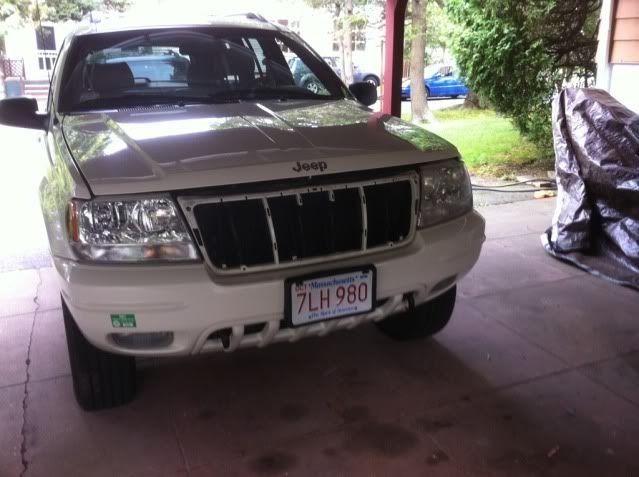

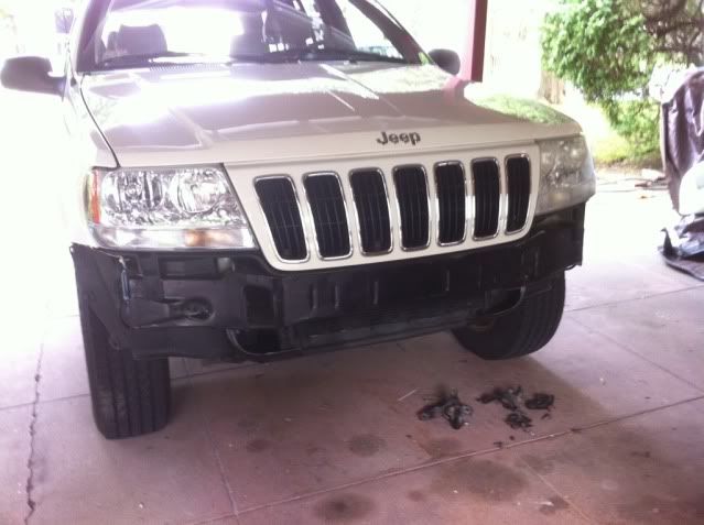

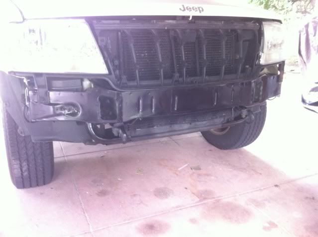

took front grille off... three screws in grille four screws on top

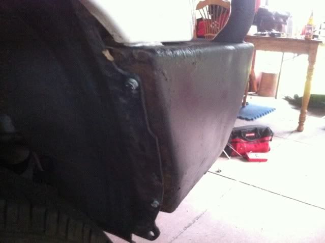

took front bumper cover off... two hex screws (3/8?) on edges of bumper where meets fender, a couple push pins underneath, and the wheelwell liner rivets need to be cut then the bumper cover slides straight off. Then cover up your paint on the front end
spray painted black so that no white shows through ARB vents
uncovered
I found my grille was perfectly sturdy without the backing thats attached to the bumper... so I just went with it. Screw it back in

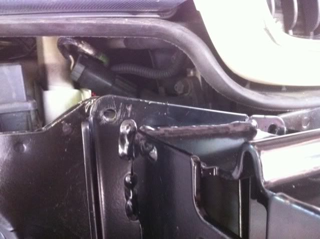

Take your time here and really flatten the lip out.... I didnt and it costed me... my ARB is about 5mm below where it should be and its really bothering me because I didnt flatten this lip out enough and the bracket is sitting at an angle. I need to take my ARB off eventually and redo this part

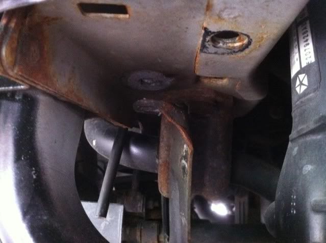

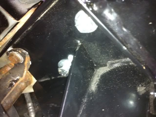

If you have a front skid unbolt the front bolts and loosen the rears so it droops a bit because ARB bracket sandwiches in between front skid bracket and frame. Good planning on ARBs part that the brackets are compatible. You'll need 15mm socket here
If you have factory tow hooks... remove them now. The ARB brackets will replace them and have a 3/8" hole for D-rings/recovery if you're worried about losing recovery
Clamp up the bracket with a vise grip. itll kinda fit itself around the frame access lip

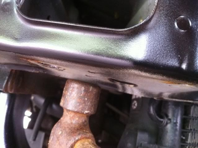

insert the captive nut plate where your tow hook bolts would be
start to thread bolts from underneath do not tighten
drill two holes in front bumper like so... using bracket as template

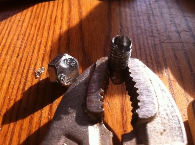

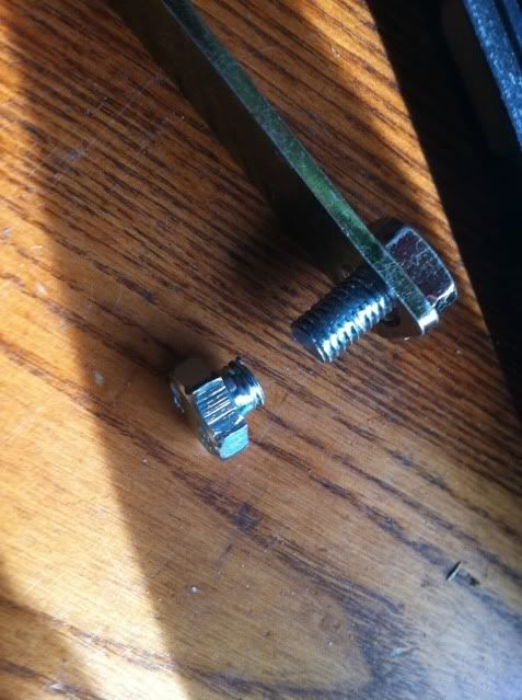

while tightening bolts through the holes into the backing plate provided by ARB... please dont overtighten... I did. Be aware the fit is very iffy
For some reason I had to eventually drill the bolt out to free the threads... annoying
bolts with backing plate
tighten down bolts for mounting brackets
lift and mount with four bolts... get a couple helping hands!
once the ARB is adjusted drill the "lock bolt" hole in the ARB bumper. I havent done this yet because I'm not done adjusting my bumper

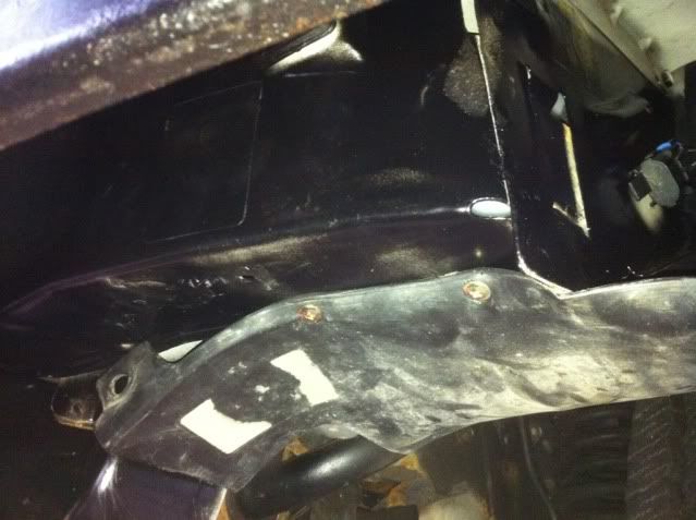

bolt up the wheel well liner (one hole on bottom must be drilled upper reuses existing hole
go underneath and fold up hanging wheel well liner and use self tappers screwed into pilot holes

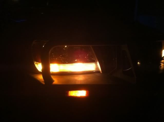

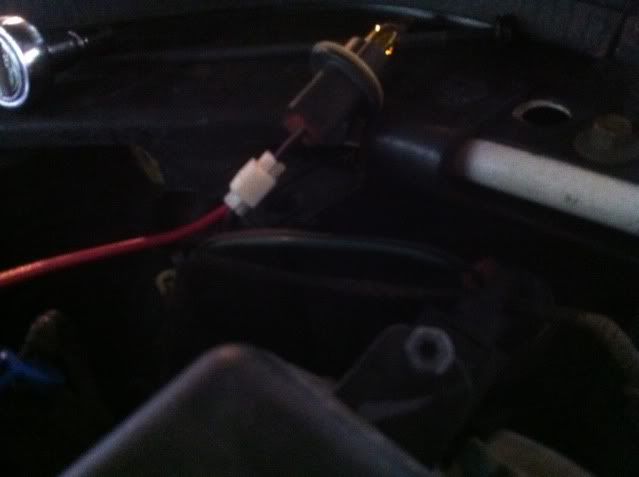

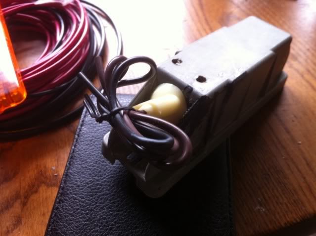

my ARB was used and had strobes instead of regular bulbs so I had to buy the following

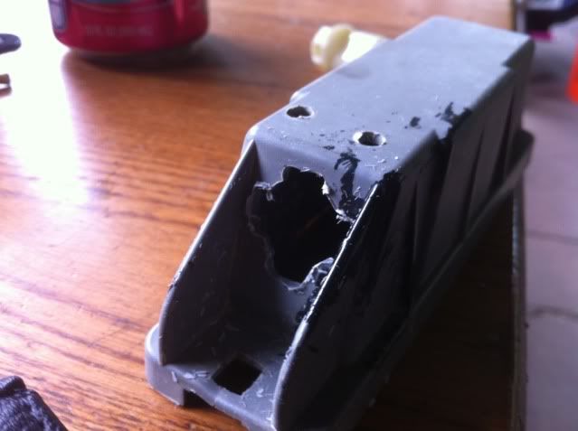

notched the housing out with a dremel
nice fit
tapped into the lower right parking light (the one that stays on independent of turn signal action (didnt want my clearance markers flashing)

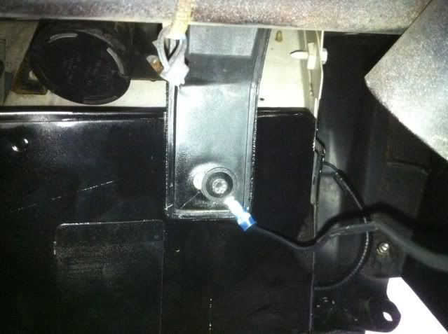

grounded clearance markers to the header panel torx screws
beautiful
nice at night

yeah man its what happens when you rush one part of it haha thanks for the encouragement I need to justify all the hours put into this Jeep somehow... Actual install time was only 3hrs for me including the broken bolt... if it means anything to people. ARB estimates 3-5hrs
good news bout the alligment is its not hard to fix I just need to re-motivate myself to lift that bumper off and get in there with a sledge lol
