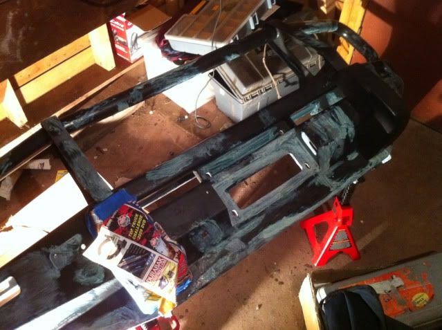

I had the bumper out of the shed so I figured I'd catch up on some prep work. Sanded off the crappy rattle can job the previous owner did and found out why he did it. Found some nasty little rust spots had to sand down to bare metal and a bit beyond to get rid of one or two of them. Almost rust free though and I'm going to treat remaining areas with POR-15 and then run a rust primer over and then a general primer then it looks like I'm going for satin black paint and if I dont like the way that looks I'm going to jump to Rustoleum textured. As one of my friends mentioned, bedlining it would make it look like a roided out trail rig... which it really isnt right now.
In the pics you can see the ARB original powdercoat looks 500x better than the PO's spraycan crap

the rust made me kind of edgy so I layed on the POR-15... will be priming in a day or two once por15 is totally cured
