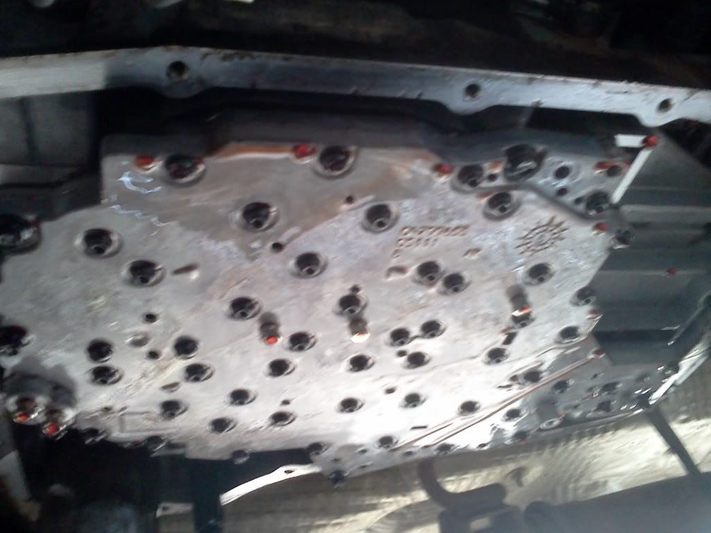

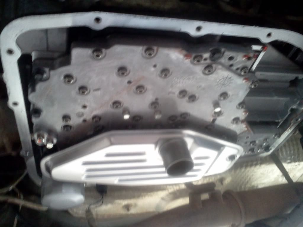

got trans fluid and filters changed
New filters in

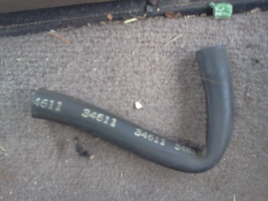

Ive had my jeep for about a year now and cruise control never did worked right, but finally fixed it yesterday, and it was way to easy, cant belive I didnt do it sooner. it was a kinked vacuum line behind passanger head light, and auto zone gave me the 4"x 5/16 hose for free. Works like new and took mabe 10min. Its the simple things like that that puts a smile on my face
Old line

It's kind of funky how they did some of the stuff under the hood in Jeeps. It's like the location of the washer fluid bottle in WJ's. I bet it's good to have cruise again.
There aren't bands to adjust on the trans for the 4.7, are there? It looks pretty good from the photos. Were there any metal shavings in the pan?

Yeah the 4.7s do have bands but I dont know how to adjust them, still shifts good and smooth so ill worry about it next time. Very little shavings/powder on the magnet in the pan so im happy!

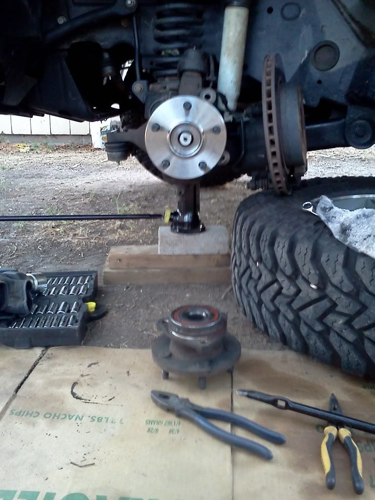

Got new fuel filter in yesterday, kinda pita but not to bad. Also put in a new driver hub bearing, that was real easy, mabe took 30min.
Most noise is gone, but still have some popping and gear whine noise in the front that I havnt figured out yet.

I see you make such things look so easy, and I'm envious. I'm not mechanically inclined, so everything I do on my Jeep seems monumental. lol Good job with the new hub bearing. I hope that by some miracle I can manage to be in Colorado, but I still doubt I could get up as far as you'll be. Be sure to keep us updated. I'd love to meet up if on the off chance I can make it up there.
