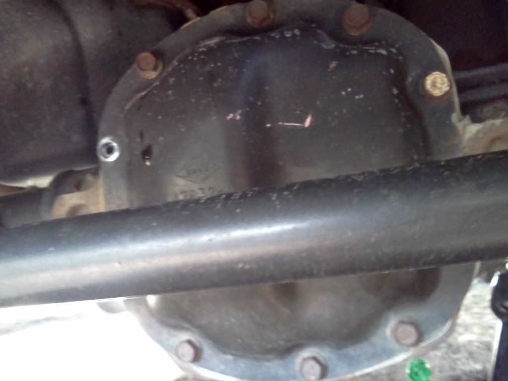

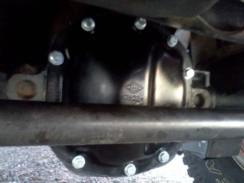

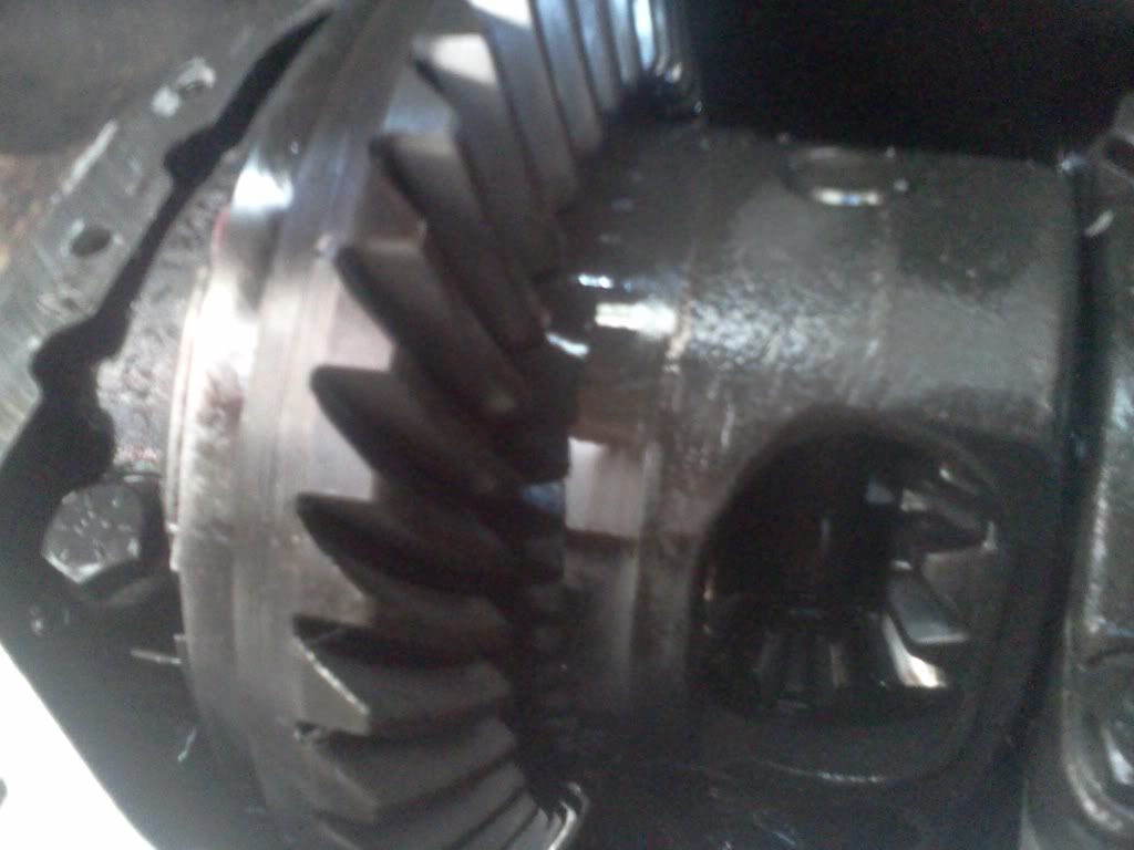

I changed out my front diff fluid today, painted diff cover and put some new shiny bolts in, prob be doing rear next weekend, just couldnt do the heat anymore today, as I had to work in it all week.
the start,
The insides,
All done,

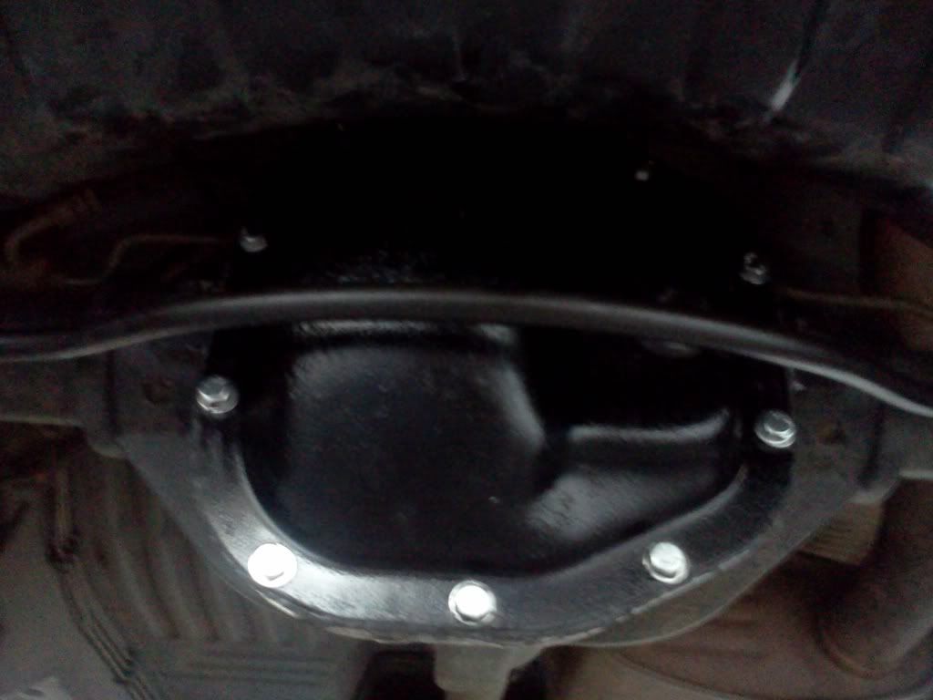

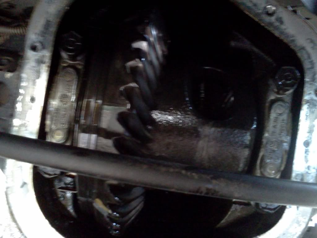

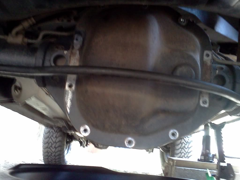

Got the rear diff fluid changed, not much else to put in my build thread at the moment.
Before
The inside, not as clean as the front, but got it pretty clean after the pic, all gears look good front and back, with very little metal shavings on the magnets, more like a powder ish shavings.
Its done! No leaks so far.

Did you remember to add the friction modifier? Looks good, and it's always nice to get the little things taken care of. These are the things that keep a Jeep going for years to come.

Yeah, I did remember the modifier, only used half the recomended amount, I used royal purple and it supposed to have some in it, I do have a bottle of the modifier im keeping in the jeep incase it starts making noise or acting funny. Thanks man! Im trying to get the basics done before my trip to colorado, need to change my motor mounts, trans and transfer fluids, then ill be ready.
Hopeing to be able to order a longarm lift and some sliders in the next 6 months or so. But till then it will be the simple stuff, it should help keep the jeep happy with me.

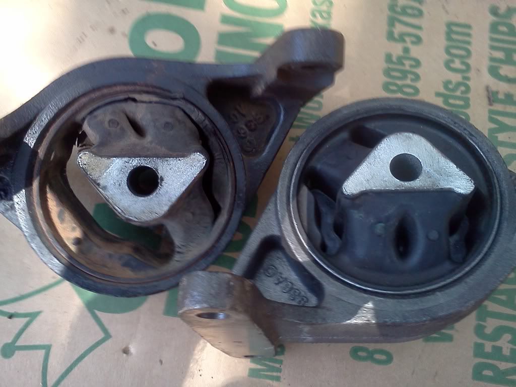

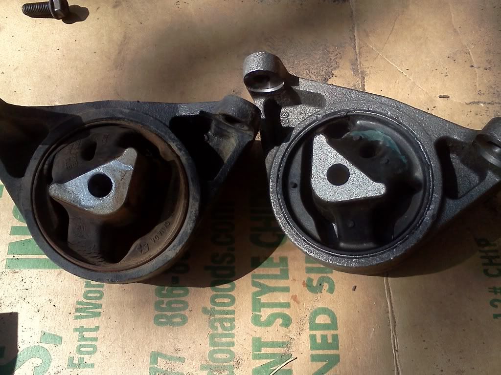

placed my order with kolak for some moog joints today and finally got my motor mounts installed today too
passenger side
Can you tell witch is the old one?lol
Cracked all the way through, needed to be changed awhile ago.
Driver, not as bad.

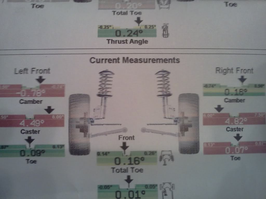

So I got all my ends put in saturday and got alingment done today, dont know if im happy with the result, would like some input from anyone who knows more about alingments.
Finished result
Seems to me the caster should be allot better than this.? And you cant adjust camber on a wj, right?
guys at the shop told me it is just fine the way it is. Not sure I like it. But I dont really know anything about alingment.
really could use a few thoughts on this. Thanks
