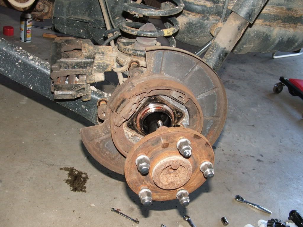

Up on jackstands with the tires removed
Brake hardware removed
