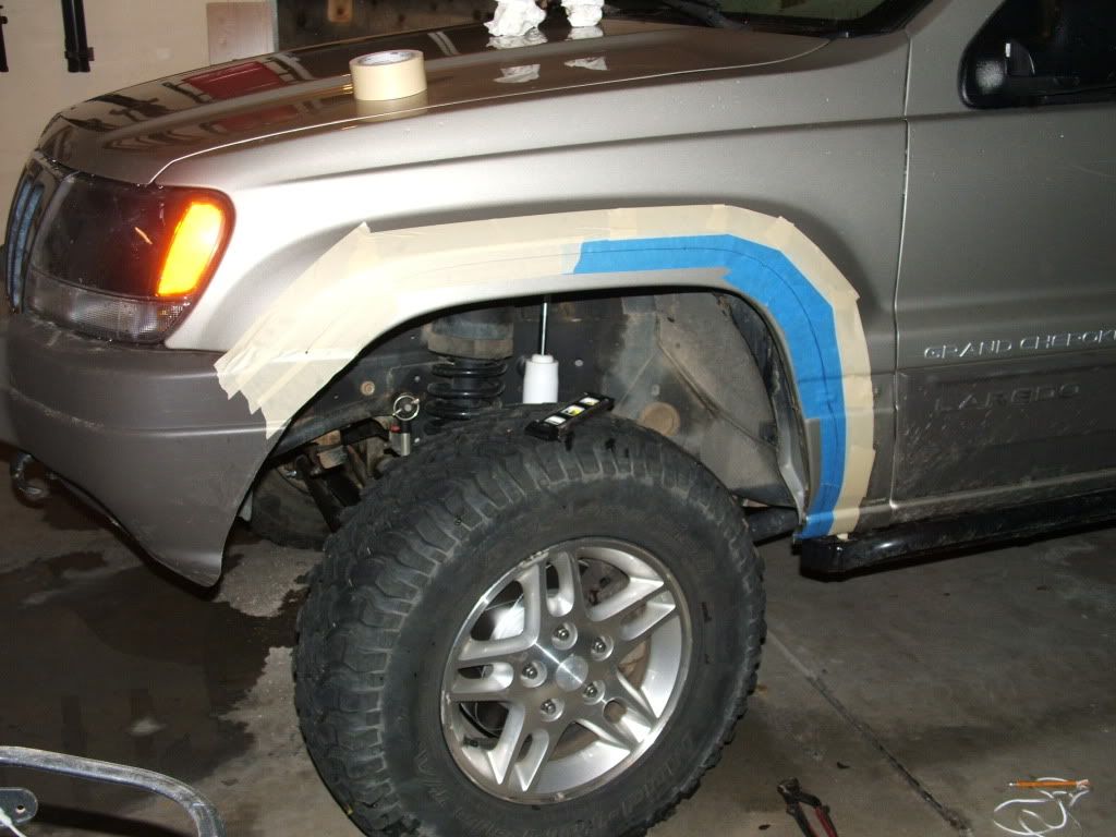

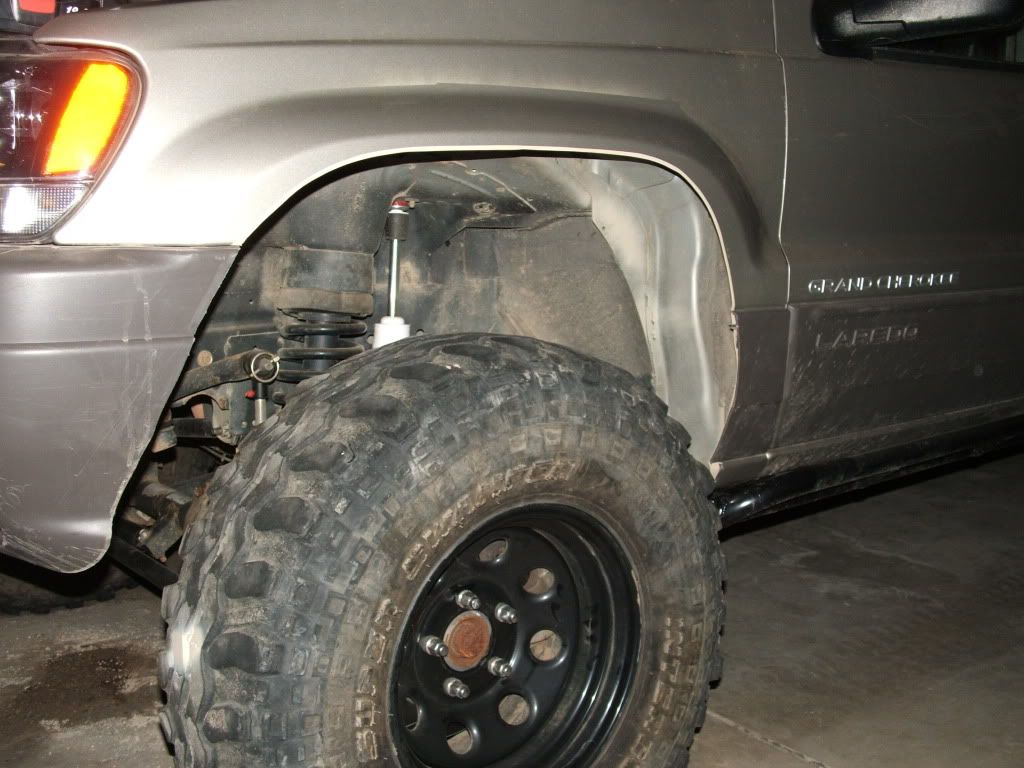

Performed a little surgery on the grand today. I am hoping this solves my clearance problems in the front
before
after

Looks good! What did you do on te edge? Are you gonna roll it or just leave it?

looks great! beat in the pinch weld thats a huge help as well

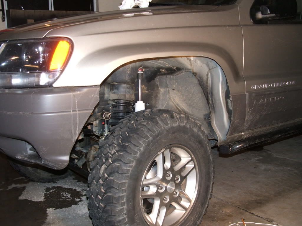

Just leave it for now. I am hoping to cover them with Iceland products in the spring.
I will take care of the pinch weld and spray some black undercoating in the wheel well sometime in the near future.
I started on the driver side fender and it came out really well. I used a jig-saw with a 32 tooth blade. The passenger side needed a lot of clean-up with the grinder after I left a serrated pattern across some of the fender, I guess the driver side was beginners luck?

Here is the driver's fender trimmed with a little tan bedliner and the swampers back on.

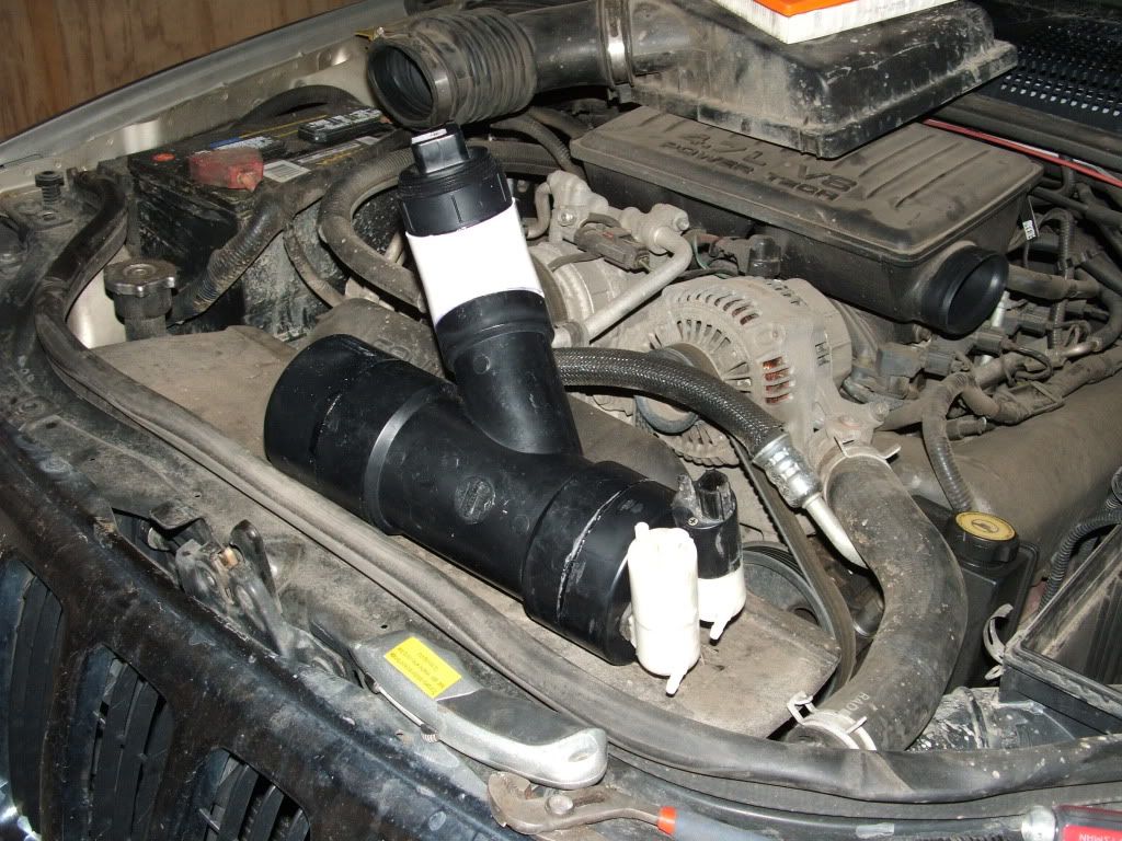

Since the snow started flying, I had to do something about a washer reservoir...
It is a little 'hillbilly' but should get me through the winter (and Moab later this week).

Where you putting that???

On the inner fender behind the airbox. My evap canister is in the rear bumper.
I ripped one of the grommets installing the pumps , so I need to find another to make it hold water.

Oh duh! I forgot yours is an 03.
