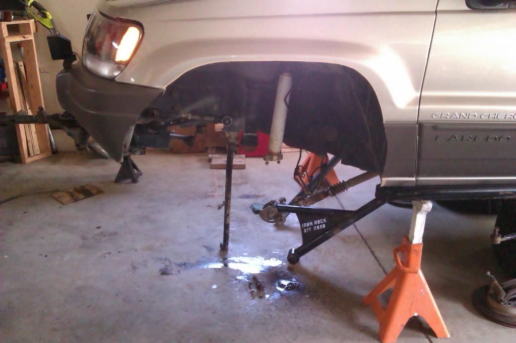

The swap has started.

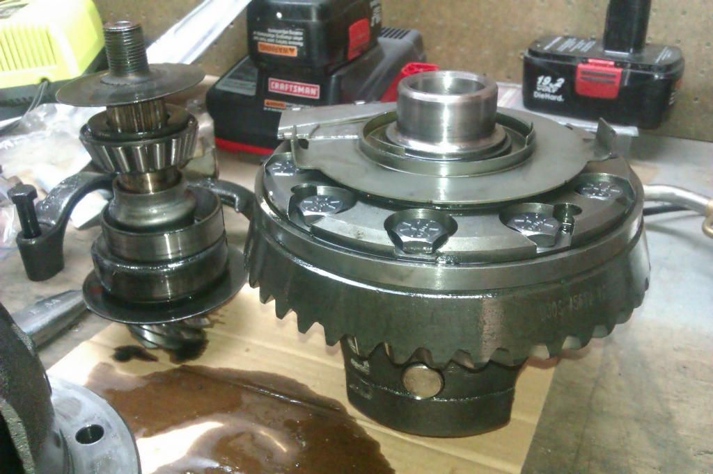

Swapped the 4.56 ring on the hydra-lok carrier tonight. One step closer to being back on the road!
