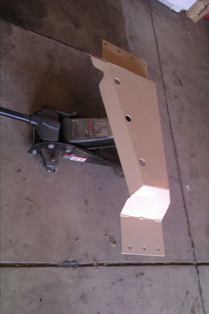

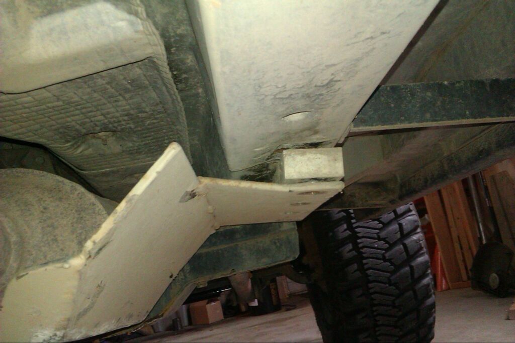

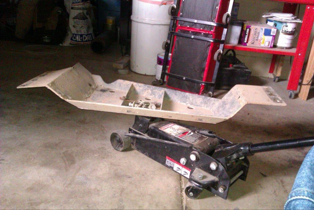

Here are the damages from rock chucker and what I am planning on doing to minimize it next time (besides moving a few large rocks).
Bent passenger side IRO skid
The unibody rail is slightly dented in from the interior edge of the 1"x2" aluminum I used as a spacer. I plan on reinforcing the rail with a 1/2" x 24" piece to match the rail width (held in place with the IRO skid bolts and one new additional location on each side) and a shorter 1/2"x4"x16" to mount the skid to for additional cat/tc clearance. The damage is a lot less than I expected to see when I pulled the skid.

Would a wider bar help too? Width of the "frame" rail?

If you read the text, it basically says the same thing in a few more words. My 'word smith' skills are pretty poor lately. One piece of 1/2x5 for support and a new piece of 1/2x4 to make up the remainder of the spacer needed.

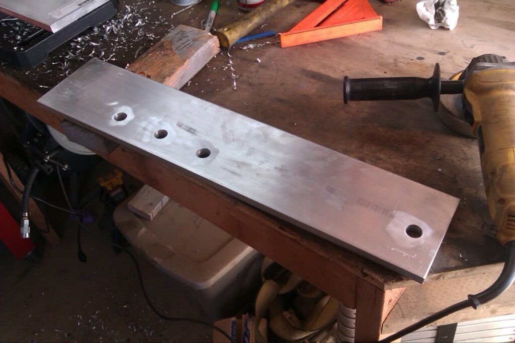

Straightened out the IRO skid as well as I could and gave it a fresh coat of tan bedliner.
The 0.5x5 aluminum bar is ready to go on to add a little extra support to the area the skid bolts to. Still waiting on a few remaining pieces before installing everything.

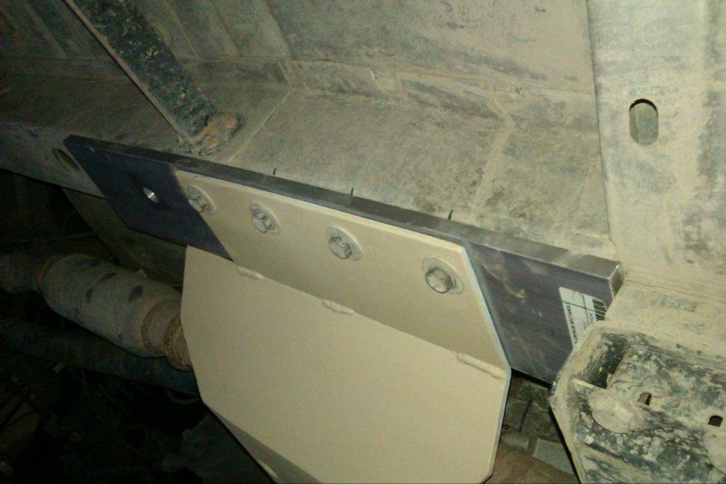

Reinstalled the skid and 0.5" spacer to check for clearance. The TC has plenty of clearance, but the CAT interferes a little. I am going to have an exhaust shop do a little work for me instead of adding another 0.5".

That looks solid, it should distribute the weight perfectly. If you bend the unibody with this, it might be time to plate the unibody
