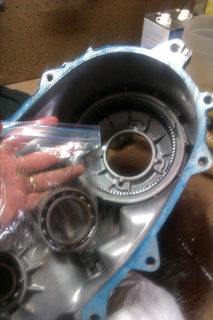

Found the culprit of the noise in my np242. The outer race of the input bearing is in the middle of a fatigue failure. I don't know if it is caused by miles or if it had been ran low on fluid at one time. Everything else looks good, so I am just going to rebearing the case.

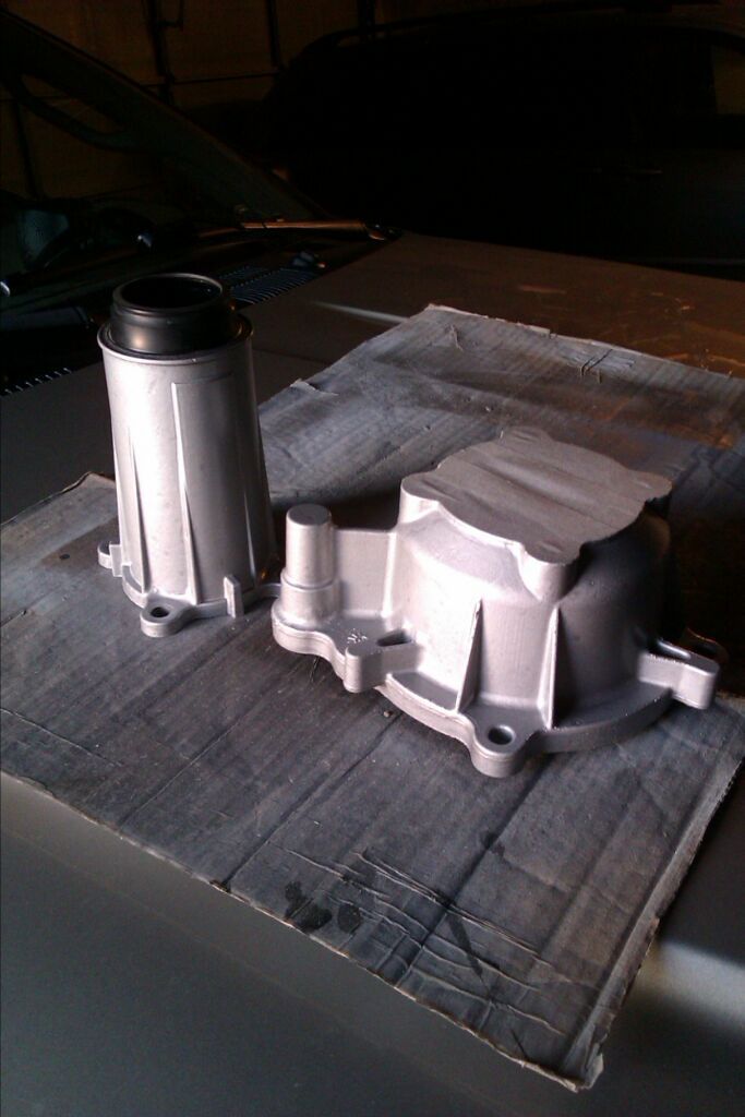

Just for fun I thought I would scrub the case in the parts washer and paint. It should look pretty when it's done.
The two case halves are soaking overnight.

Do you have a parts washer in your garage?
My parts washer was made by GE...but Emmy is starting to give me wierd looks when I run Jeep parts through the dish washer.
*Project Yeti* 99 JGC Limited 4.7 w/6.5" Rockkrawler LA & IRO A-arm, Goodyear MTR 35's on MB TKO's, 4.56 Yukon's, Iceland Offroad Bumper/Flares/Sliders, Protofab Rear Carrier, SuperChips, Uniden/Firestick, Flowmaster, Smittybilt 8k Synthetic Line Winch.
My Jeep is Organic - Undercoated in 100% all natural Utah Dirt --- Utah Jeep Crew #49 ~Will
2012 JeepForum GCOTY ---
85IrocZ-28 is offline
post #375 of 617 Old 05-13-2012, 08:09 AM Thread Starter
clgielin
2003 WJ
Location: Wayland
Posts: 1,328
I do have a parts washer. It's getting a lot of use now between the Jeep and Goldwing project. I thought about a small benchtop blast cabinet, but the big one at work is working out quite nicely.
