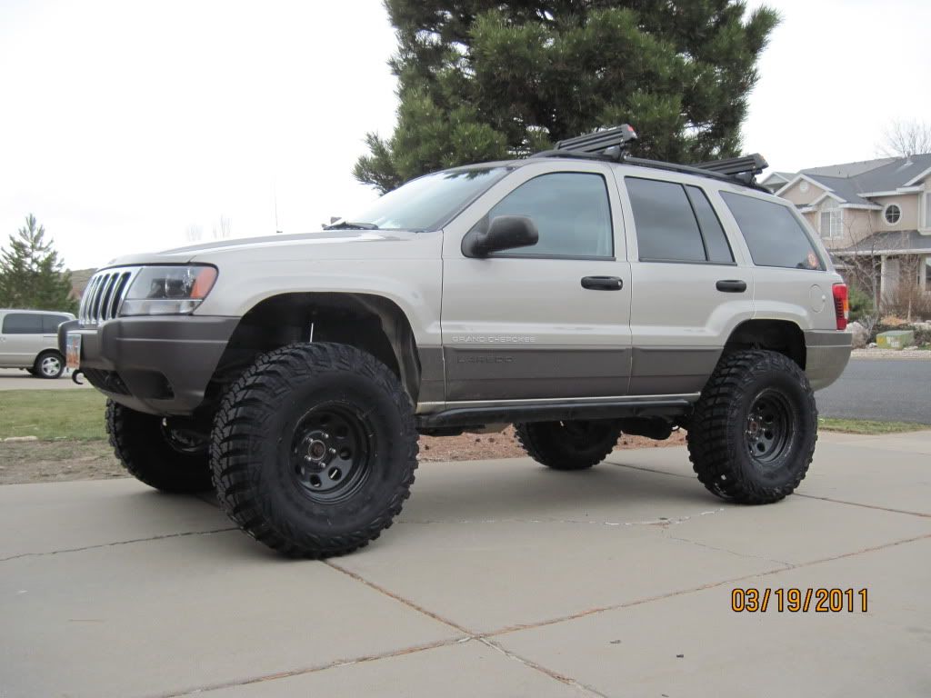

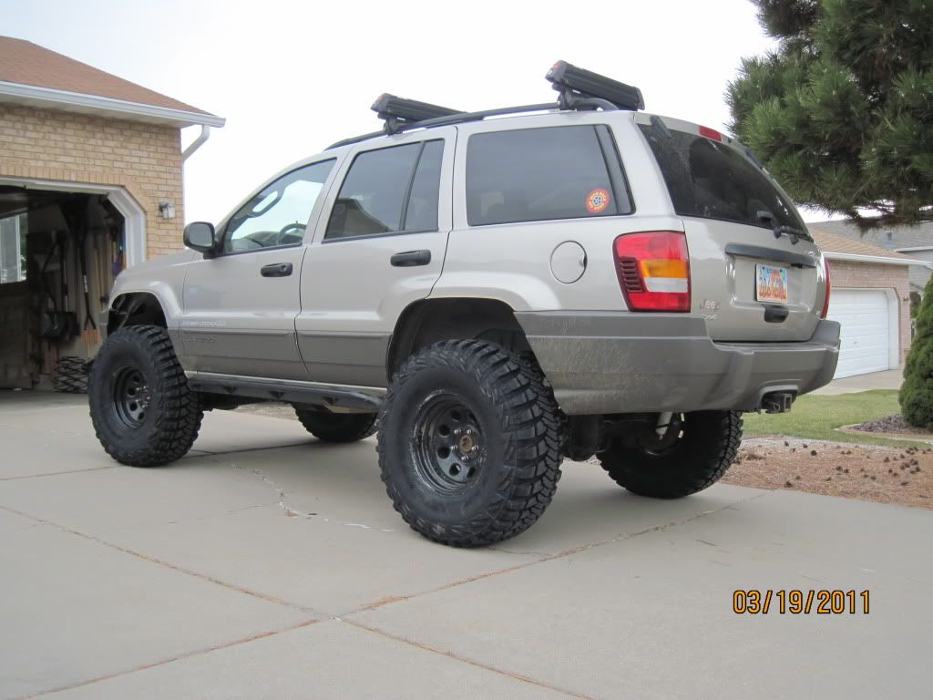

Close, but no cigar. Adjustable rear lower SA's and a set of BPE's. The wheelbase is now set just over 107".
And oh yeah, new tires.

Those are Nice looking treads! I had a set of MTR's on the Dub before the BFG AT's. The new tread pattern is growing on me, I was really happy with the life I got out of the older style MTR's.
Did Discount match the exact price online, or the online price + shipping? I need to pick up new tires for my car this week, and possibly the JK wheels I have as well. I always go to discount.

I had a set of the older MTR's on my YJ. I didn't have any complaints with them either. Discount basically looked up the price online and matched it. What made it as cheap as onlinetires.com was the $80 dollar Goodyear rebate that covered UT sales tax.

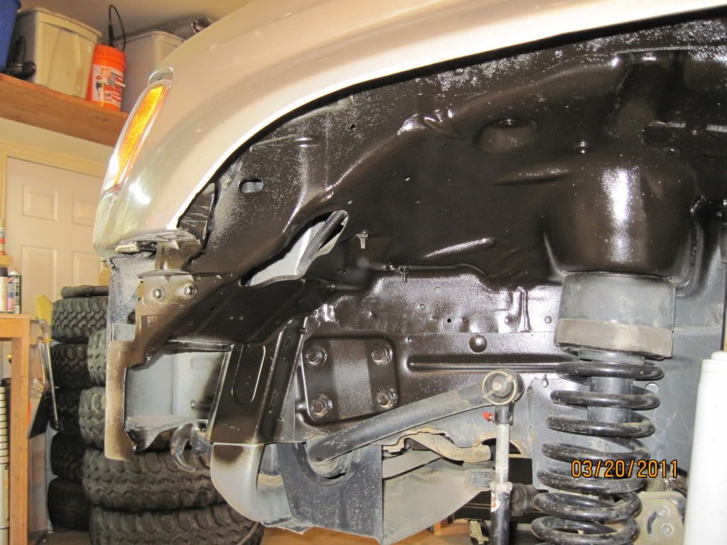

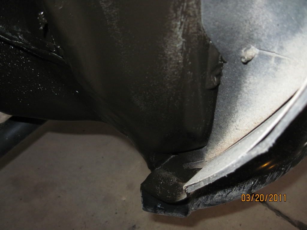

Moved the front axle forward another 1/2" and removed some extra sheet metal from inside the front wheelwells. A fresh coat of black undercoating to make it look more roomy than it actually is.
Enough room for now, but the front of the sliders may see some trimming in the future.

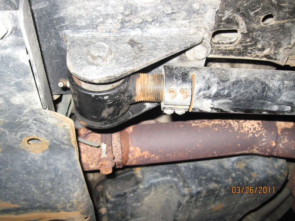

Chris, your rig looks great! How did you move the front axle forward?

IRO's newer front long arm set ups are adjustable.

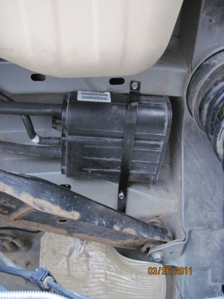

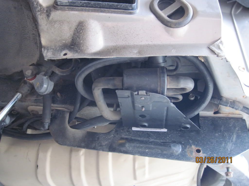

Here are the final pictures of the evap relocation. I am pretty happy with the results.

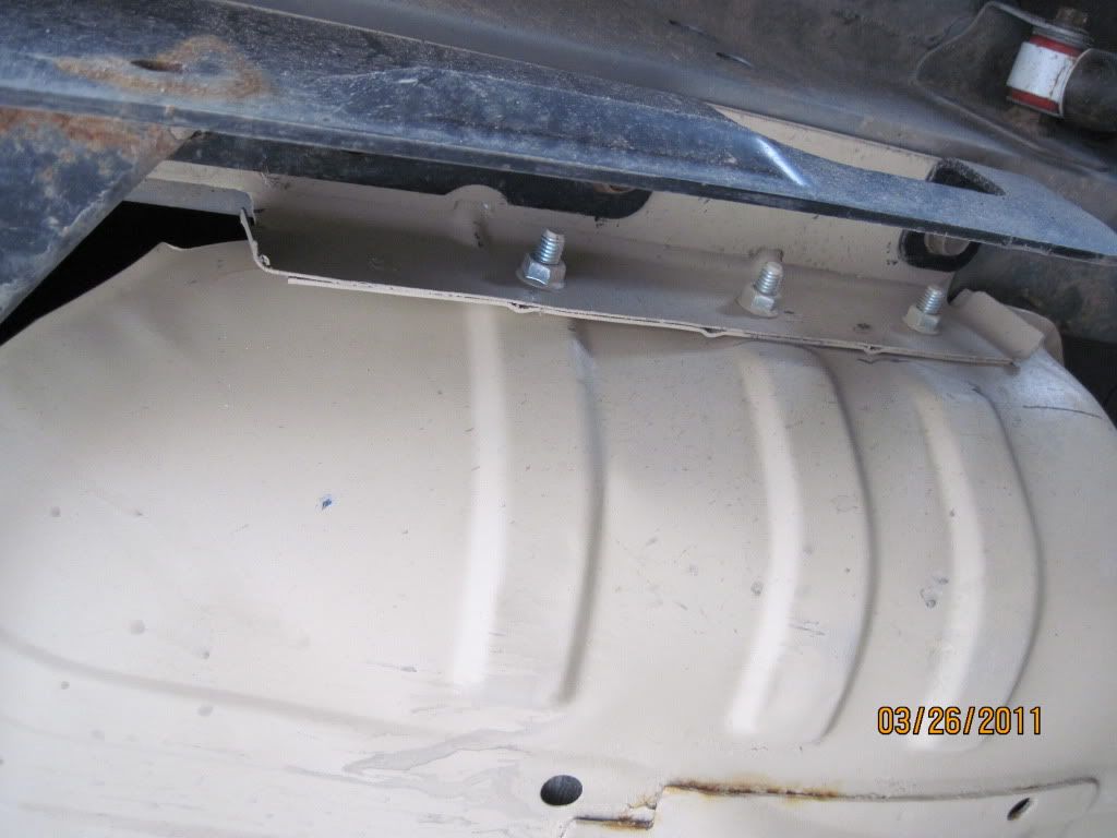

Nice! I am waiting to hear back from BadSyndicate, but may end up just doing this without his kit if he doesn't get back to me soon. How much welding did it take to peice the skid back together?

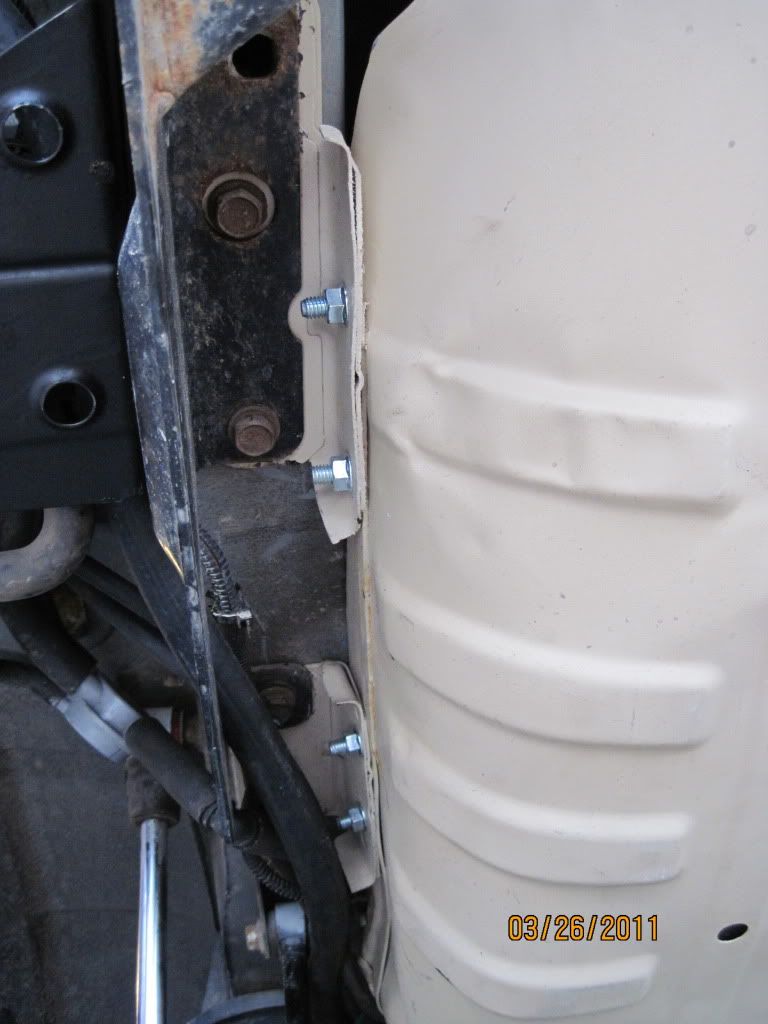

Will - Here are some pictures of the 3/8" bolts on the skidplate.

Matt - Here is a pic of IRO's non-jam nut style adjustable LA.
and my adjustable rear SA's

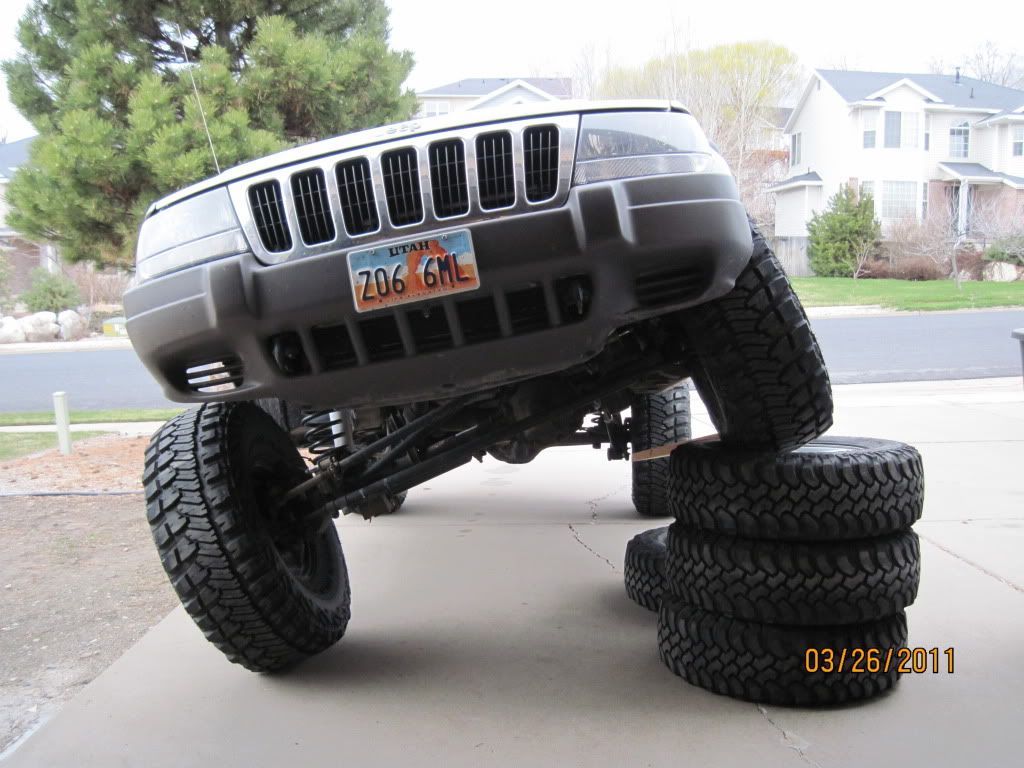

Took measurements for custom bumpstops today. Someone convince me to book a room for GSW this year.
