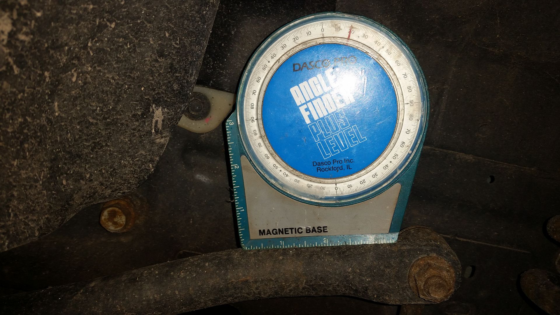

Small update - Recently I've felt the WJ had a little sway to it when cornering, almost as if it was tucking in to the turn. This was most noticeable at higher speeds when following a bend in the road. I had originally installed the Zone sway bar end links when I installed the OME HD lift. After a talking to billzcat1 a while back and finding that ideally, you want the sway bar to sit at 0, I decided I would switch back to the OEM end links.
Here's the angle I had with the Zone end links:
And here's one with the OEM links:
I realize the 'after' picture means nothing without a level on it. I will try to swap that picture out with a better one when I can get back into my garage (borrowed floor space)! Either way, perhaps I'm working with the placebo affect but I feel like it follows curves at higher speeds a bit better.
UPDATE 1/30/15: With stock end links in the front, my sway bar is at about 20.

I had read that Billz had mentioned the same thing, keeping the stock sway links in the front was perfectly acceptable. So, no reason to replace mine now. They were on the list prior too. But, like he had said, keeping them closer to 0 degrees is the optimal angle.
