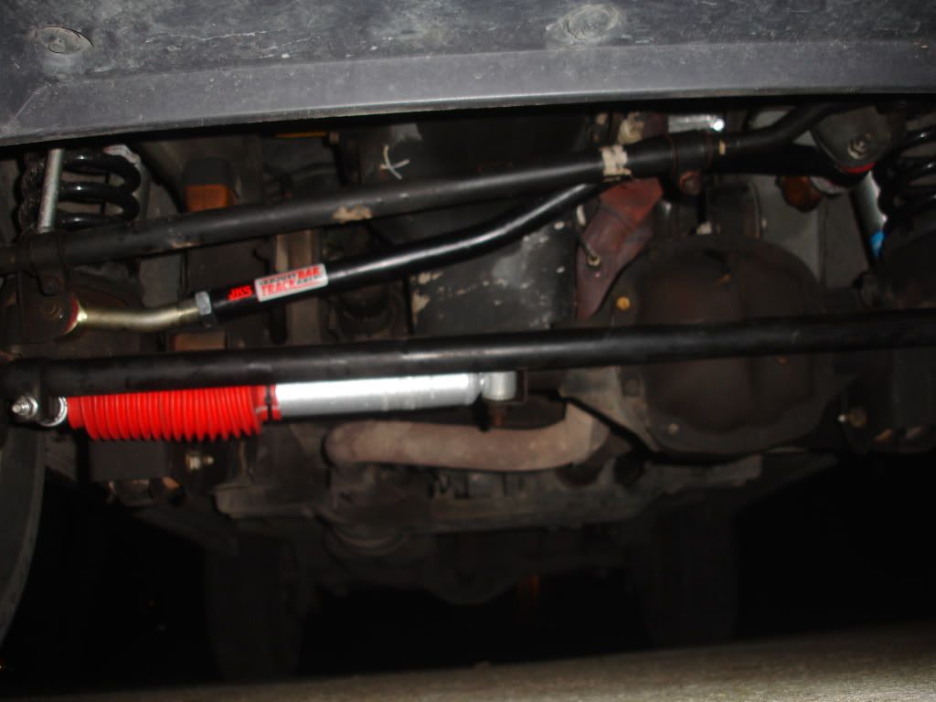

Yeah I think I'll be happy with 245/75R16 on this lift. 265/75 just looked so big next to my lifted WJ. I'll definitely post some pictures and final measurements this weekend.
Also, I flipped the track bar into the proper orientation and put the shock boot on the steering stabilizer:

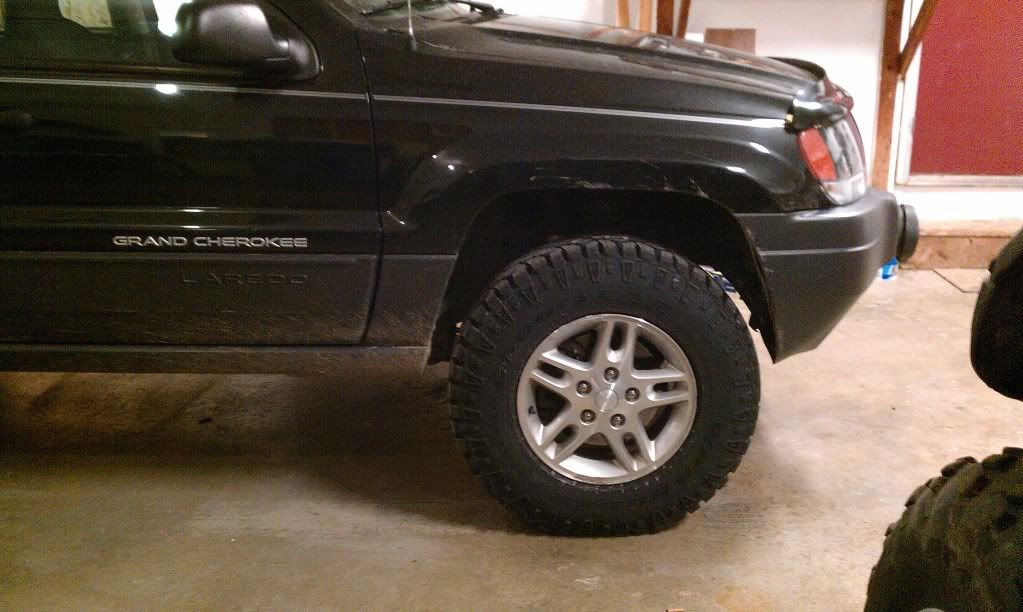

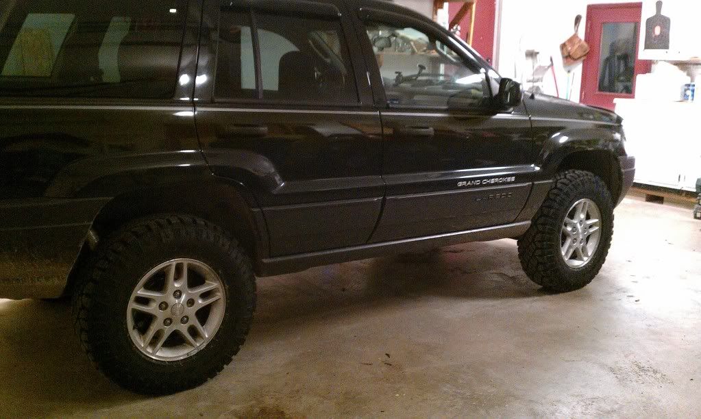

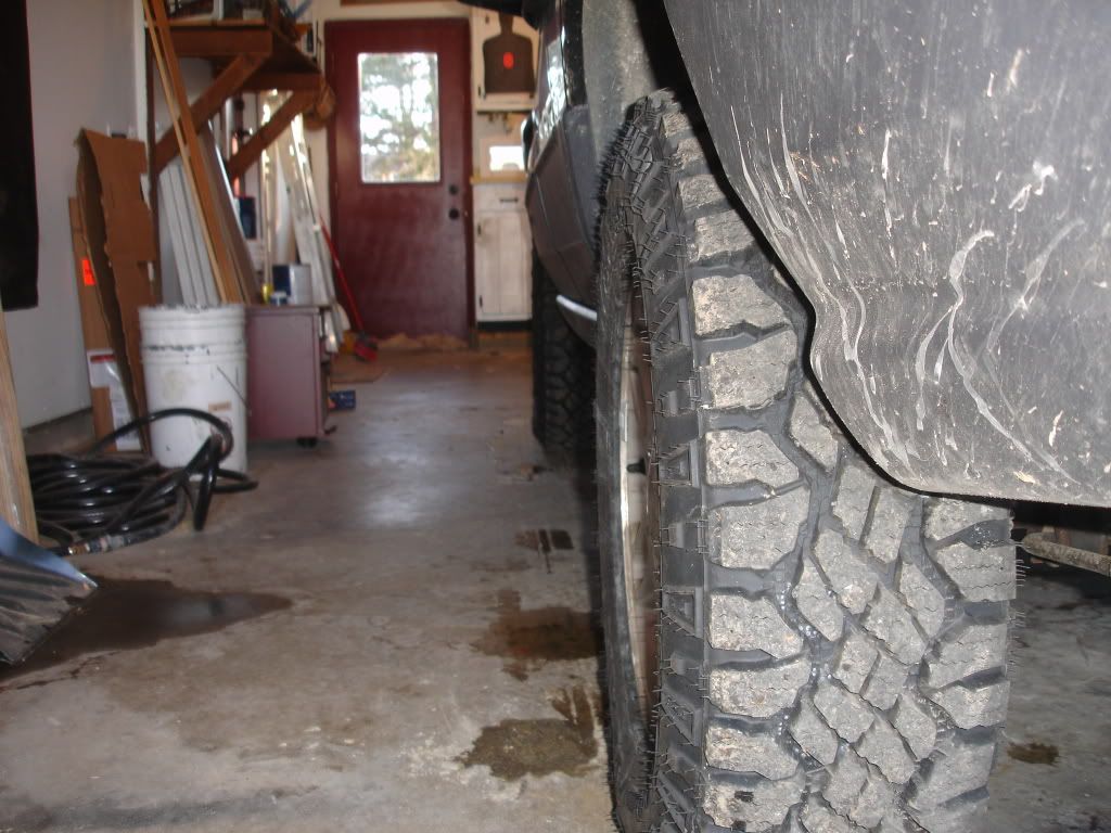

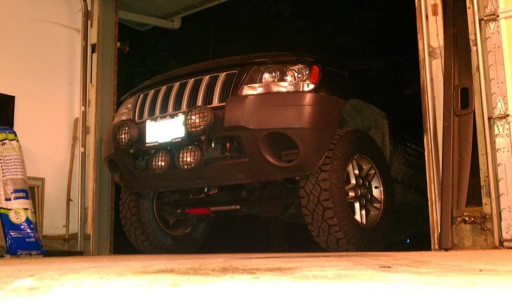

My tires are on! Here are a couple crappy cell phone pics. I'll get better pictures up soon.
And a couple shots seeing what they can do (sway bar still connected). The fiance was not very happy when she saw this...

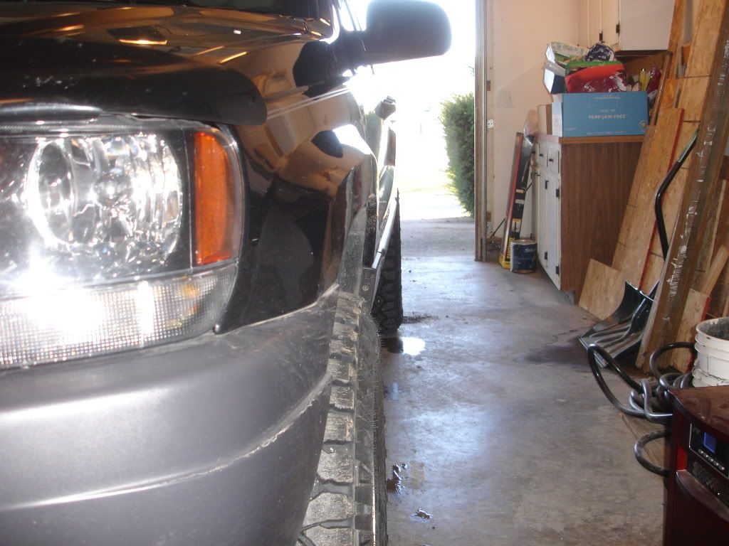

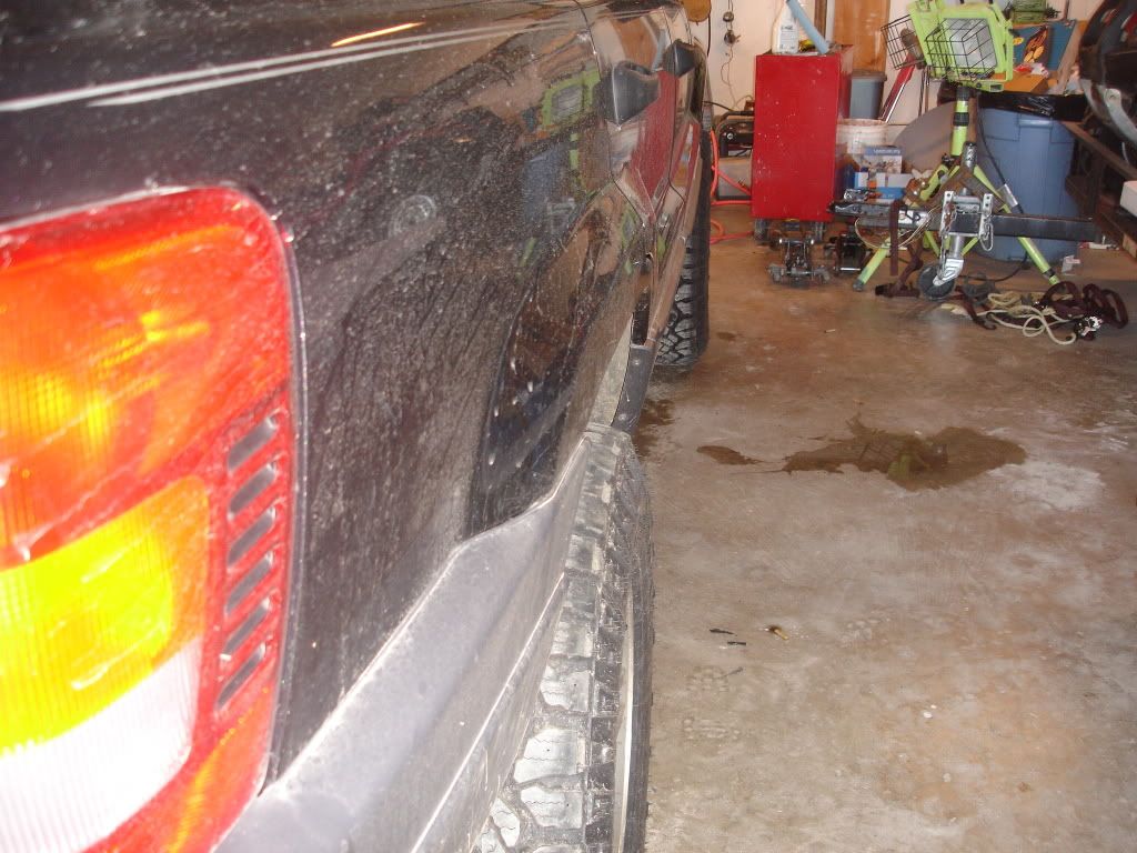

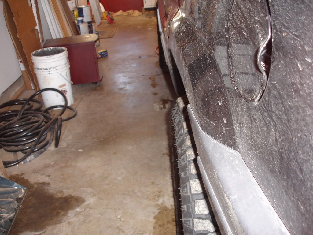

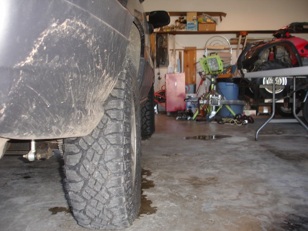

Wheel Spacers
I installed my wheel spacers this past weekend. I used the rough country 1.5" spacers.
(Before/After):

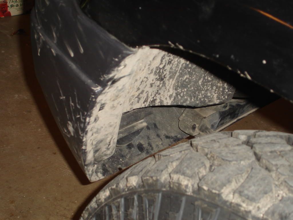

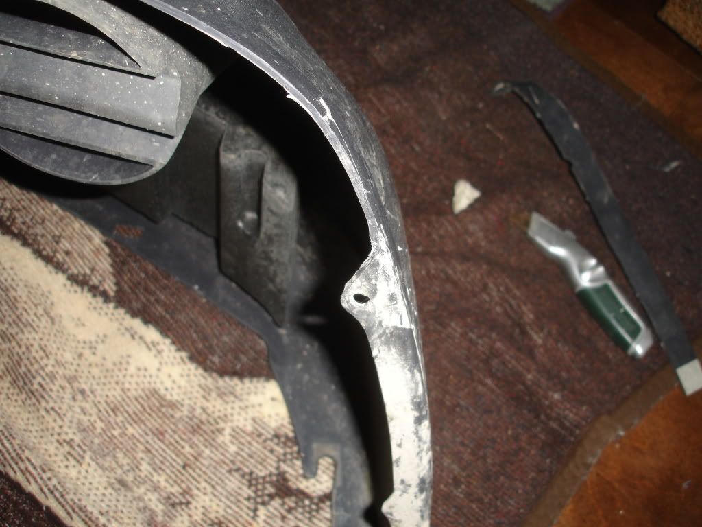

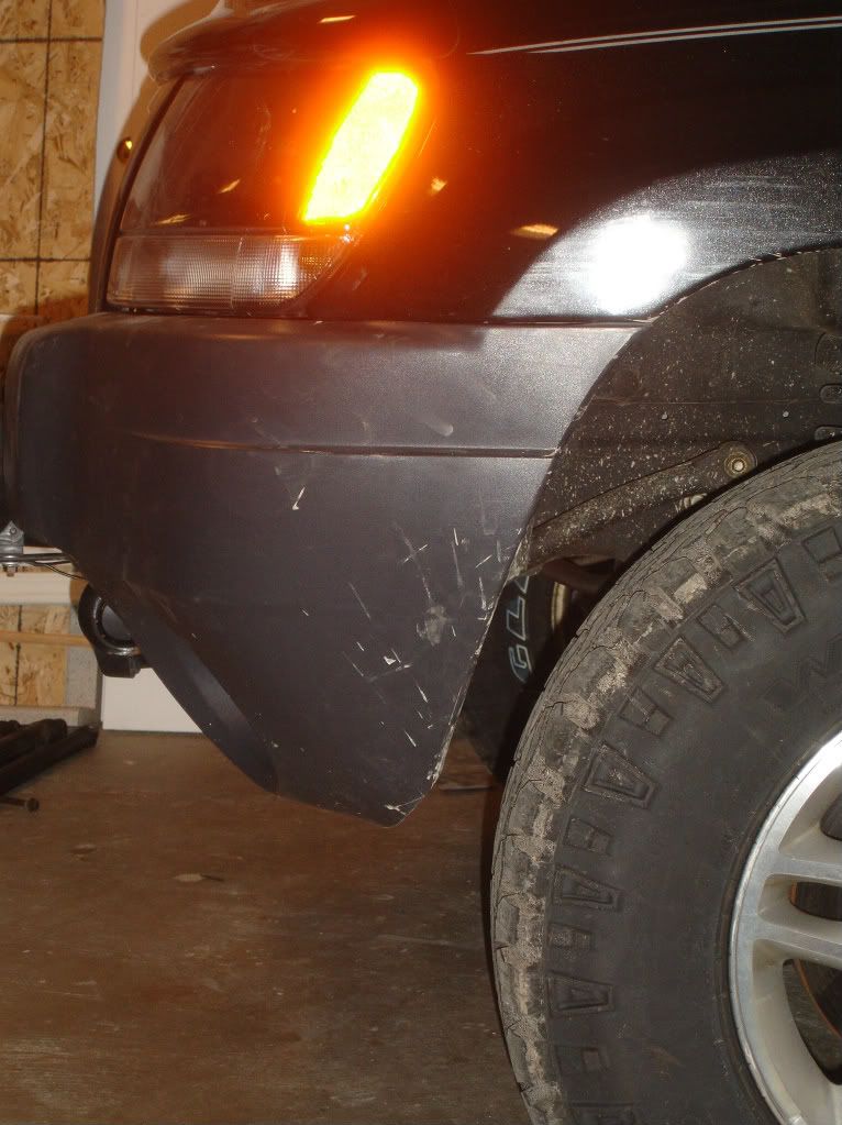

Originally, I did not have any rubbing with the OME HD lift and 245/75R16 Duratracs. Once I installed the wheel spacers, I had rubbing in the front at full lock in reverse. I trimmed the front bumper and wheel well lining to fix the issue. I used a razor blade on the bumper to remove about an inch of material. I used metal sheers on the wheel well lining. I think it turned out pretty good.

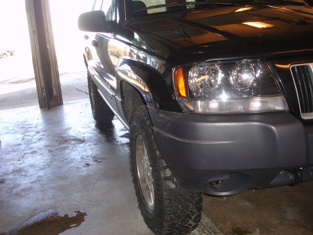

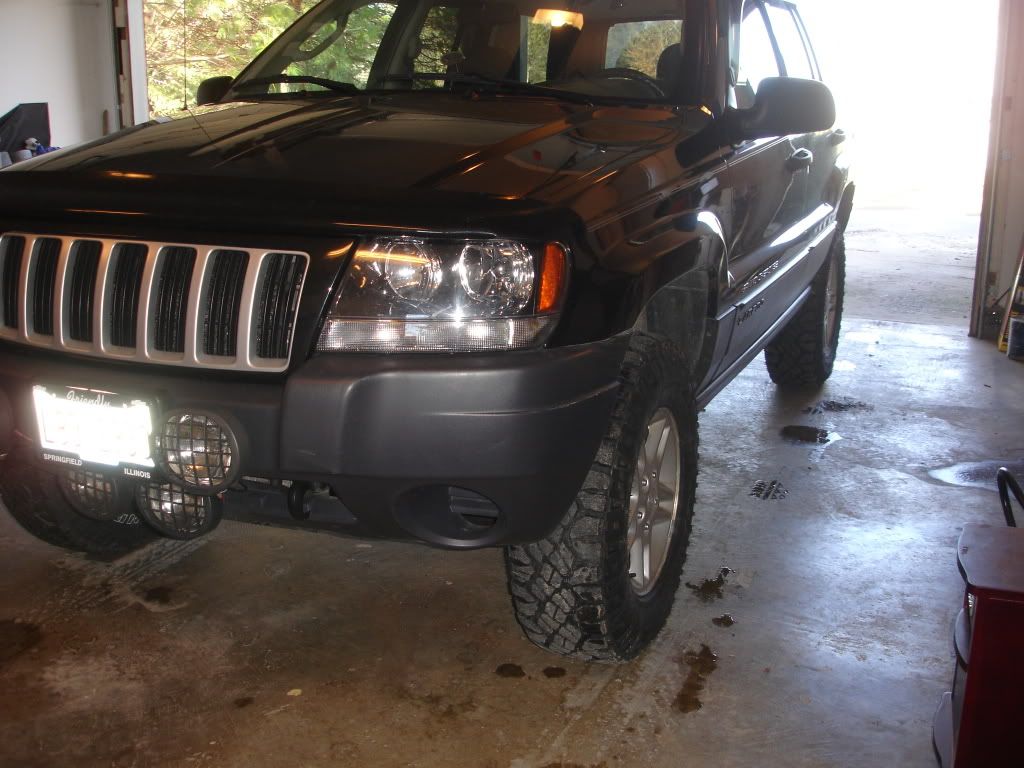

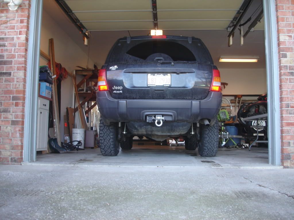

I realized I didn't have a decent picture up of the finished product so I snapped one this morning. It isn't the greatest quality but it does show pretty well the difference between sagging stock springs and the new setup.
Before:
After:
