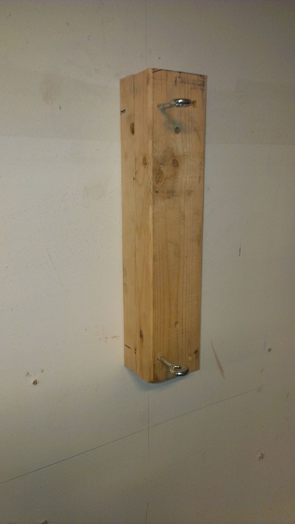

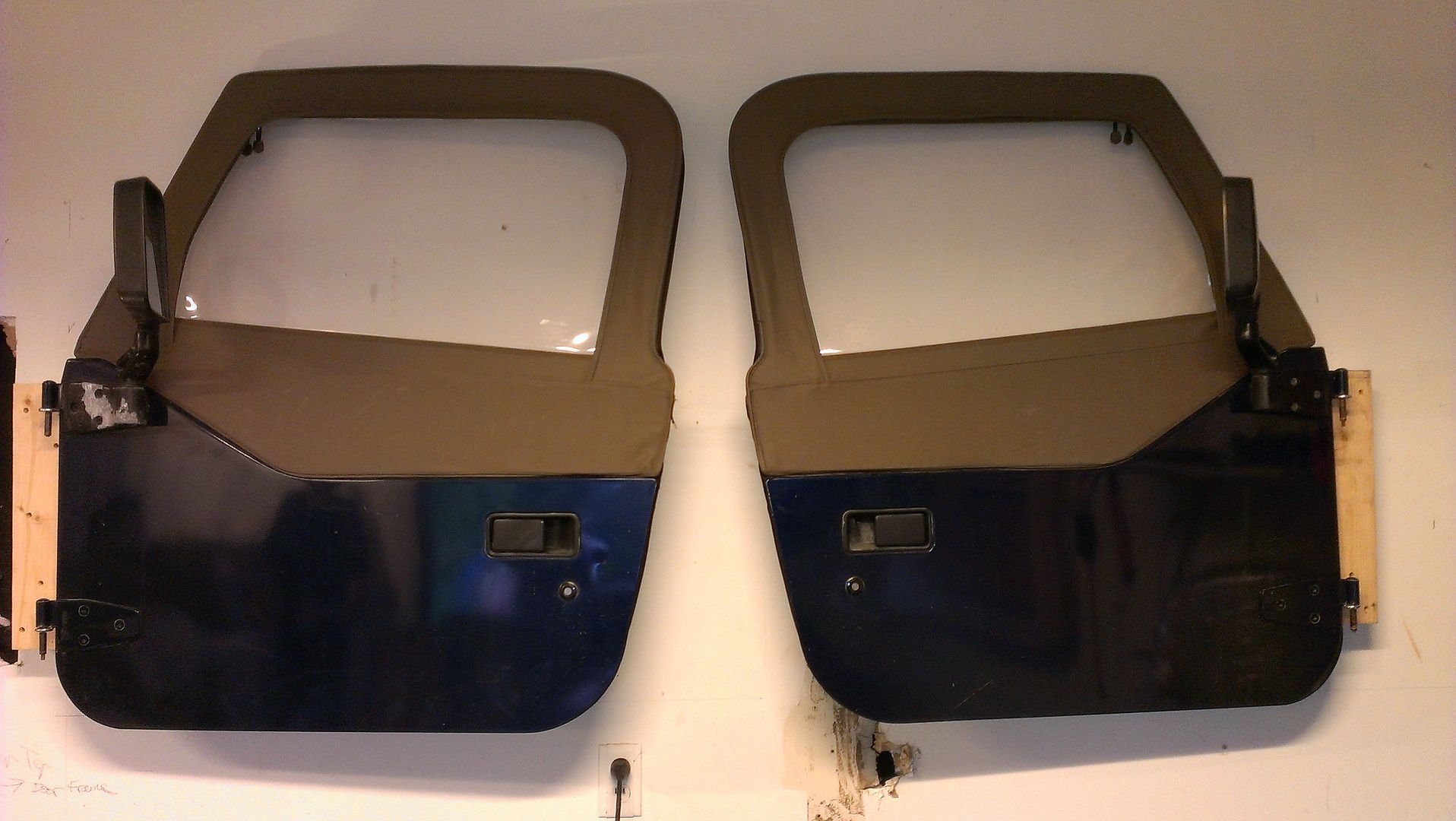

Small little project this past weekend - while it isn't WJ related, perhaps someone with a TJ browsing through my thread may appreciate this.
The problem I had is every time I remove the doors on the TJ, I end up setting them on the floor. I don't prefer this because I'm afraid they'll either get knocked over or end up in the way. If they're not on the floor, they end up on the garage futon. Clearly, that can't happen!
Solution: Hang them on the wall.
I bought some 1/4" x 3-3/4" eye bolts with a center hole large enough to accept the door stud. I then attached a couple scrap 2x4 to the wall and threaded the eye bolts into the 2x4. This is necessary because the eye bolts aren't long enough mounted only into the wall to allow the doors to swing flat against said wall. End result, no doors on the floor to knock over!

can you mount a hoop on the wall? so the doors stay against the wall. so it would act as a door latch. some sort of small u bolt should do with some 2x4

That would work! The way mine worked out, they stay against the wall quite well. With that said, adding something to allow the door to latch to the wall would reduce the amount of weight on the eye bolts. Nice thinking!

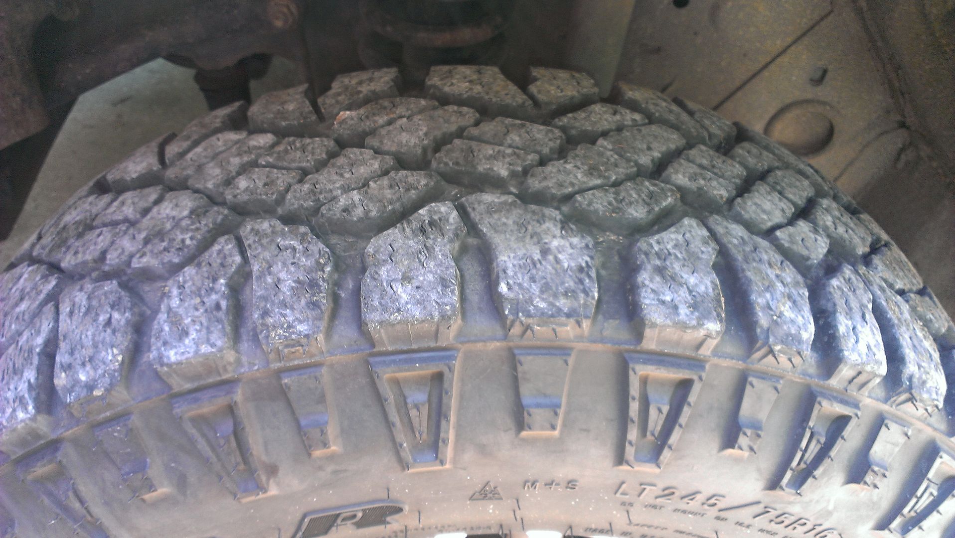

Per tread wear on DuraTrac 245/75R16 C tires:
I mounted these tires right at about a year and a half ago and have put a little over 20,000 miles on them, rotated every 5-7k. Most has been city driving with a little highway and a little off road. They've seen all types of driving conditions and have performed wonderfully in everything.
They come with a tread depth of 18/32". After this long, mine are currently sitting at 13/32". That's 5/32" of wear in 1.5 years/20k miles. Not to bad!
Here's how they currently look:
