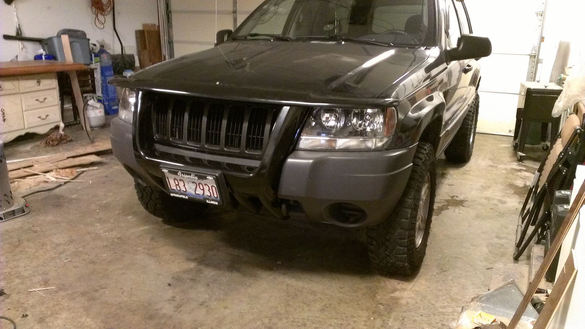

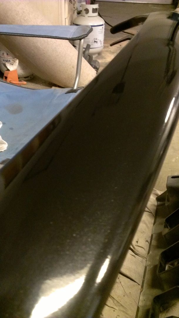

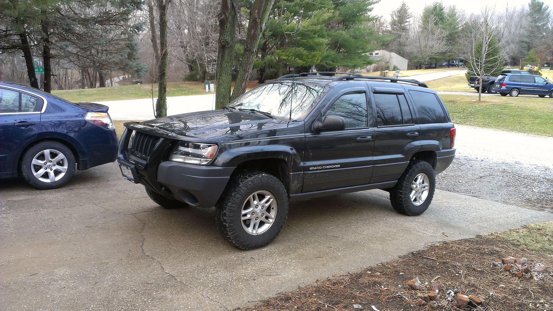

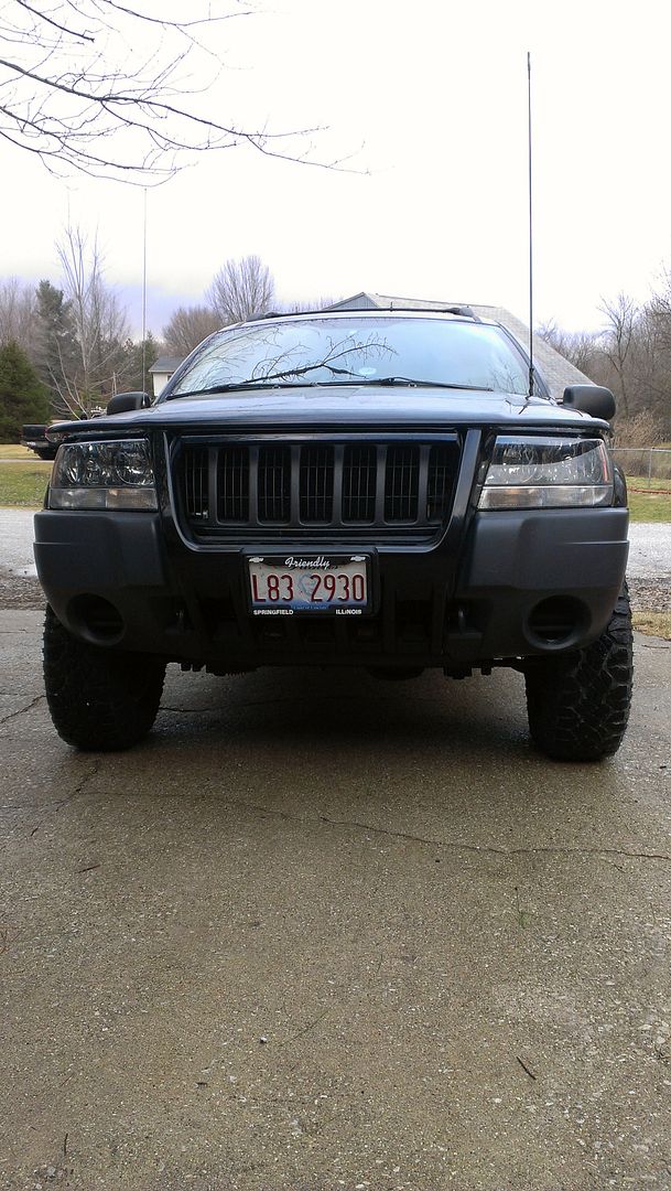

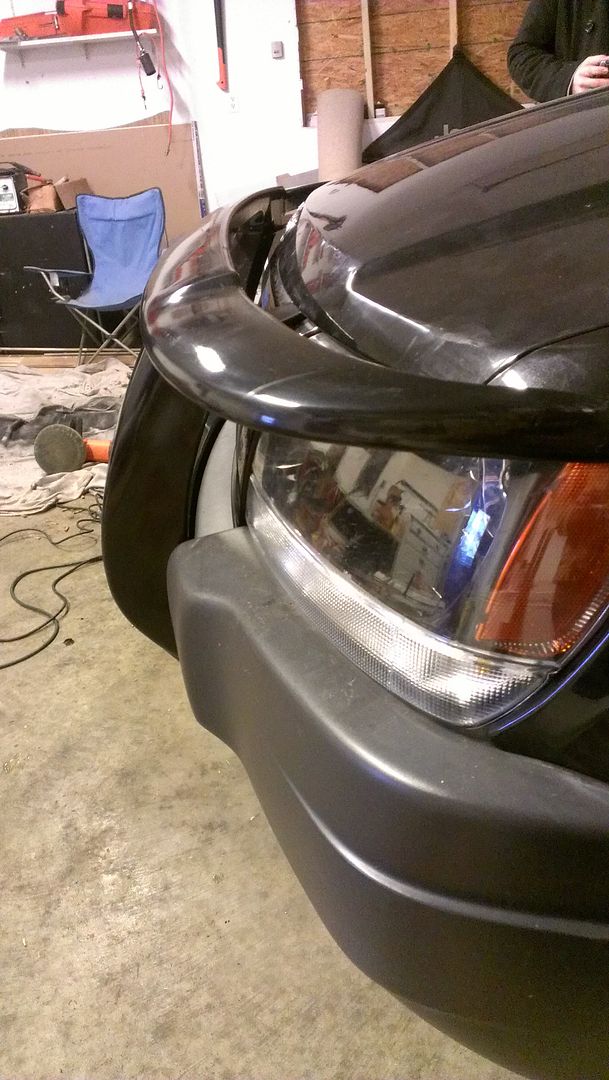

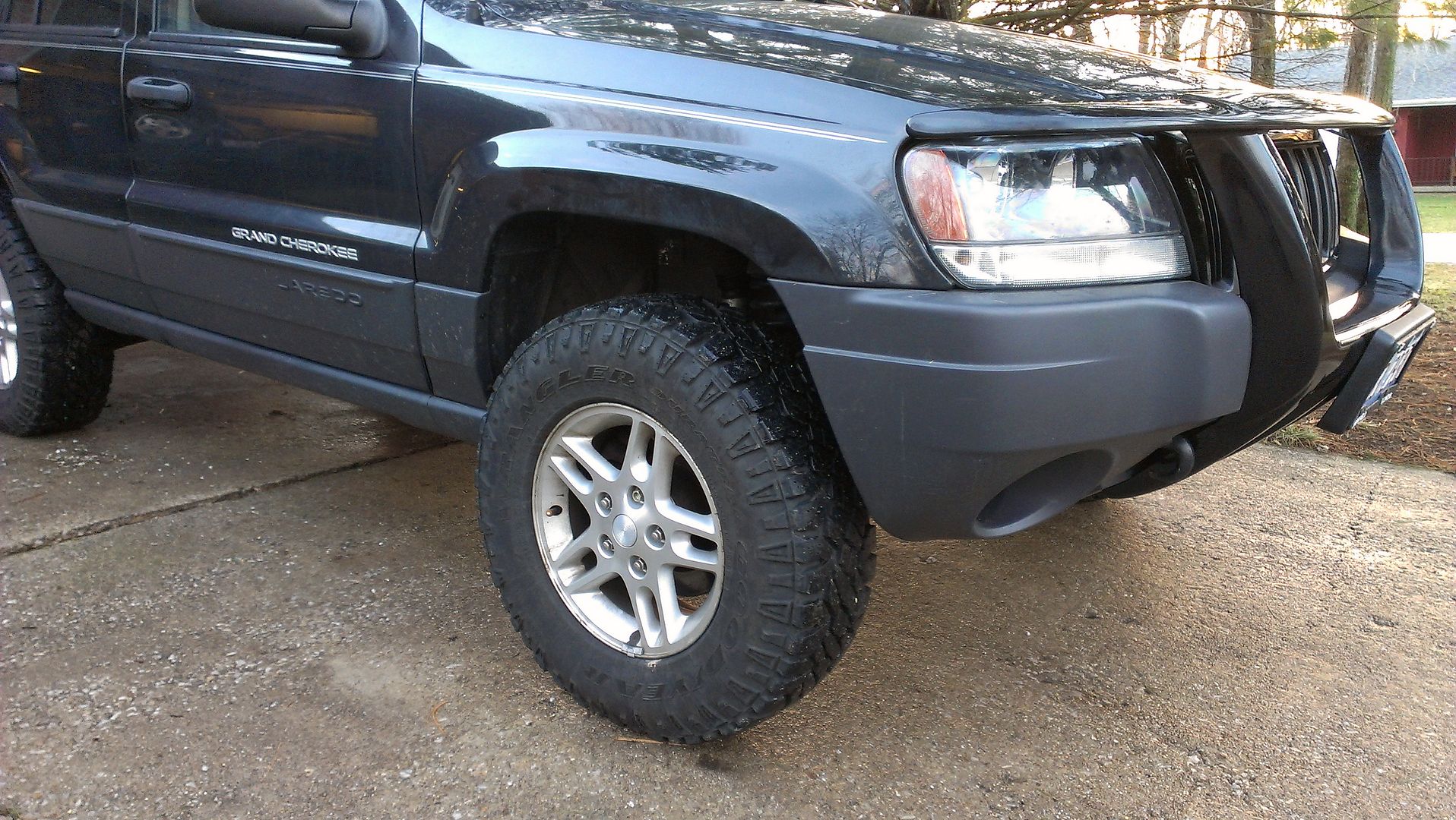

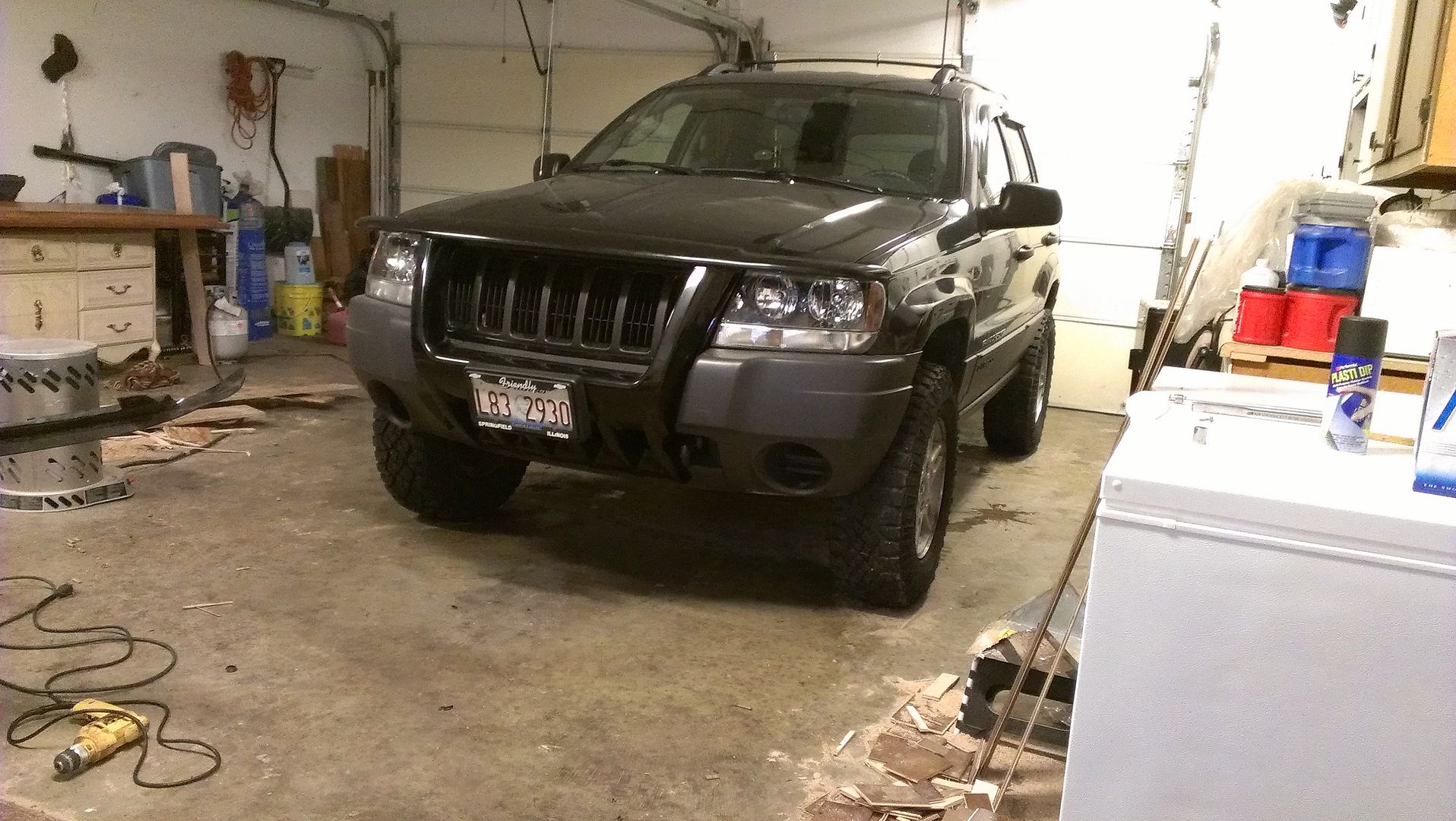

The OEM Brush Guard is finished and mounted! Here's a write up I did for painting/mounting it: OEM Brush Guard - Painting and Mounting (Pic Heavy).
Here are a few pictures - I blacked out my grill while I was getting the brush guard ready yesterday as well. I kind of like it.
The finish after buffing:
You can see it sits off the hood a bit:
~Chris

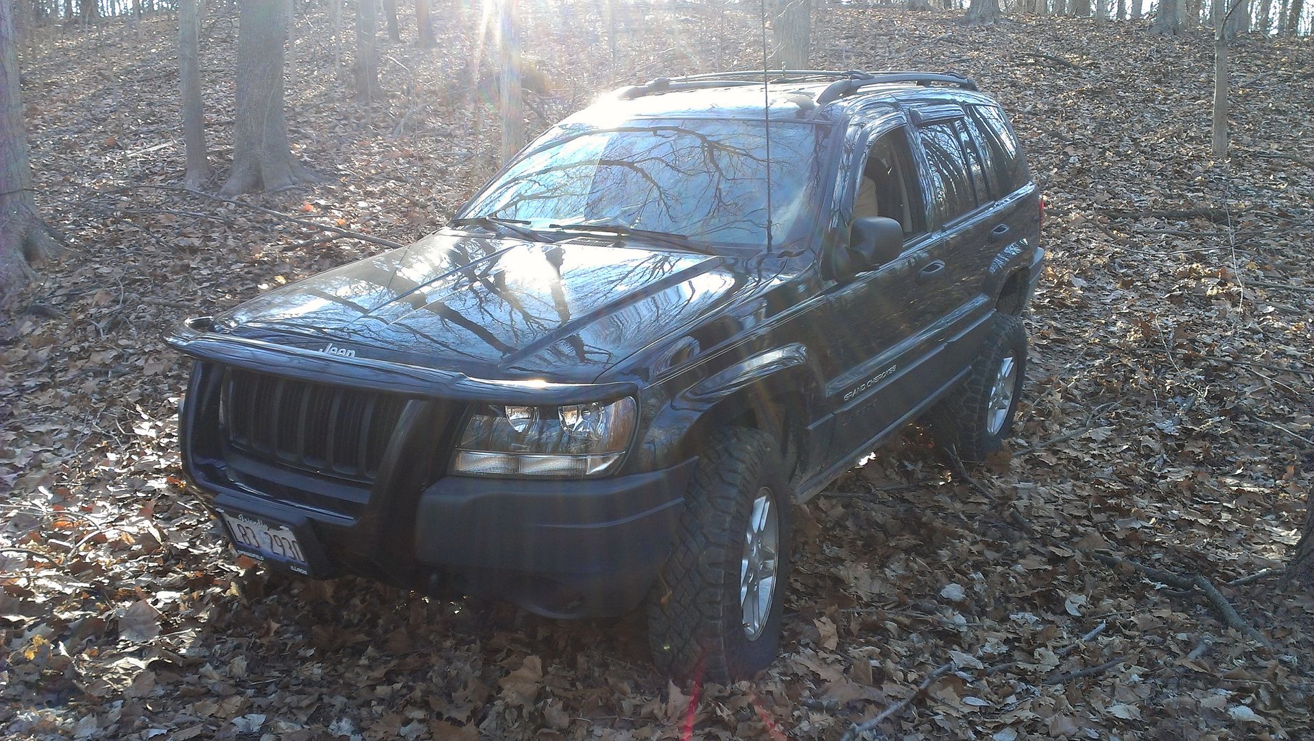

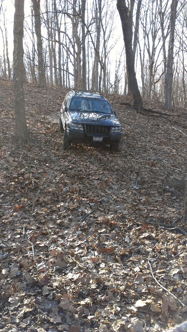

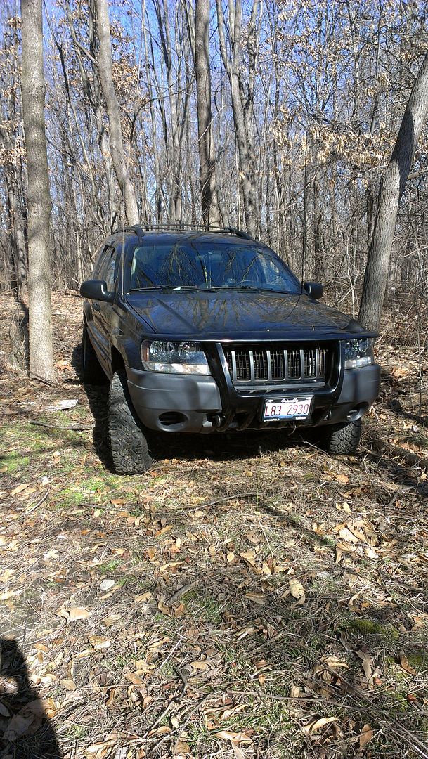

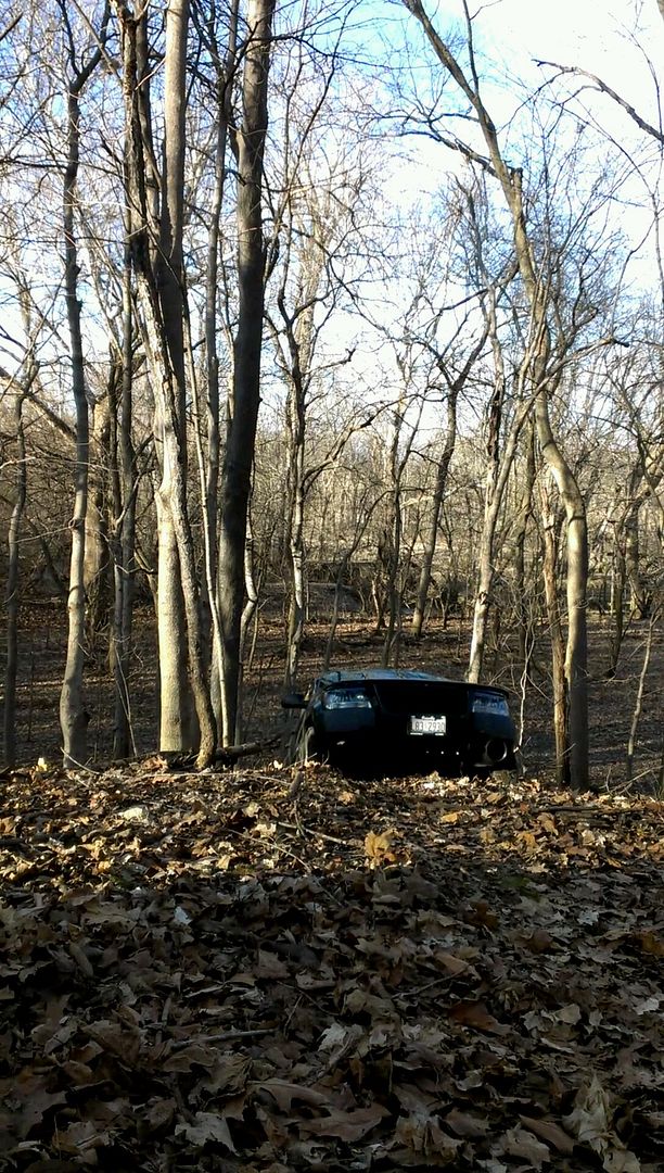

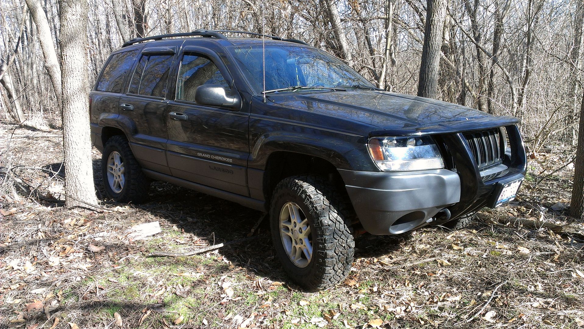

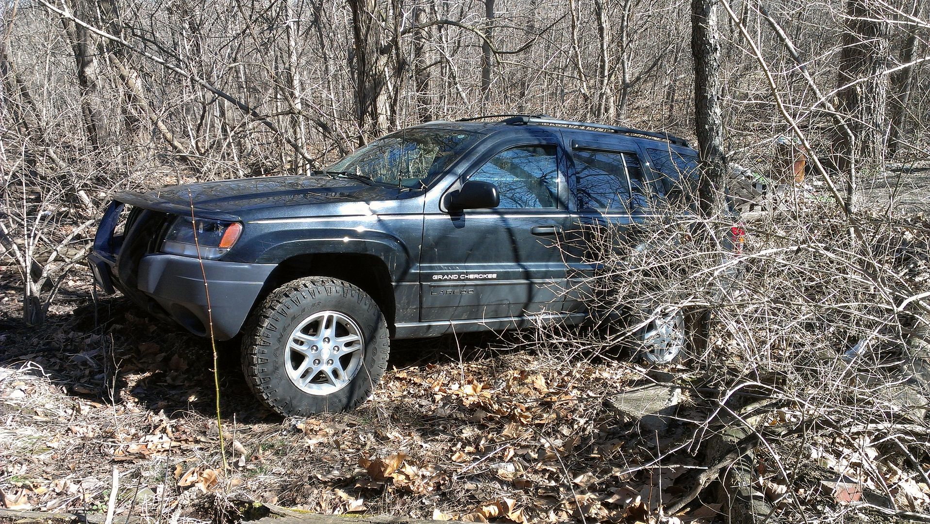

The Timber
I had a bunch of work to do on my Mom's Isuzu Trooper this past weekend which meant I needed to run errands Saturday morning. One of these errands took me to the parent's house to get some gear oil. Being that my younger brother was in town visiting and therefore riding along, I decided to drive into the timber just a ways for a couple minutes. I was surprised I was able make it as far in as I did considering the timber is quite thick with trees and brush.
I crawled my way through a bunch of crap and popped back out. I had an itch to go a little further before continuing our errands.
I had to back down at this point. There was a massive log blocking the way that I couldn't make it over. Mind you, I was still connected and aired up. I also found a large piece of junk concrete with my control arm bracket in the above pictures.
Well naturally, the taste of wheeling was enough to speed up the work on the Trooper. After changing a few fluids, my two brothers and I loaded up in the WJ with some chainsaws and axes and headed back to make some paths. I aired down to about 11-12 psi and we headed in. Once we fought our way through the initial thicket of brush/trees, the timber opened up quite a bit.
In the above pictures, I was leading the way with the chainsaw, my younger brother was driving the WJ, and my twin brother is seen holding one of my Fiskar axes (I love those things!).
We made pretty good progress for an initial path through. There's a nice hill climb that will get your wheels spinning if you don't have enough momentum. Here's me popping up at the top:

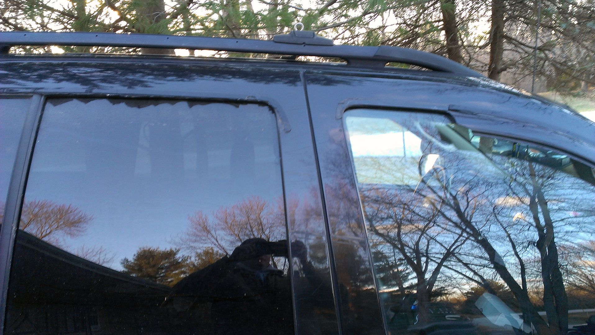

I didn't get any major damage - just some slight trail rash and smashed up window visor things (got a little too close to a tree ):
