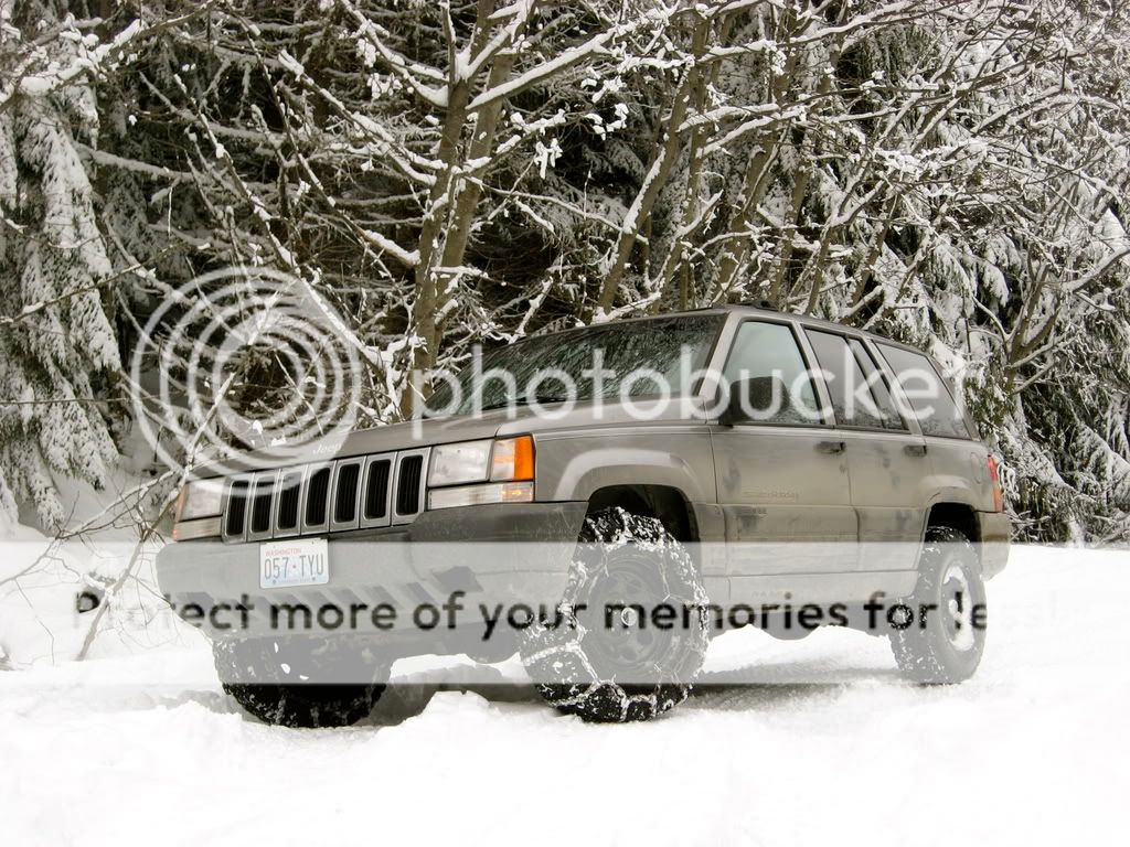

I run 30x9.5s on my ZJ and have a full set of chains for it. You can run chains in whatever 4x4 setting you want.

Found one with chains on all four,
my build/wheelin/picture thread
