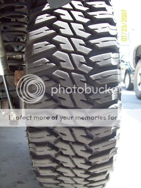

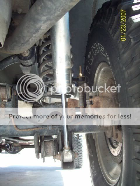

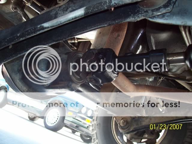

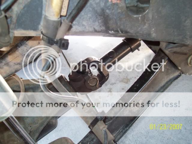

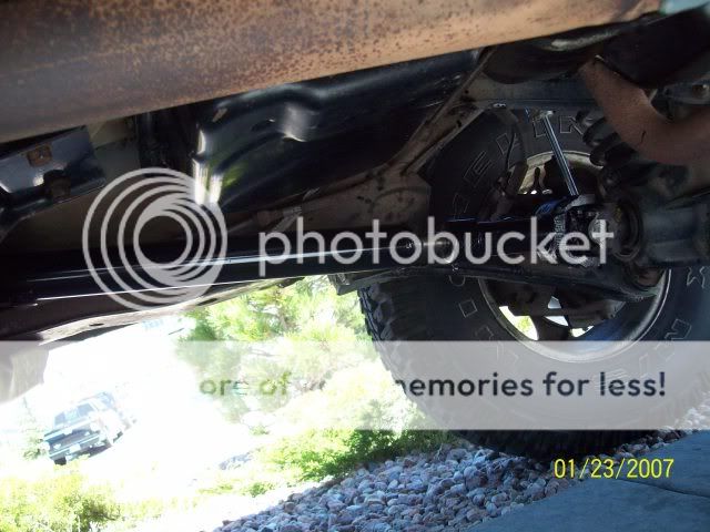

Did an oil change, took off shock boots, replaces crappy rezeppa front drive shaft with an OEM ZJ U-Joint DS.
Also threw in a few random pics, tires and no boots. And a picture of my tucked exhaust.

Did you just take off the CV yoke and put a U-Joint yoke on?

Yep, picked up a yoke for like 5 bucks from the u-pull

So you just threw it on without measuring the pinion preload or whatever you have to measure?

I marked a spot on the top of the pinion nut and gave it a few zips with the impact so it was facing straight up again. I don't care if it's not perfect cause i'm swapping in a HP30 with 4.10's when i get the back re-geared. I just didn't want to have to deal with a broken front DS out on the trail like some "other" forum members. DS only cost me $25, plus a can of rustoleum.
