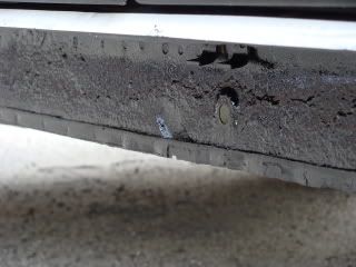

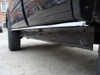

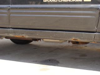

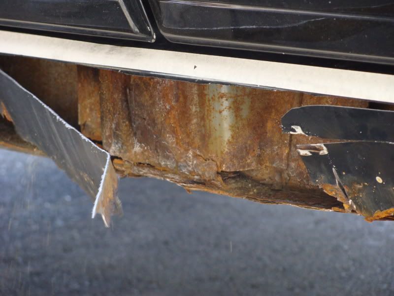

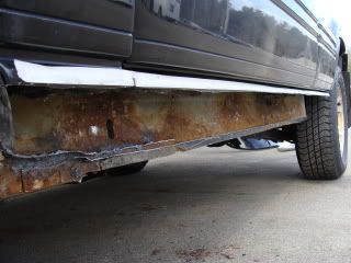

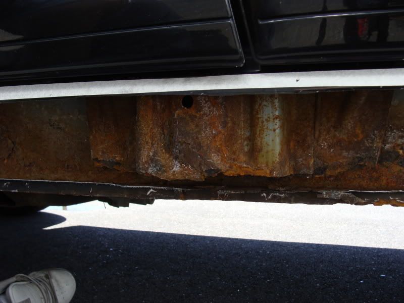

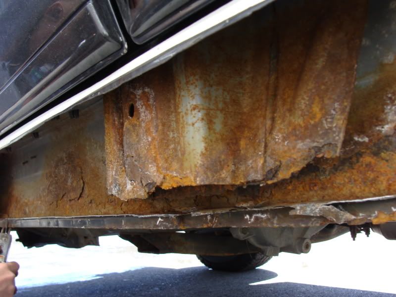

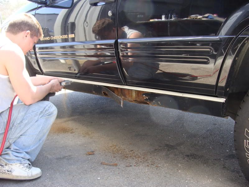

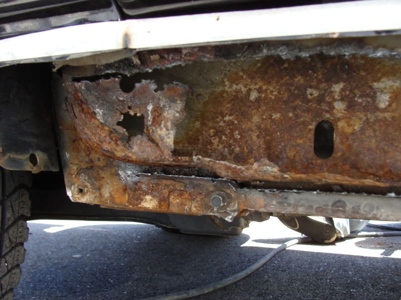

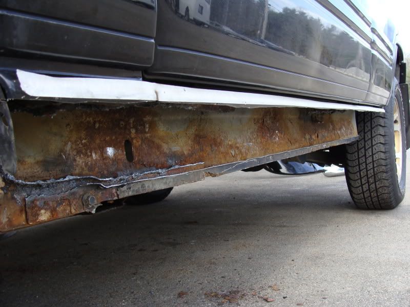

As of recently I started fixing my rusted rocker issue and designing custom rocksliders to be welded in place of the rockers. I'll repost those pics in here just to keep everything together. Next week I should be finishing those up... they'll have a nice step rail running the length of the jeep.

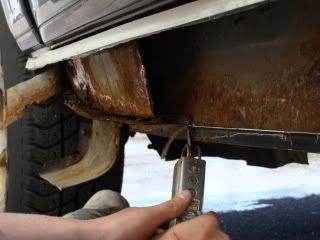

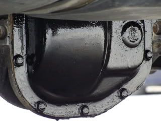

used a plasma cutter to get at the a and b pillars

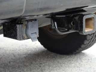

POR-15 everthing to seal it in.. while i was at it i wire brushed my trailor hitch and rear diff cover then POR-15ed those as well.

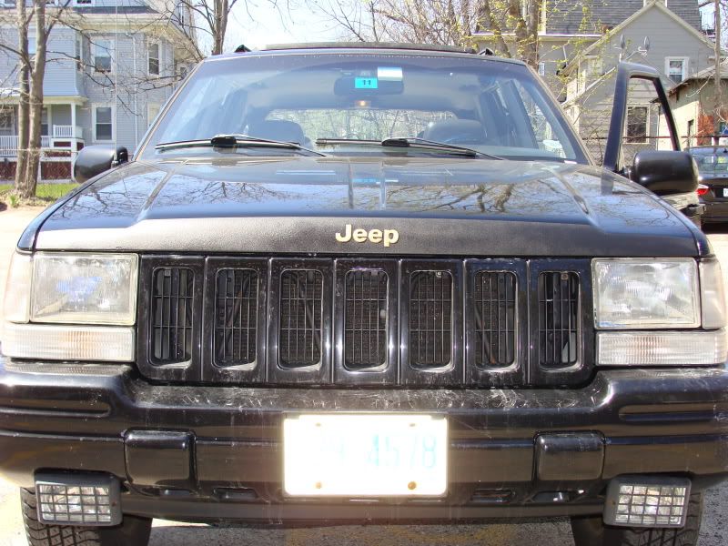

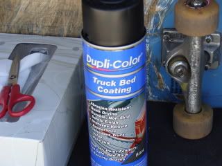

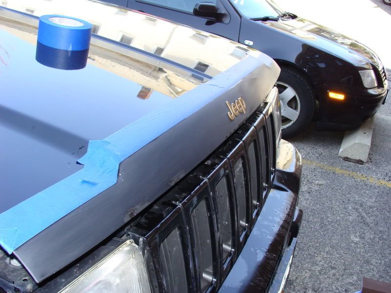

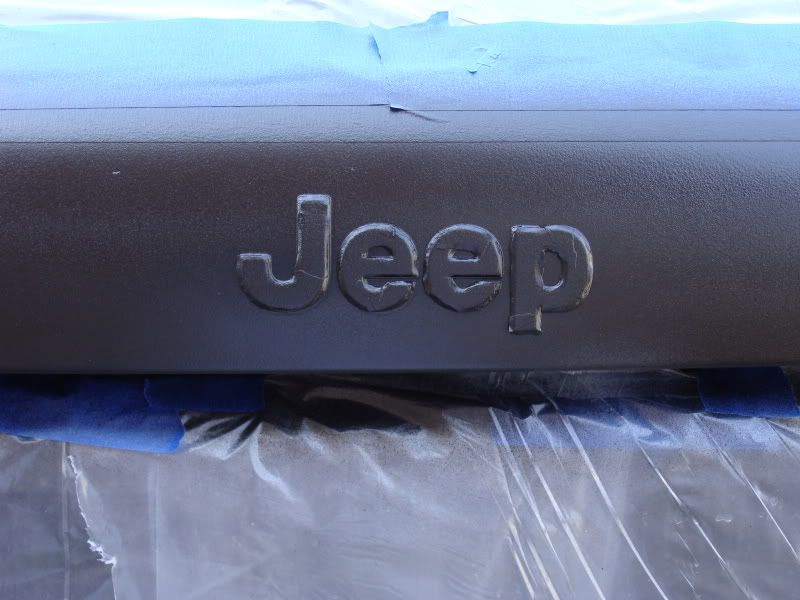

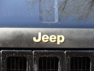

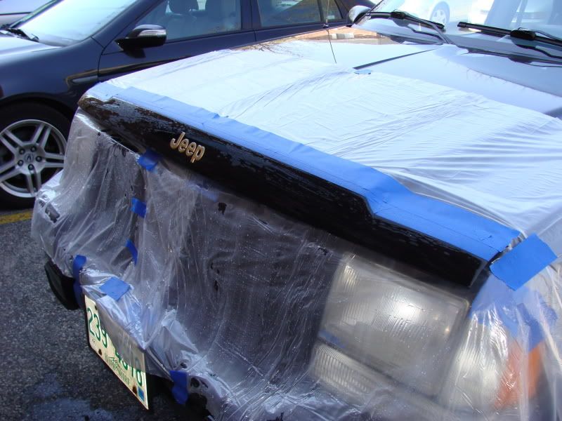

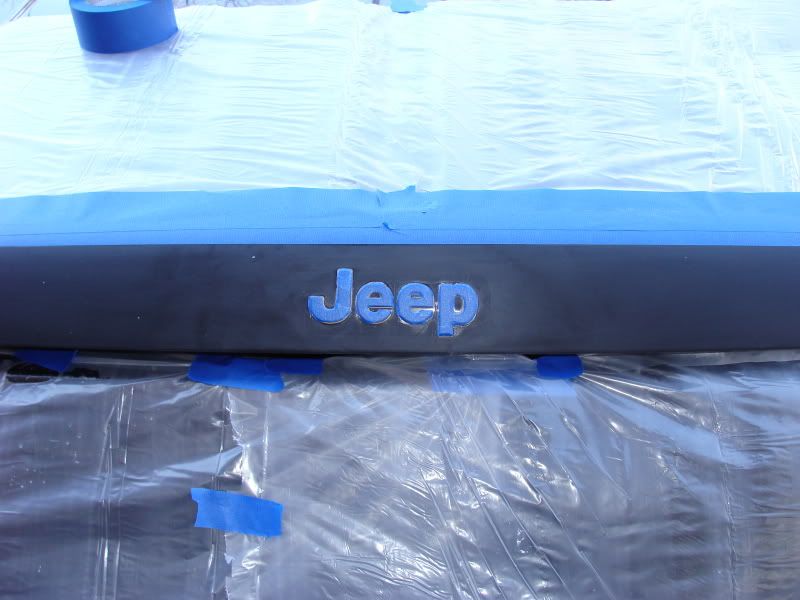

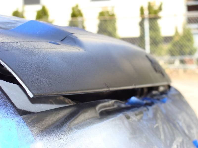

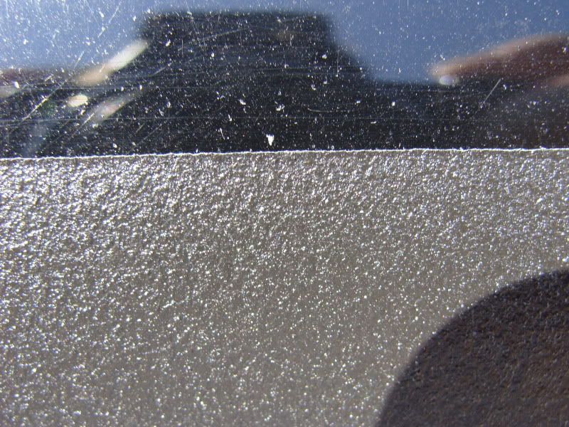

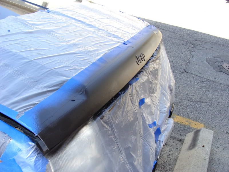

Today I fixed so rust on my hood... POR-15ed that as well then Dupli color bed lined the front of my hood to protect from rocks... what do you think.
this is good stuff:
End Result which i think look good.
here you can see the texture:

I'm likin' the bed liner. It's different.

Thanks... yeah its different.. i've seen a few other guys in here bedline their jeeps and it looks sweet and works great to protect it.

Any better photos of cutting your rockers out? I need to do that on mine.

I'm waiting to see more. I think I may steal your hood trick with the bedliner, mine is all chipped up.

I do have larger photos i can post tonight when i get home from work... and Yes i do have more photos of my rockers.. i will post those as well.

Ok hear are larger pics of the previously posted items... plus some new pics for the rockers.
Note: when I did the bedliner on the hood, I did wet sand the hood with 320, cleaned, and then painted.
hope these are what you guys want... if you want some new pics...let me know what it isyou want and i'll take them

as i look at the last picture i just posted i can actually see how bad my 11yr old paint job really is. I applied 4 coats of dupli-color bedliner to get the final product.
Edit: to get my line on the hood i followed the natural bend in the metal with my tape. this bend is very noticeable from the side and easy to follow.

here are some more pics of the rockers (larger pics)

Thanks man. Any photos of your rockers all cleaned up as well? I reallllly need to do this with my 97 ZJ.
