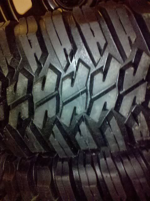

Immediate plans. I have my 4" RC x-series lift being delivered today. Already have my new wheels and tires, they just need to be mounted. Here are pics of those.
16x8 5" bs Black Rock Lobos
And treadwright MTRs 265/70/16
More pics of new jeep and lift coming later!
