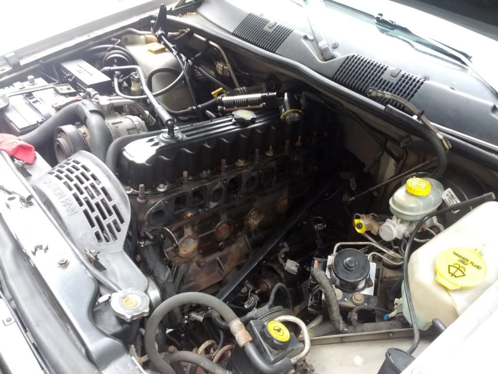

Phase I - Work in Progress
Finally had some down time to start working on this thing.
Phase I:
- Replace cracked exhaust manifold
- 99+ Intake Manfiold [...decided to hold off]
- Replace motor mounts

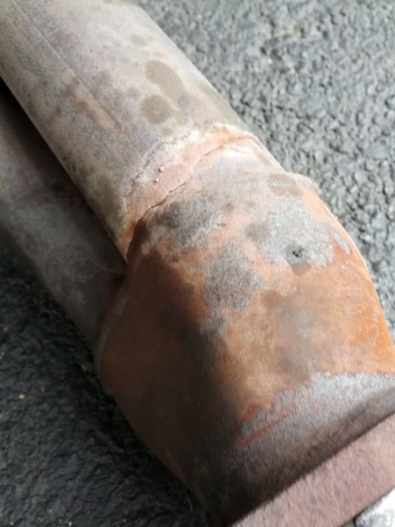

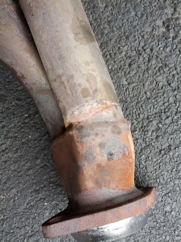

Took me about an hour to get down to this -
Typical exhaust crack -

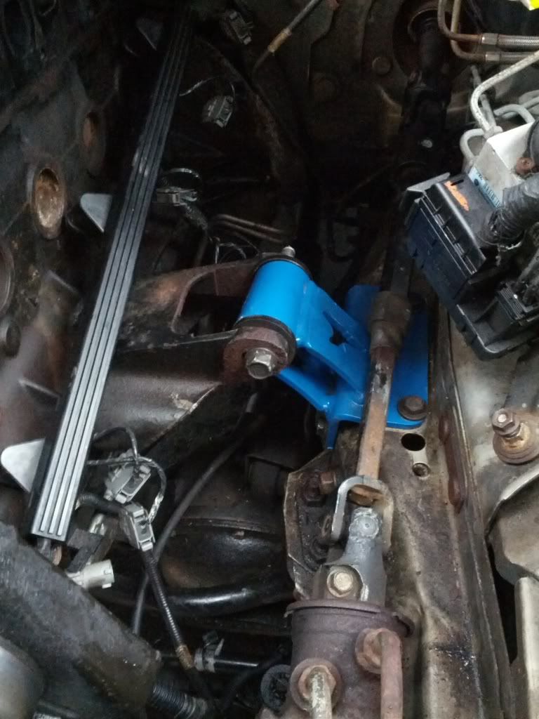

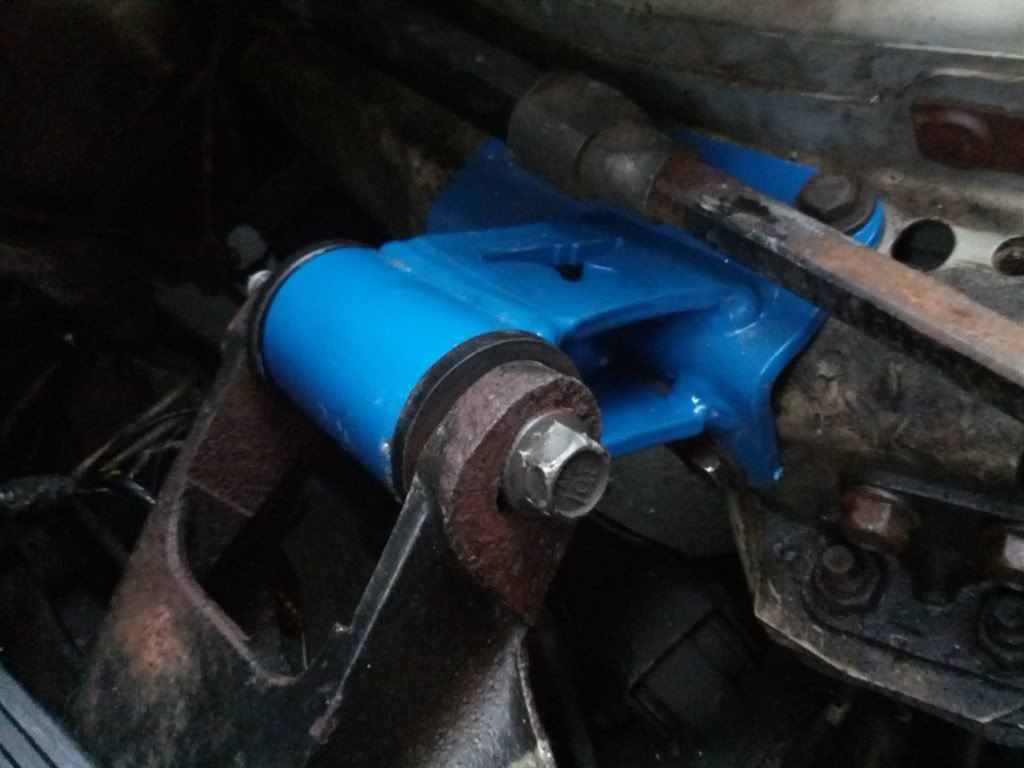

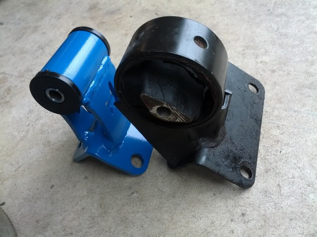

IronMan4x4Fab Mounts vs. a semi-torn OE -
Getting the motor mounts back in took me longer than I would have liked (~3-hours), and it started to rain so had to stop here -
