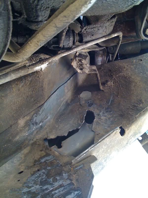

Oh I bet you I will. I almost did when I was at 4" with both my addcos connected
as far a ZJs go, this is what happens on short arms when you start dropping springs lol
upper CA should be there lol

Originally Posted by bigbluezj94 View Post
WJs dont count. you could lose a spring making a u-turn on the road.
thats why i want to go to long arms already. dont feel like ripping CA mounts off
