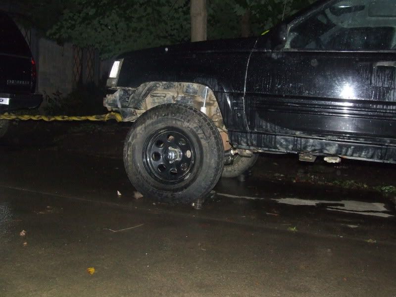

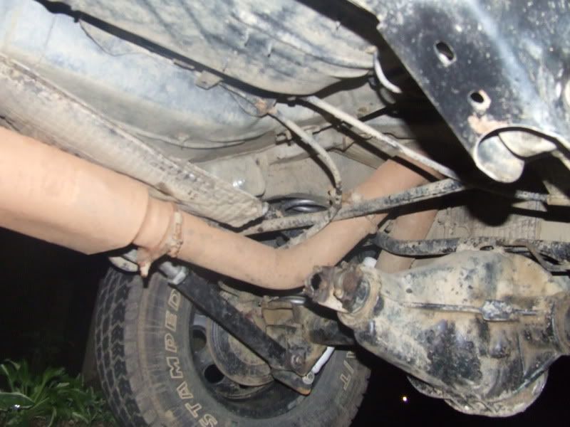

went outside in the rain and took some crappy pics for you guys
the reason for that strap above is...
and
lol
ill fix the ujoint on the rear driveshaft tomorrow and take some better pics

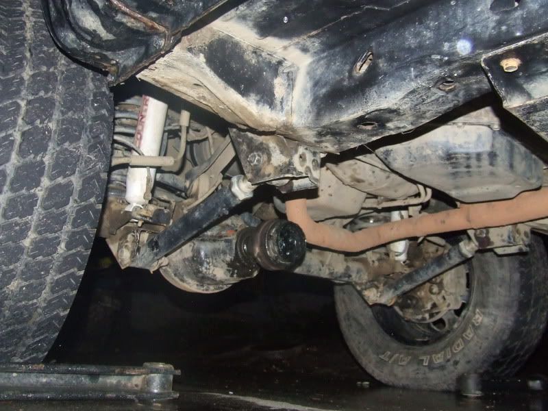

edit: to those of you who have experience with adjusting CAs, setting pinion angles, etc.
by looking at the pic of my front axle, do you think i need to shorten my front lower CAs? my pinion is like parallel to the ground.. i adjusted the CAs to what the RC instructions called for

Make the upper ones longer.
You need to go buy a magnetic base angle finder and measure your angle. Every Jeep is different and you cant go based off of somebody elses measurements. You can use them as a baseline, but you need to set your own.
He obviously doesnt have adjustable uppers

I thought John had/would have bought the uppers too. Guess not.
