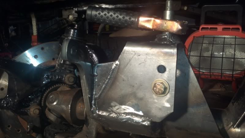

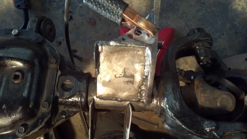

I finished up the OTA trackbar bracket. Went ahead and braced the crap out of it and welded on the JKS extended sway bar mounts to clear the WJ steering.. And I braced the crap out of everything. Overkill is underrated!. pics..
Driverside sway bar mount welded up. It was a total pita to get these aligned perfectly with each other. Had to reinstall the axle partially, clamp them on, measure with an angle finder, reconnect with sway bar, etc. Oh well theyre done.
passenger side mount welded on and braced to bracket

braced the driverside mount.

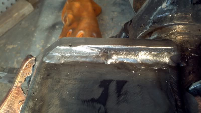

couple of the welds up close.

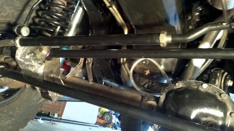

Installed! Can you say perfectly parallel trackbar and draglink? Hell yeah! I was very happy with the outcome.
