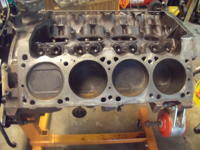

So today I was removing the old head gasket material on the engine block side.. I was using a razor knife, plastic scraper, and a drill with a mini wirewheel attachment (at lower speeds). I had shop towels inserted into the cylinder bores to block and major debris from entering, but eventually I need to clean out the bores and used an air gun attachment on my air compressor to blow out said debris. These cylinder walls are in great shape and I would hate for some dust to get caught between the pistons and the wall and end up scoring the cylinder wall surface. Is there any further steps I should take to clean out the bores? I hit them with air until no visible flakes of debris were in there numerous times thinking I would be ok. But a after doing some reading I am getting a little worried that I could have just totally screwed myself over and created more work for myself, or am I just being paranoid?

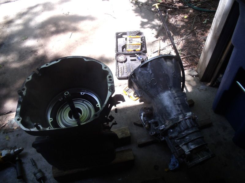

oh and here are both of my ZJ 46re's

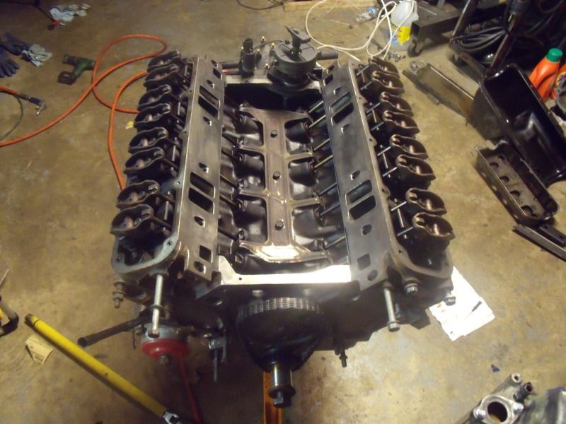

Anyways, heres some progress pics of the ZJ build.

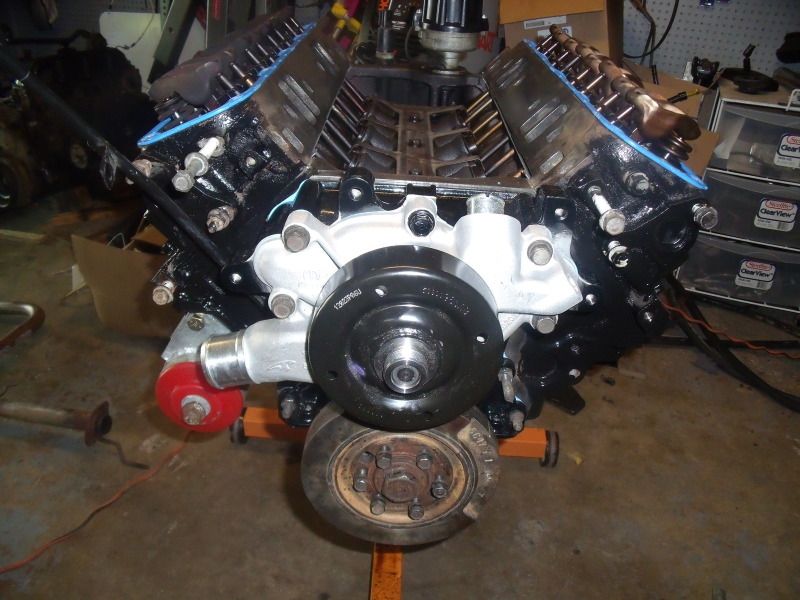

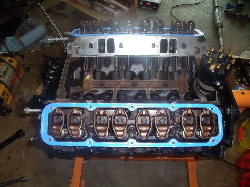

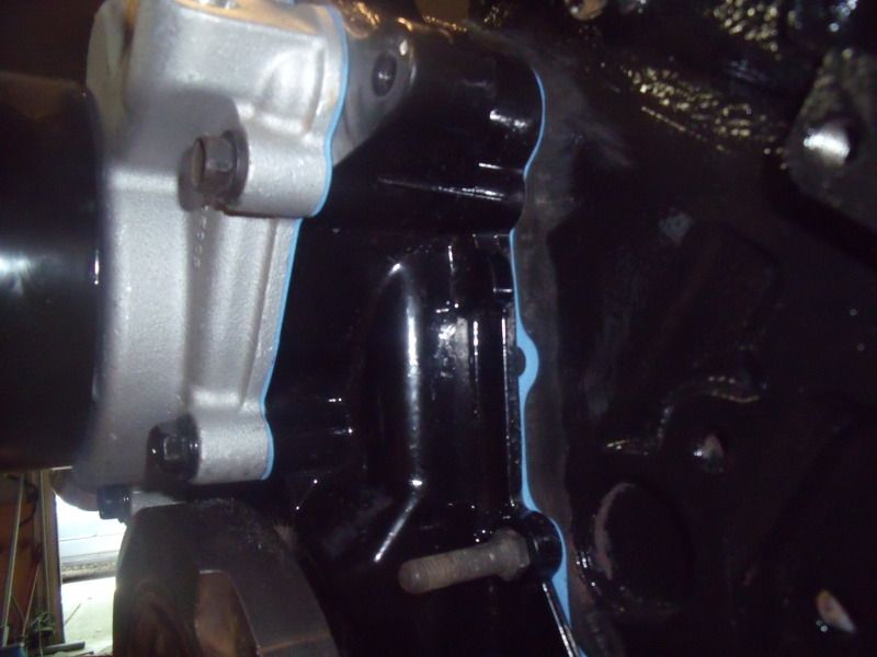

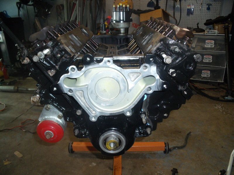

Block head gasket surface cleaned
headgasket

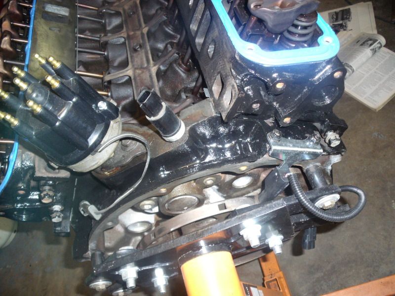

Cylinder heads installed

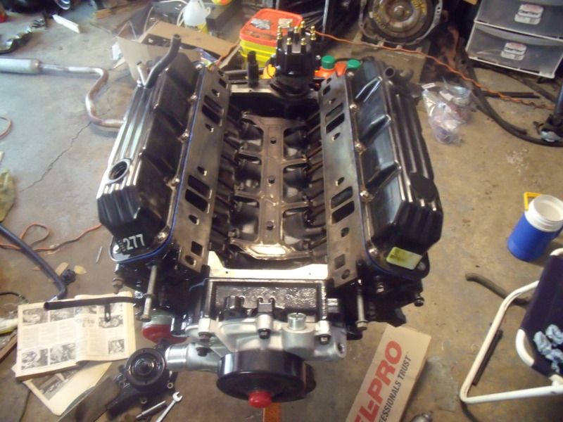

Then the timing cover went on after being powdercoated black
Engine was also painted with POR Engine Enamel
valve cover gaskets on
Mopar crankshaft position sensor installed
Mopar water pump installed
gaskets gasket gaskets
valve covers on
Oil pan back onn
and the thorleys

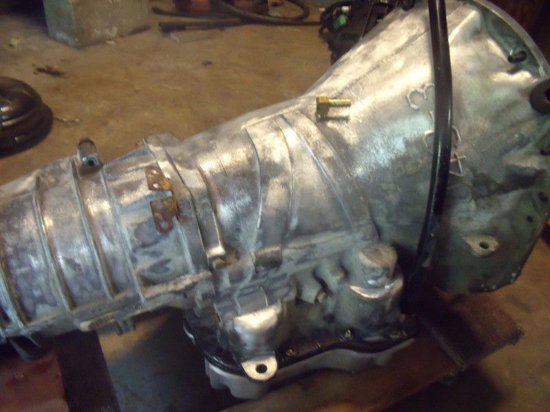

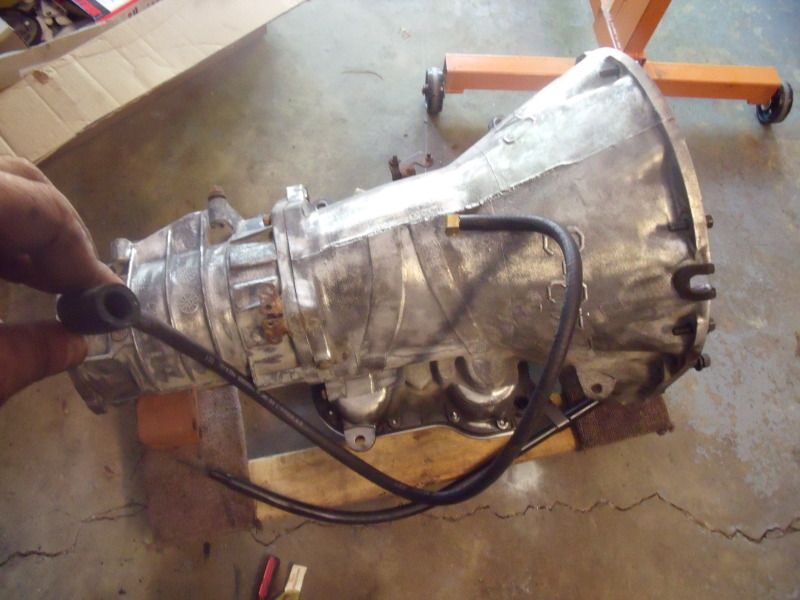

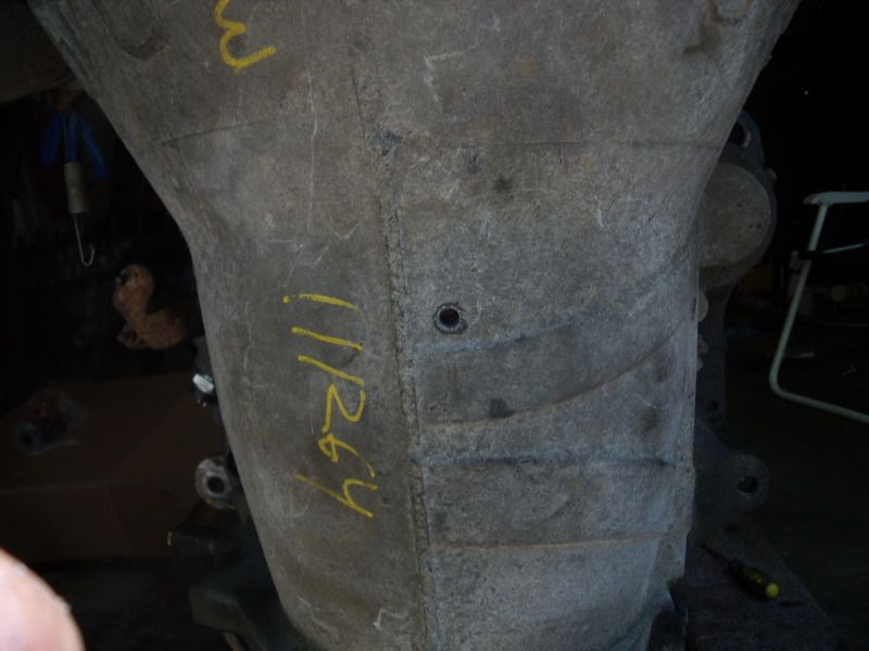

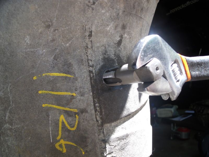

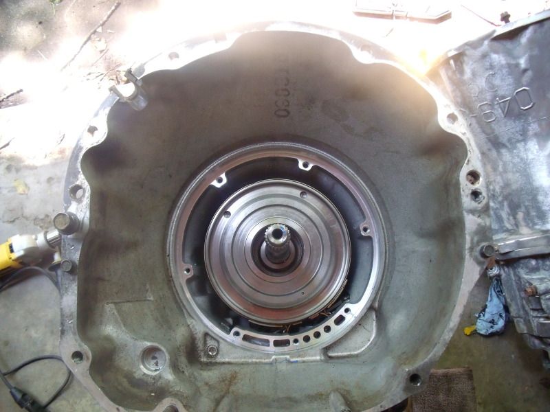

Then it was time to do a tranny breather extension mod.
Pop the pump cover off the tranny with a slide hammer
doing it to both my 46re's
drill a hole
tap it

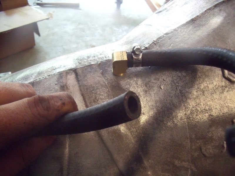

1/4" NPT 90* fitting with a 3/8" barbed end
3/8" ID hose installed
finished off with a hose clamp
My Build Thead

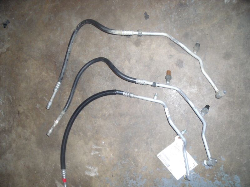

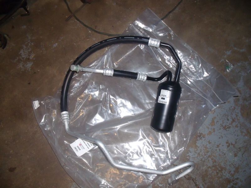

Then I had some parts come in the mail.
AC Accumulator
5.9 Discharge AC line.. $160 from wholesalemopar.com....

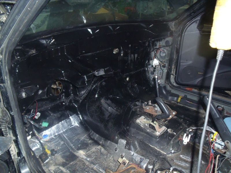

Then it came time for a lot of cleaning and painting.
spray paint the inside of the firewall.. no bare metal allowed
Then I POR15'd the body where the gas tank mounts
The underbody and tranny tunnel
and the wheel wells

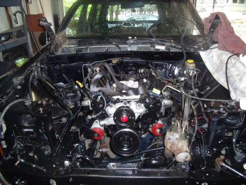

Then the engine got installed
mmmmmm clean
And the engine bay wiring harness went in

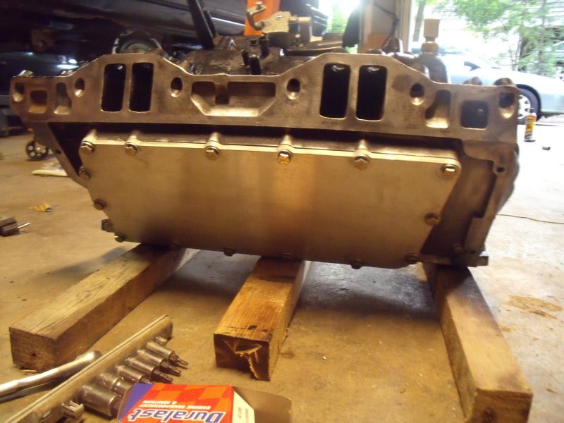

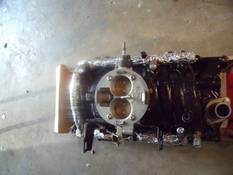

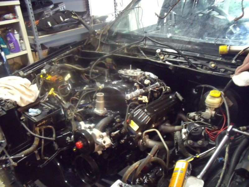

Then it was time to work on the intake manifold.
painted up with POR engine enamel, 50mm throttle body installed, 180* Jet Performance thermostat, new water outlet neck installed, etc
Then on went the Hughes plenum plate

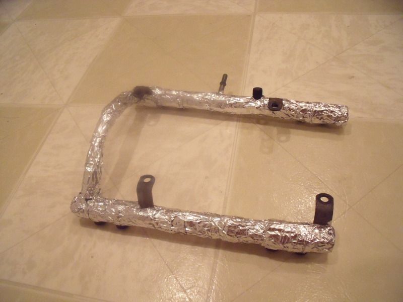

wrapped and insulated fuel rails
fuel rails installed
intake manifold installed

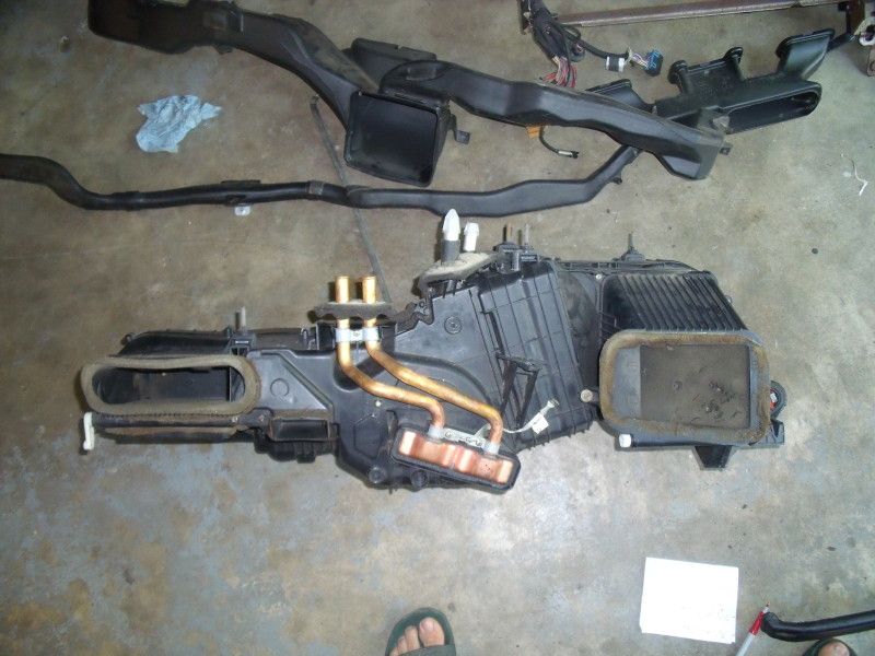

Then I moved onto finishing up the AC/heater box.
With the old foam tape....
Bought some of this
ended up with this
Installed
Then the dash went back on which I guess I dont have a pic of. I then reconnected all the wires, and now all the different harnesses are hooked up. I then installed a battery and was able to roll the windows up and down. Guess I did something right
So thats where I am at with the zj build, its been a lot of work.

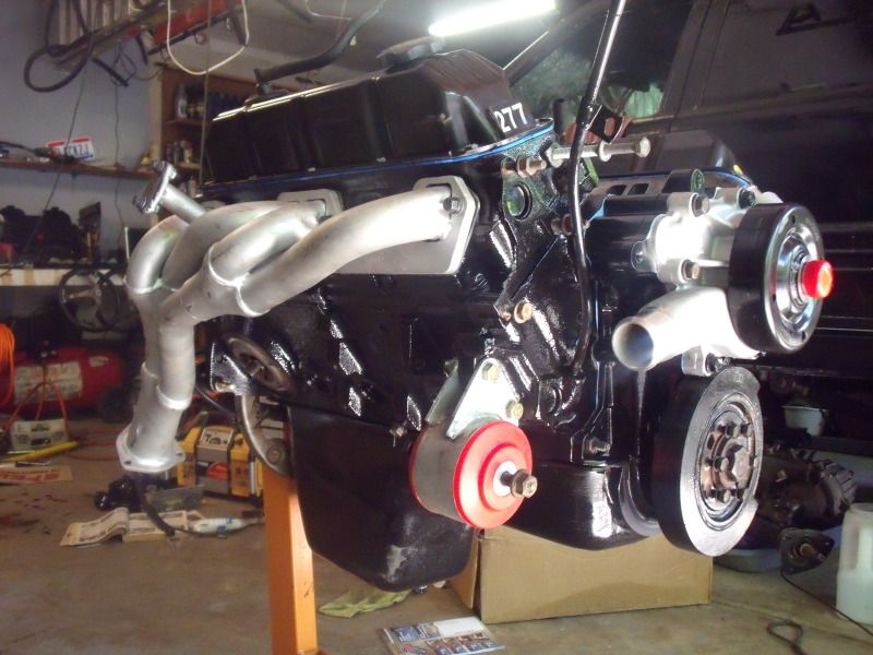

And yes it is Roger's old niner. Its got 187,600 miles on it. DT headers, 3" exhaust with a Super 44, procomp mx6 shocks, upcountry springs with 1/2" spacers, Hotchkis rear sway bar, RB1 Navigation system from a WJ, K&N, Kolak Ignition upgrade, Ecode headlight housings, etc. I plan to keep it basically how it is. But I did just swap in a Flowmaster super 44 and tailpipe yesterday for the magnaflow muffler that was on there. That and I am going to get ahold of the 5.9 rims with 31" metric equivalent General Grabber AT's from the slate 5.9 that I parted out (my friend bought the rims from it).
Ill get some pics of it up tonight or tomorrow for you guys
