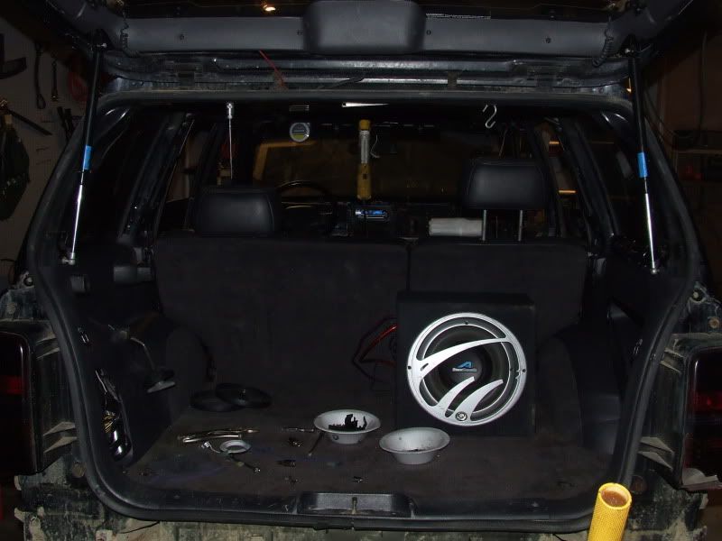

yooooo dude. so before i do all this work matting up the hatch....are the stock hatch struts strong enough to hold it up with the extra weight?

took this pic tonight for ya
no vice grips holding up my struts
