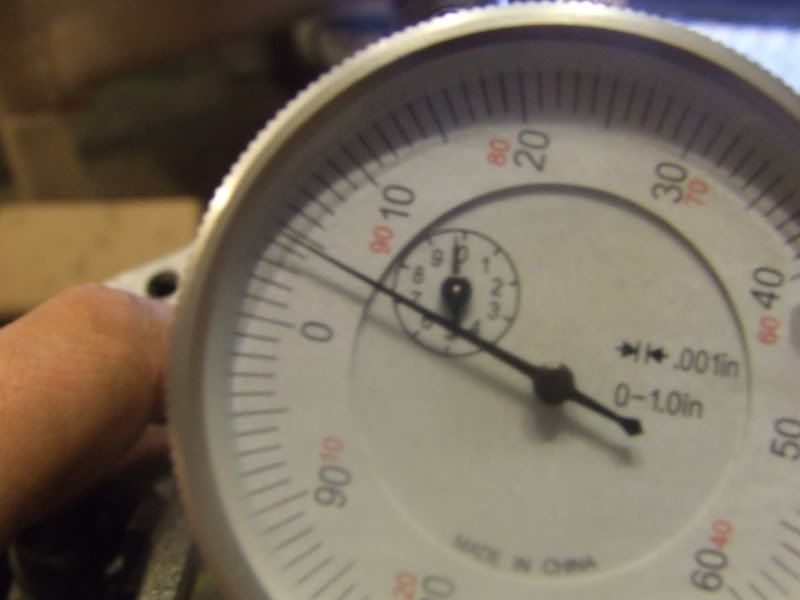

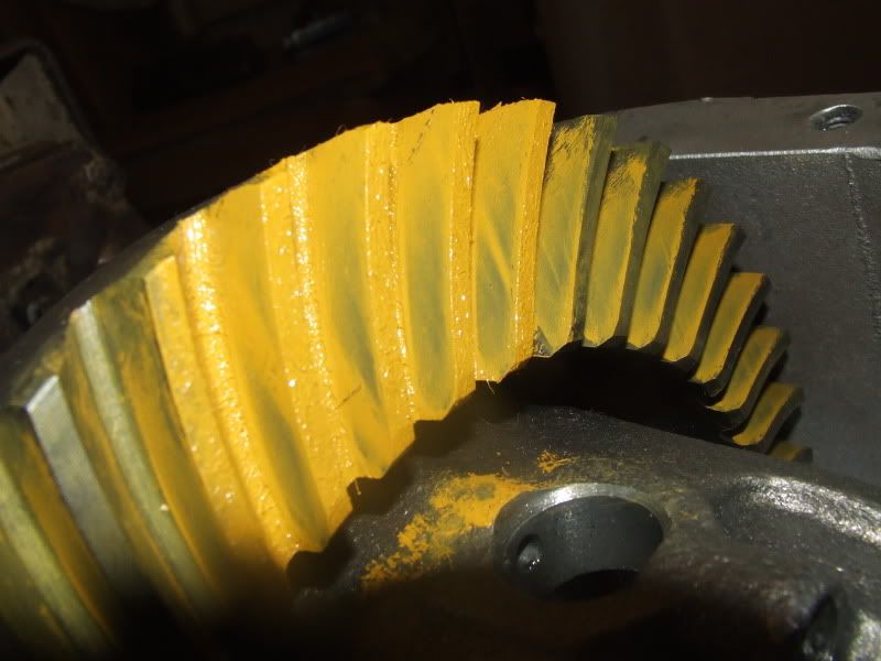

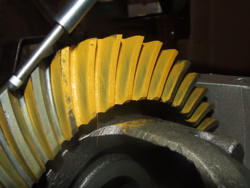

think I just got a good gear pattern!
pics uploading
edit:
.005" Backlash
^same specs in all 4 pics
whatdya guys think?
its throwing me off a little, because on some teeth the pinion looks too deep, then on others it looks perfect. Using factory shim specs btw

Do you have the illustration from the FSM showing the drive side and the coast side contact patterns?
Jeff

just did my front on sat, as we talked about on FB, and I had .007"
