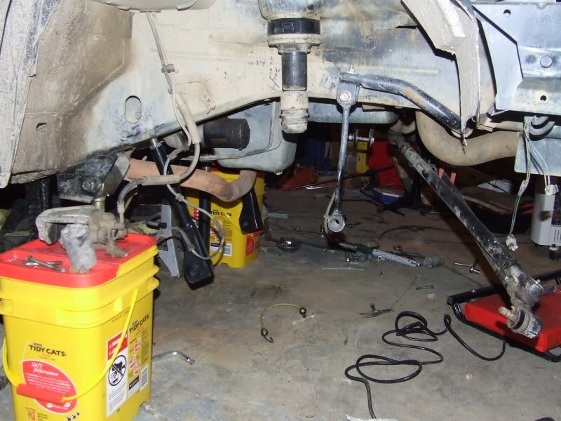

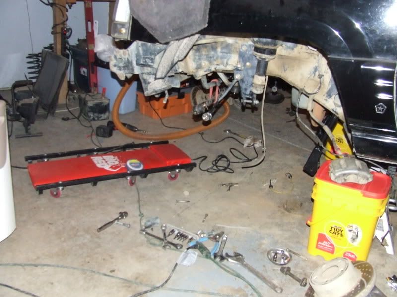

did this a couple days ago
hover jeep engage
got to work on the 44a tonight. only thing holding it in are 2 control arms and brakelines. im not quite sure how to remove the brake line splitter box. Thought I heard somewhere it was bolted down at the axle breather vent nipple? Ill check it out more tomorrow. Any ideas though?
If its anything like the 44a in a WJ, you use a 9/16 deep well to remove the breather nipple thing. That will remove the splitter box and brake lines.
This is correct. Exactly what I did when I swapped 44a's in my niner.
