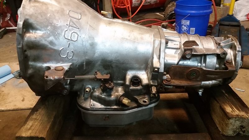

Small update:

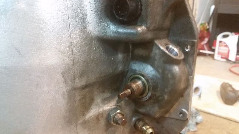

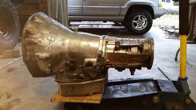

Got parts for the Tranny bearing swap..
Just finished swapping the bearing and replacing the shift shaft seal on Sunday.
Swap was pretty easy. Pictures may look discouraging (or not). Forgive the saturation of light in a few of the pics. I had my 1000W halogen "heated" work light on.

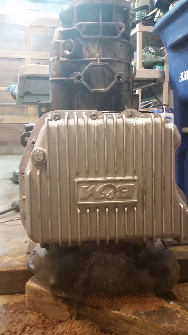

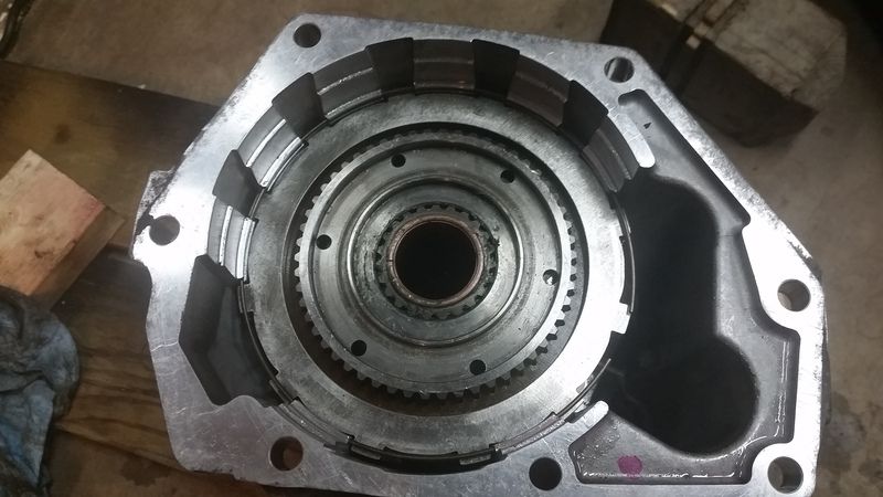

Tranny out
OD housing removed

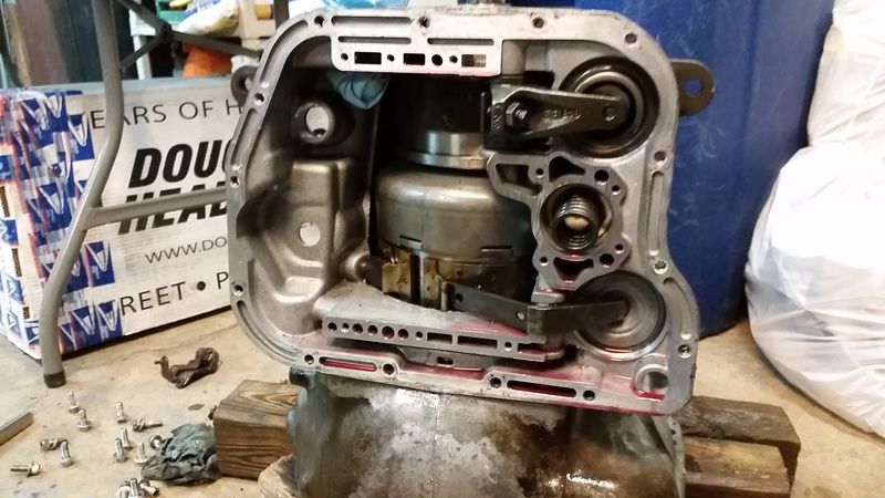

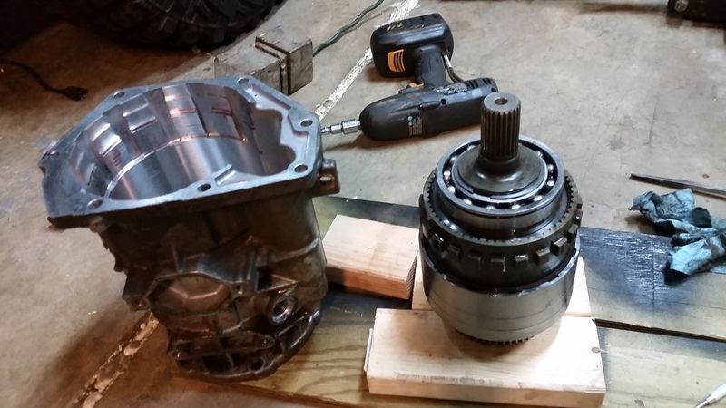

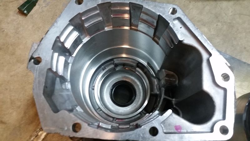

First set of clutches removed, and OD "core" unit removed. That is the bearing in question that you see. It's huge! like 4.5" (?) in diameter.
Empty OD Housing

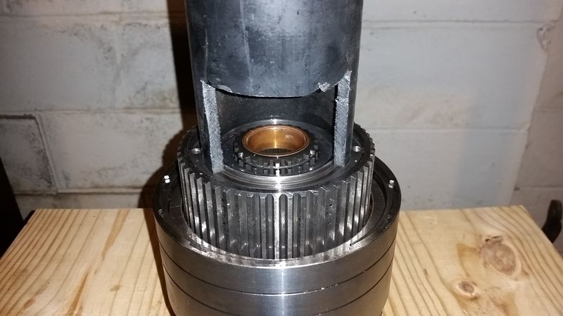

Using 3" ABS plastic pipe to compress the OD spring (~800lbs of force). Worked just fine. Did not even buckle, creak, clunk, nothing. Wouldn't doubt it, but if you did these OD housings on a regular basis at work then the official tool would be worthwhile.

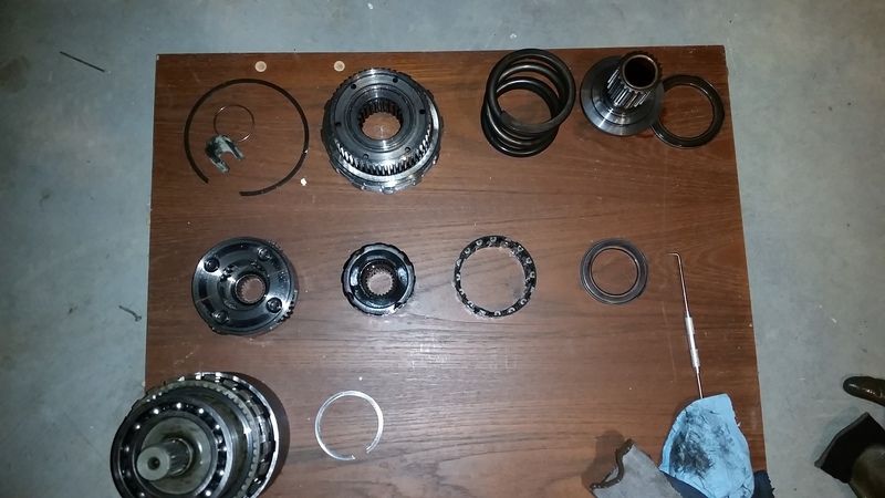

Most of the OD parts laid out

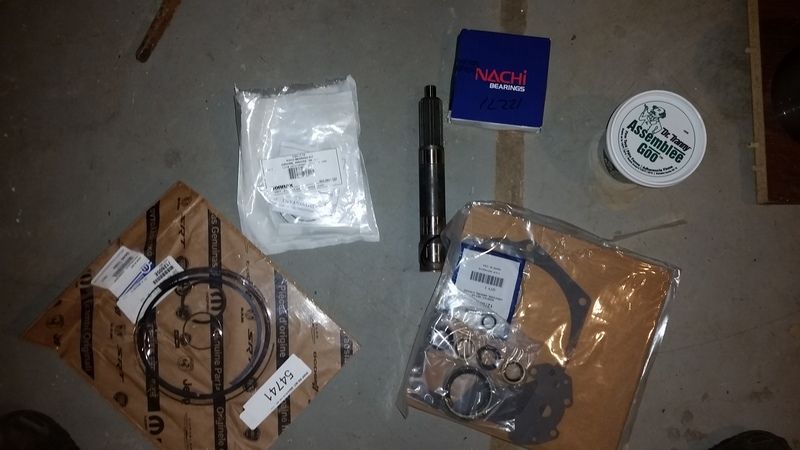

Parts I bought
Sawed off intermediate shaft to use for alignment, Nachi bearing, Koyo thrust washers/bearings, snap rings, gaskets, seals, transgel goo, etc.

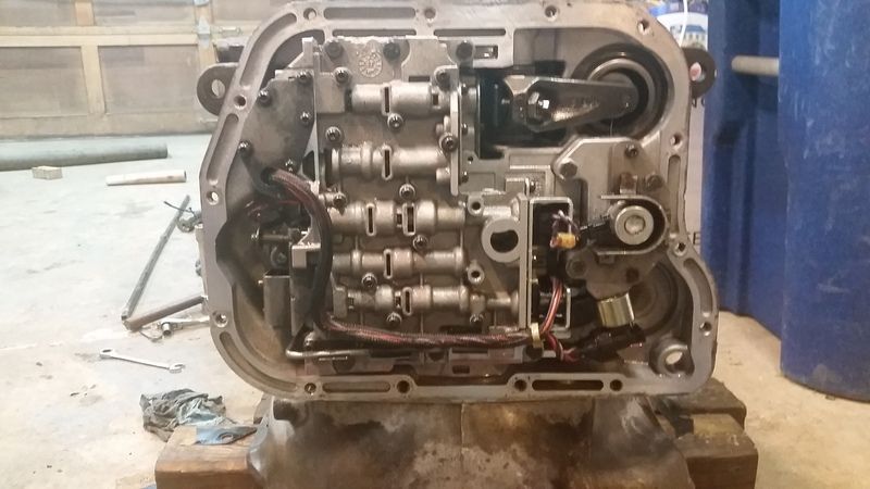

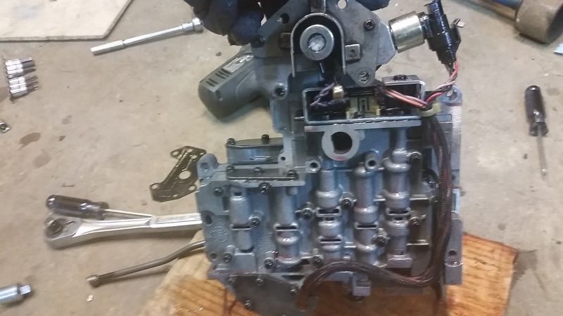

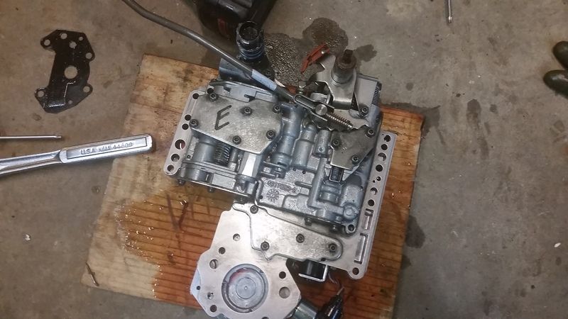

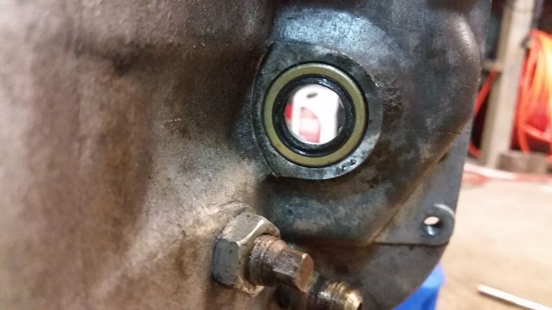

Valve body removed to replace the Shift Shaft Seal. VB removal is actually pretty easy. Something like 9 or 10 bolts. No check balls fall out with simply removing it. Now they do if you take it apart.. But for my purposes I did not need to take it apart.
Shift Shaft Seal Replaced
OD unit put back together
The removed valve body
Valve Body reinstalled
Pan back on, OD housing reinstalled
All put back together. I REALLY wanted to grind down and paint those rusty brackets but no time because I have so much else on my plate.
I am on my last Spring Break this week, however, I work Monday-Wednesday at my one internship (the company I want to work with when I graduate in December). But I have Weds night, Thurs, Fri, and Sunday to get the tranny back in, test for vibes, and a few other things. I will report back with my findings as far as the vibes go.
Moving on to something else.

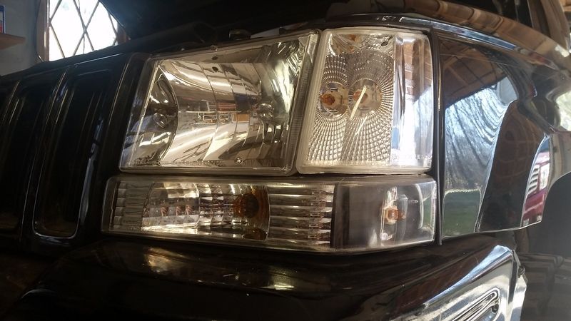

Long story short, I tossed my chrome/crystal/euro turn signals into the oven to remove the lense covers to clean the inside as some muddy water found its way in awhile back. Well, they warped. And I am PISSED.

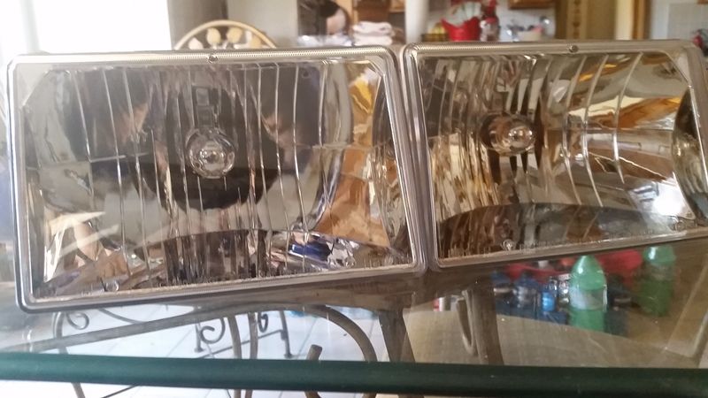

Anybody remember these headlights? They were on Ebay constantly from about 2006-2009ish. If you have a set, or even any pieces of the set (pairs of course), I WANT THEM!
And no, I do not want the newer euro style ZJ headlights. They are not the same and do not look nearly as good.
I plan on putting my FXR 3.0 Projectors into these housings so I would like another set (full set if at all possible).
Here is a picture of what I am talking about. THIS EXACT STYLE.
If you have a set, PM me on here or email me at BLACKzj52@gmail.com
I am willing to pay up to a certain amount for these but will not be taken advantage of.
MY MAIN PRIORITY IS THE TURN SIGNALS! If necessary, I can source the headlight itself and corners elsewhere but can't find the turn signals. But like I said, I am willing to entertain any offers.
Forgot to mention, I have a full set of the black version of these housings that I would be willing to trade.
Comparison between Chrome and Black Style (chrome DS, black PS)
http://i48.photobucket.com/albums/f2...-34-00_213.jpg
All Black
I would be willing to trade my entire set of black housings for JUST THE TURN SIGNALS if somebody was willing. Or just a straight up trade for an entire chrome set. I also have a set of the black smoked fog lights that were on ebay awhile back that I could throw in (that have a surprisingly good beam pattern).
PLEASE, I want these turn signals. My dumb a** warped them in the oven when I was trying to open them up to clear some muddy water out of them (damn permaseal glue....)

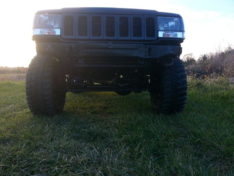

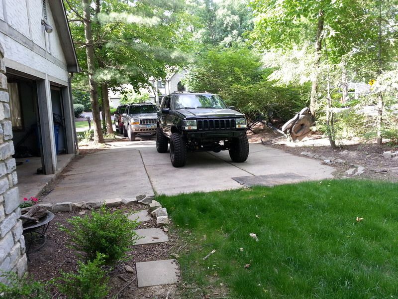

And just because I feel I have to post pics:
This is how I conduct my testing... although recently I've left the tires on since I have the driveshafts removed.
Oh and also, I decided I really don't like my black headlights. Going back to chrome! And look what I found, the matching chrome corners! And I bought another set of the old (better) style chrome housings... Projectors soon fools...
Unfortunately I trashed my chrome turn signal when tossing it in the oven to remove the lens (to clean it).. ******* Eagle Eyes used that permaseal crap to seal the turn signals and corner markers while using traditional butyl on the headlight portion. What the hell?
Pics:
I will be removing the black corners, cutting them off, and having them shipped out to be vacuum metalized which is the process of applying the chrome/polished reflector coating (for those of you unaware). I spoke with a company here in Ohio and sent my trashed chrome housings up to him to practice on. If all is satisfactory, I will have him do my black turn signals and maybe black headlight housings as well.
