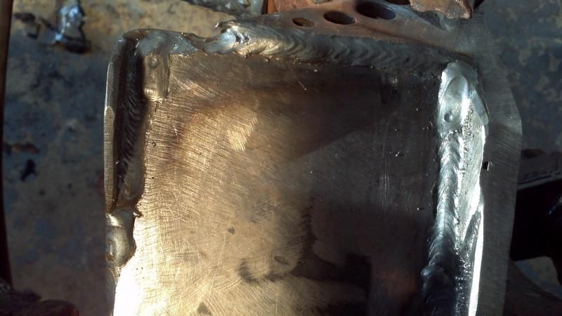

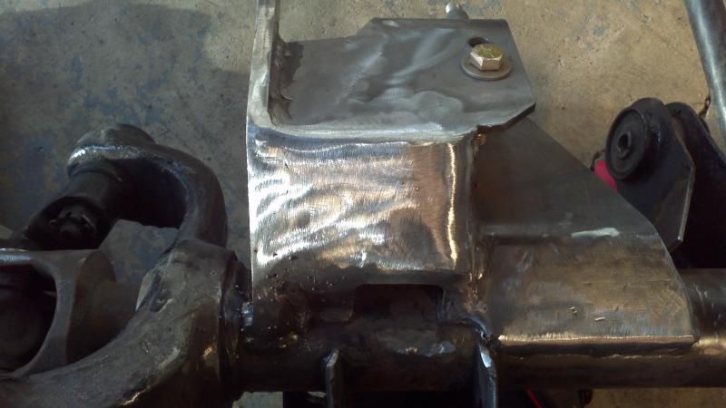

I finished up the OTA trackbar bracket. Went ahead and braced the crap out of it and welded on the JKS extended sway bar mounts to clear the WJ steering.. And I braced the crap out of everything. Overkill is underrated!. pics..
Driverside sway bar mount welded up. It was a total pita to get these aligned perfectly with each other. Had to reinstall the axle partially, clamp them on, measure with an angle finder, reconnect with sway bar, etc. Oh well theyre done.
passenger side mount welded on and braced to bracket
close up
welds ground down
braced the driverside mount.
couple of the welds up close.
Installed! Can you say perfectly parallel trackbar and draglink? Hell yeah! I was very happy with the outcome.

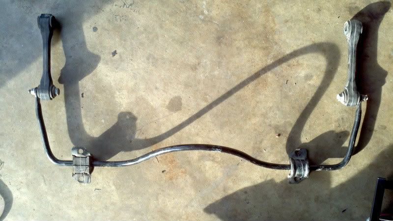

so then I came across a factory TJ rear sway bar...
Nothing has happened with that swaybar yet, but I need to figure out some links and then get some brackets and weld them to my D44a. Whenever I drive my Black ZJ I can feel the back end just bouncing around - it drives me nuts. Definitely need a rear sway bar..

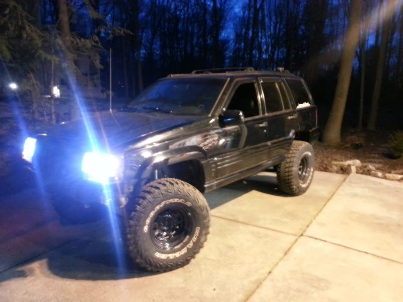

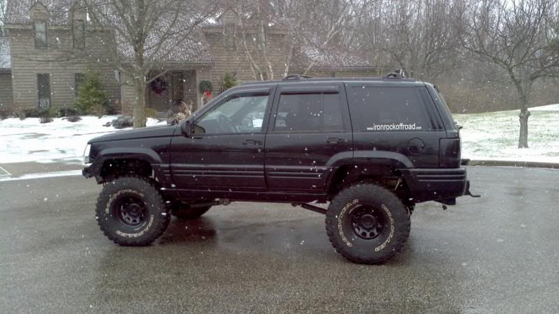

Then one day I got bored and took some pics.
then I went on a test drive
Another
So I've put some miles on it recently, somewhere in the 30 range. Yeah I know not a lot but like I said I've been busy. I've gotten it up to 65mph as well and it vibrates a little bit. Had a couple buddies ride along with me and I think we have determined that I need to yank my MT/R's off and get them balanced better as they are vibrating. And IIRC first production run MT/R Kevlar's sometimes suffered from hard-to-balance issues and/or out of round problems. But other than that its been driving pretty well. Just need more time to drive it more AND need to get the tags reregistered and get it insured once again

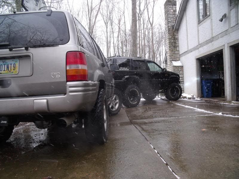

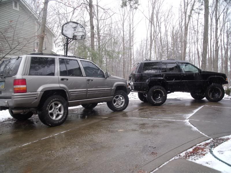

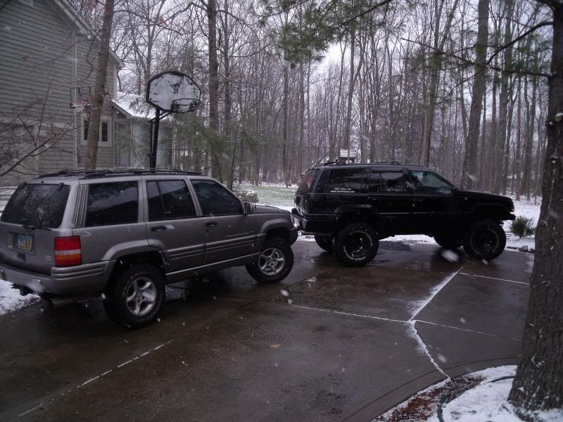

Then we got a good amount of snow so I decided to go out and dick around a little bit. No really good pics but heres some generic in-snow pics
ended up dumping like 8 inches in one night. Hell yeah

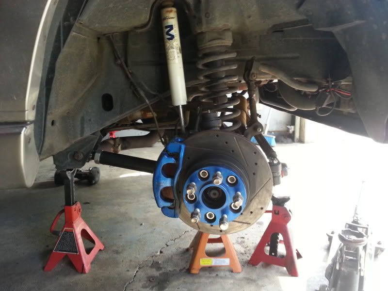

So it appears I had just gotten my ball joints in when I last posted so we will start with all the brake and front end work I did on the niner.
I went with XRF BJs, Hawk HPS pads, painted everything, etc etc
Pics

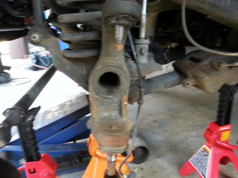

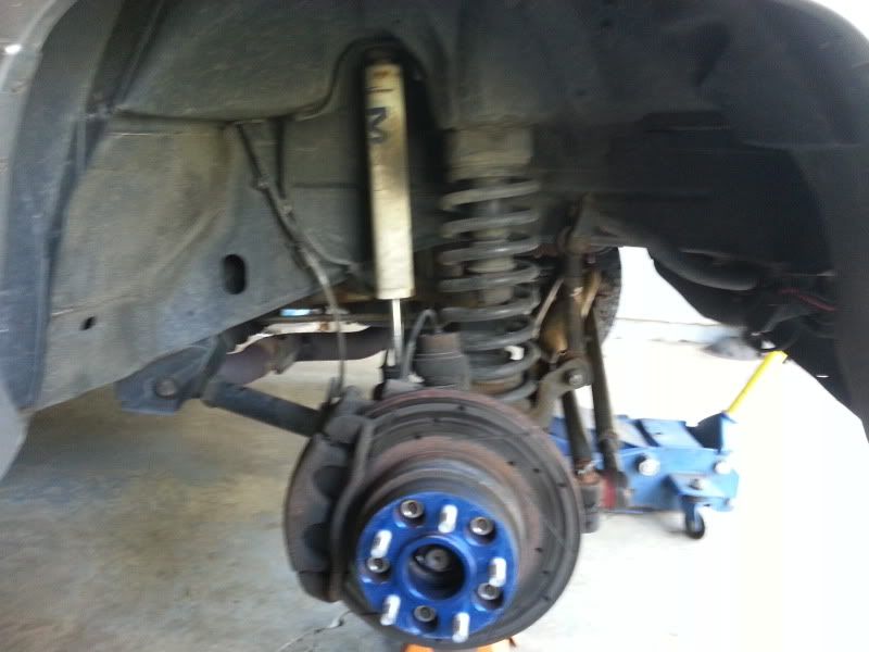

starting point

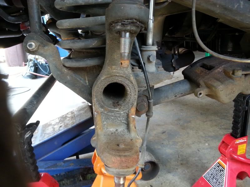

Now I said my balljoints were bad right? Well they were.........very bad.....had some serious play in them. I will allow the next two pics to illustrate my point
next..
can you say yikes?!

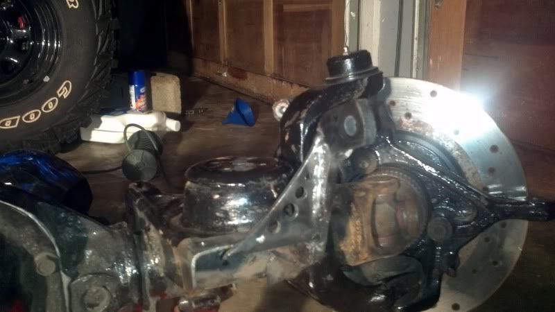

new BJs in, new CA's in, and new passenger side axle control arm mount welded on, because somebody managed to mangle the old one up pretty well..

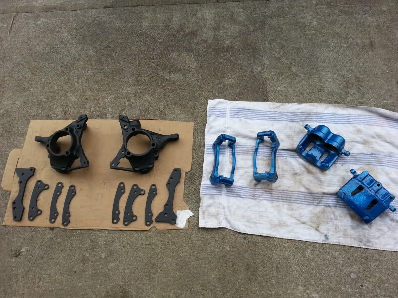

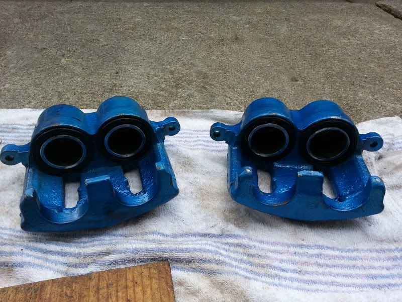

At this point I began a color scheme for the niner..... For the Blackzj the has a color scheme of black on black on black with some red accents.... For the niner, it is the body color (Bright Metallic Platinum) and anodized blue. My wheel spacers are what convinced me....
So needless to say, the brakes were getting some anodized blue treatment. Not they were not actually anodized (duh, theyre not aluminum), but VHT makes a paint that works quite well when painted over some shiny silver....
Vanco knuckles painted flat black, brakes, and brake brackets painted up anodized blue.... mmmmm sexy

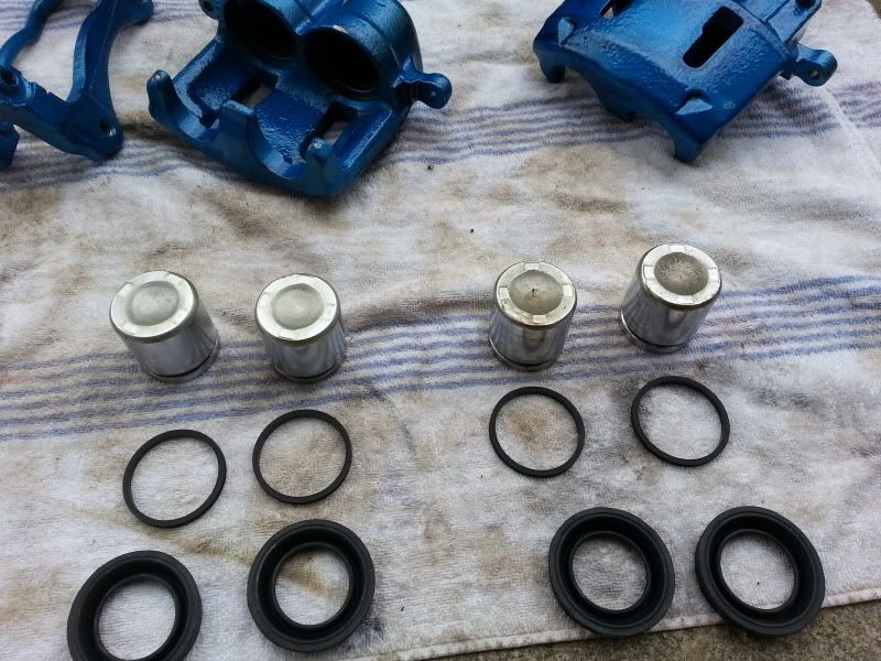

pistons removed, cleaned up, and brand new seals and orings installed in the calipers.
pistons in

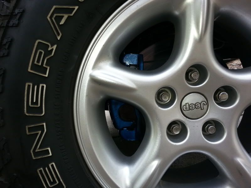

^definitely like these pads
everything back together. And I must say I was rather proud at how well the calipers (an amateurly painted anodized blue) matched up to a true a true anodized aluminum blue wheel spacer...
lighting didnt completely work out in this pic but you get the idea
