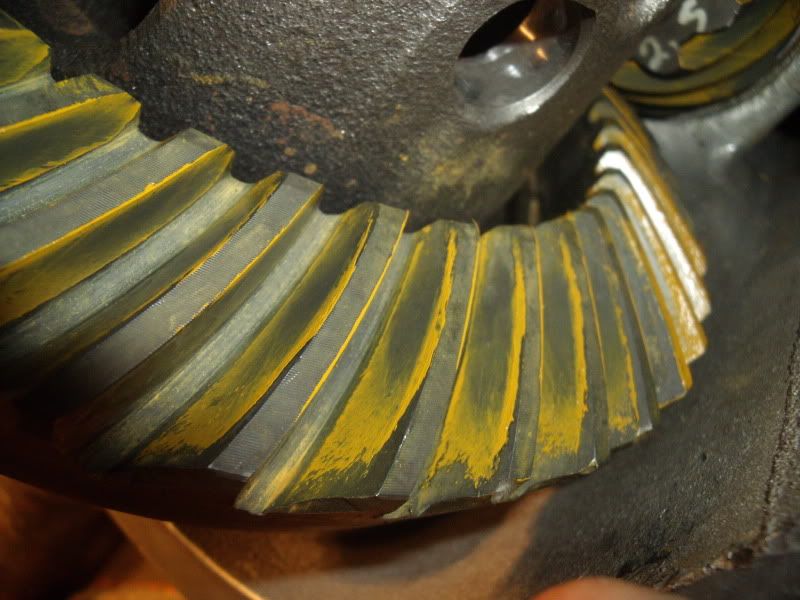

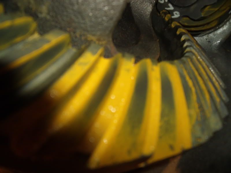

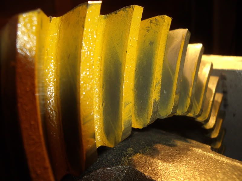

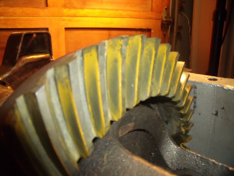

d44a got the new inner pinion bearing slapped on today. just need to crush another crush sleeve and install the seal and im done.
itll be getting painted this weekend i think. then ill put it under my zj
pics of the pattern
drive
drive "negative"
coast
coast "negative"

did some reading up on gears. what a pain in the *** you've gone through lol.
those patterns are solid!

Coast and drive sides look a little deep. Pics may lie though
I concur. Definitely too deep. I'd start by removing about .015" from the pinion shims.

nah its perfect. if i removed any more pinion shims it was way too shallow
coast doesnt matter nearly as much as drive
