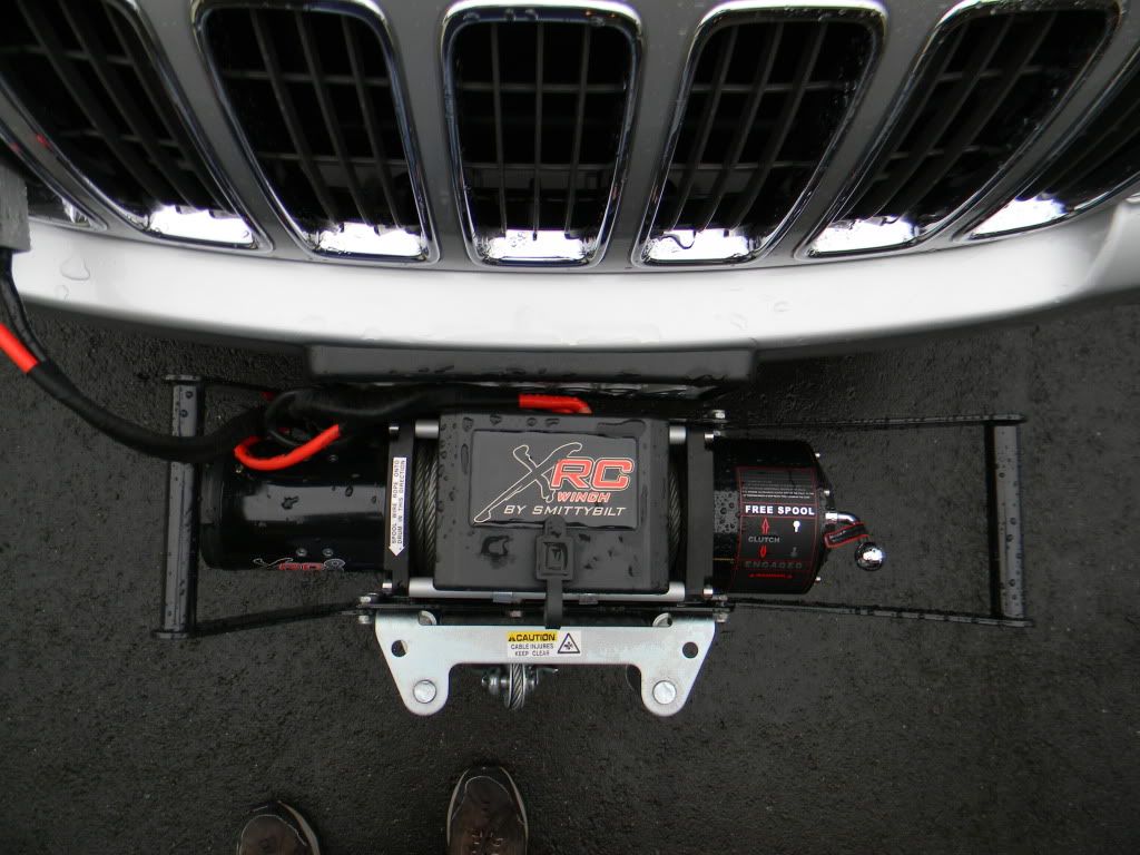

Build Thread Update:
Not much new to report, there's not much I felt the WJ needed, plus with another kid on the way and my scheduled unemployment (contract work) I wasn't planning on spending any money on the Overland. But, there was one thing that I didn't like: the Harbor Freight mobile winch mount.
The HF mount fit nicely, but it was flimsy. The steel was all .100" thickness, just too thin. With a winch plate that thin, the plate can bend/warp under load and break the winch. So, on the advice on JF members, I picked up the Promark Offroad winch plate which was reported to be 1/4" steel all around. For $80, it sounded like a good value and I ordered through Amazon.com
Well, the first one I received had a major manufacturer defect. The hole for the hitch pin was offset .095" on one side, enough to make it impossible to pass the hitch pin through when it actually installed into a receiver hitch. So, I contacted the seller. No response to emails, so I filed a complaint with Amazon. That got their attention, and they sent me a prepaid return label as well as a new winch mount.
Lo and Behold, the replacement winch mount had the same defect. A little less awful, but still off. So I contacted the seller again, and their response was to just give me a refund and keep the defective product. So I was faced with the option of throwing it away or modding it work correctly. Why is that so common in the Jeep community?
So what I did was take a 21/32" drill bit and ream out the hitch pin hole a little until it fit. No big deal, got it to fit alright. But of course, the hole was too far back on the receiver mount. It was a perfect fit for the rear hitch, but in the front hitch it barely slid into the receiver. So I drilled another hole to suck the winch mount back against the license plate and clear up some approach angle.
The Promark Mobile-Mount is as burly as described, all 1/4" steel plate. The grip placement and design makes it a lot easier to handle the winch assembly, even though it is a little heavier, around 110lbs now. However, the fitment is really tight on the XRC8, and while the welds have good penetration, the winch mount is warped a little. It does not point straight forward, it's about 5-7 to the right. The handles are also a bit warped, you have to use the mounting screws to clamp them down onto the base. It's pretty clear that quality control is pretty much non-existent at Bumfrick, China where this is made.
Given that it turned out to be free, I can't complain. But I can also say that neither of the inexpensive winch mounts I have tried have turned out to be very good and the Warn, while spendy ($280) might be worth looking into. Since this one is very strong and functional, I'll be sticking with it.
And now for a couple pictures:
As you can see, the roller fairlead sticks wayyyy out there, I might pick up a Hawse.

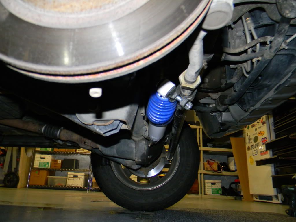

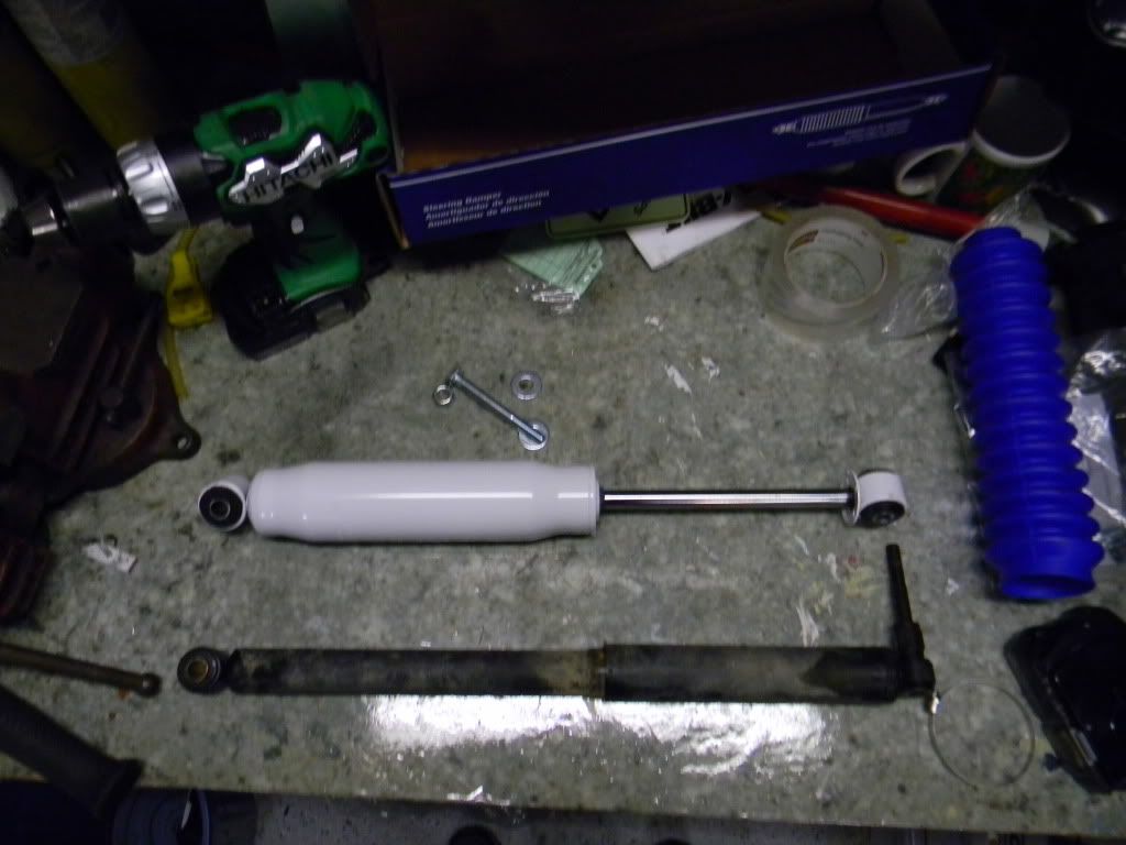

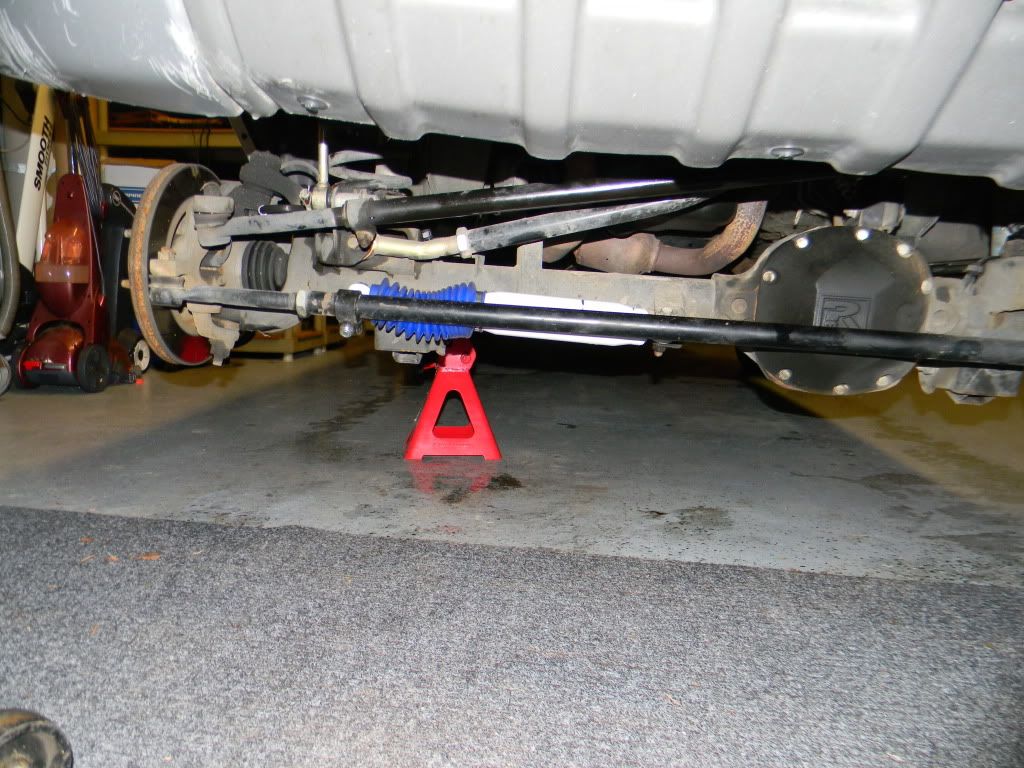

Picked up a Moog Super Trail Boss steering stabilizer for just a tick over $50. Installed it, works great. Impacts no longer transmit through the steering wheel, it just feels solid. The original is tiny compared to this thing. My OEM SS was not totally shot, it still moved smoothly, but it was quite soft. The Moog is firm, and with this much fluid capacity should resist fade pretty well.
It's about 1" shorter at max extension than the stock SS, you'll need to move the mount on the tie rod inward to compensate. Make sure your wheels are pointed dead ahead, extend the SS to half its travel, and install in that position.

Looking into one of those Trailbosses myself... You think its worth the extra $20 or so over an OEM one?
Edit: too late I bought the super trailboss already lol. Amazon $58 with 2-day free shipping. All I needed to see were your pics and that made me remember I wanted one
So when you were putting it on did you measure the extended differences between the two and then move the mount in that much? I feel like it would be more effective than eyeballing the 1/2 extended and trying to line up the clamp while holding the SS at 1/2... although... I guess a SS isnt like a strut and it doesnt de-compress outwards without pressure on it... I dont know!
