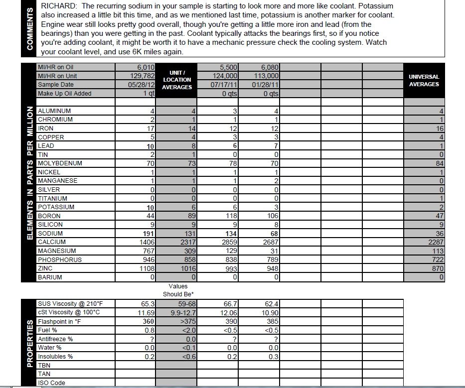

Well this is a little troublesome. Lead wear is not looking great at the moment. I have another sample on the way in (this one sat on the shelf almost a year) to see if it continues to be a problem. 6PPM isn't the end of the world but it's not 1. :-/

You made it to 244k, that's not too shabby! I'm as baffled as they are about the sodium, I mean I am losing coolant at a rate of about 4 oz/year, might be a tiny pinhole leak in the head gasket or something? Yet the Potassium levels are not indicative of a coolant leak. Maybe my short-trip driving style is contributing to bearing wear. After all, my commute is only 7 miles/day.
A couple things of note though - the 4.7 HO has tri-metal bearings (with tin, copper, and lead plating) and yet neither tin nor copper show significant wear. Tin is dead-on zero and Copper is below universal average.
Insolubles - very good. Wix filters FTW!
Viscosity - very thick, even at 6000 miles
Magnesium - why so different? I used Mobil 1 HM 10W-30 from Walmart on both of the changes shown above. Ca, Zn, P, all significantly higher as well. I wouldn't expect that with only a 500mile difference in OCIs.

Well, I gave Blackstone some more infos about my driving conditions and got this in return:
Richard,
Thank you for the follow-up information. It's entirely possible that the use you mentioned explains the bearing wear that we've been seeing. If it holds steady in future samples, it might not be a problem, but rather a side effect of the use your engine sees. We'll keep an eye on lead. It's not like 6 or 7 ppm is a huge problem, but it's higher than universal averages, and until we have solid trends built, it's hard to call it normal.
We don't actually test coolant itself at our laboratory, so we're not sure of the composition of certain brands coolant. What we're checking for is the footprint left behind when the coolant burns up/evaporates when it comes into contact with hot oil. In most cases, that footprint is potassium and sodium. Sometimes there's silicon thrown in there too. Sometimes you see one without the other, but that's fairly rare. But, since you're noticing coolant loss, and you're sure you're using Mobil 1, the sodium could very well be from the coolant. In that case, that might explain the bearing wear. If this is coolant, at this point, the wear is very little and the leak is very small, so you might not need to take any action. But if you'd like to get down to the bottom of it, you could see about having the cooling system pressure checked to see if that gets you any answers. But like I said, this is something your engine seems to be living well with for the time being, so that's sort of up to you and your budgetary constraints.
Sincerely,
Amanda Callahan
Blackstone Laboratories
I sent in another sample from my latest change so we will see what they say. I'm thinking about using some of the Blue Devil head gasket sealant - while stop-leak products are usually ill-advised, I have found nothing but good reviews for this stuff, even from people with completely blown head gaskets.
~Richard

Well, I got my most recent UOA back and it's not stellar.
Sodium and Potassium are on the rise, and Lead is increasing as well. So maybe there's a tiny head gasket leak? I can't say. I added about 4 oz of coolant 3-4 months ago and it is still dead-solid on the full line. Bear in mind it took me almost a year to get the 6000 miles for this oil change, so there are a LOT of cold starts, drive 3 miles to work, and shut it off. Also, a lot of wheeling.
Of note is that Mobil1 High Mileage formula has changed it's formula. Note that the Calcium (cleaning agent) has been essentially halved but there's a boost of Magnesium. Overall I'm not impressed with the wear numbers with this current formulation of M1HM. Blackstone offered to do a Virgin Oil Analysis for free so that we can both benefit - trying to see if they have started using Sodium or Potassium as additives, and of course to track down the current formulation of M1HM. The good news is that the ZDDP is still strong with M1HM.
