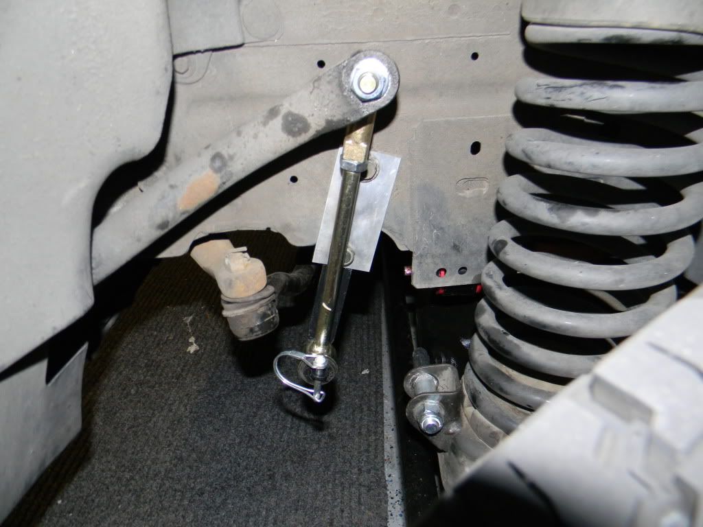

Up front, I had slight clunking from the JKS Quicker Disconnects and I had tried everything possible to correct it. I heard from some folks that Rough Country QDs were clunk-free and a simpler design. I got those in yesterday and they are defective right out of the box. I have a number of complaints about the design. For one, the torque specs listed in the instructions are much too high for the grade of hardware used. The hardware is of such low quality that while attempting to torque to the spec indicated, I pulled the mounting stud through a 1/2" washer and crushed the lower rolled steel sleeve/spacer. I partially rectified this using some leftover grade 8 washers and a lower torque spec. Where the upper stud bolts to the sway bar, you have a 3/8" stud (maybe 7/16") going through a 9/16" hole. There's lots of room around the stud and NO washers to distribute load. I had to add washers here as well. My main complaint: the bushing on one side is defective right out of the box, as in plain-old-doesn't-fit defective. It is loose and sloppy and surprise surprise, it's a clunk factory. RC has a replacement part on the way, but based on the lack of intelligent design and the low quality control, I will probably avoid RC parts in the future.

While waiting for my replacement bushing to show up, I am running disconnected. I can't stand the constant clunking. Lo and behold, the mounting tabs are WAY too short for my current lift height, so I fabbed up some small extensions from aluminum stock to lower the tabs to a workable height. This took a little trial and error to find a location that was easy to connect, would not rub the mount at full lock, and would not hit track bar or pitman arm at full stuff/full lock. I'll add pics later, but I am happy with my work.

Pictures of the RC vs JKS and new bracketry requirements.
Assembled JKS vs assembled RC. Note that the JKS is adjusted to the correct length for a 3" lift. The RC does not have any adjustment shorter and only 1" of acceptable adjustment longer.
RC end links installed. Note the small black bracket between the pitman arm and track bar which is where you secure the end link when discoed. At this short of a lift, moving the sway bar up an additional 3" when discoed is very difficult.
New aluminum bracket extension installed! In this position it clears the pitman arm and nothing is really close when flexed. The brackets reuse the motor mount bolts that pass through the frame rail. Note that in this position, the sway bar does not need to move to connect to the mounting bracket when discoed. Also, you can see in this image (normal ride height) that the sway bar is up around 45บ and should be around 30บ for optimum ride and performance.
Passenger side bracket.

Originally Posted by SnowLeopard View Post
Is it just me, or does the JKS design look better?
It is stronger and easier to use, more adjustable to boot. But, the RC are lower profile and significantly less clunky...but not clunk-free.
