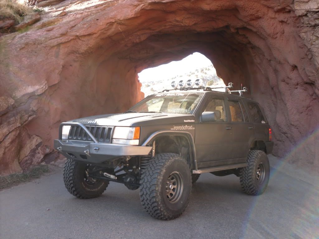

my ZJ
fenders, cladding, center of hood and roof = Herculiner Bedliner
the rest of the Jeep = Rustoleum spray on bed liner
