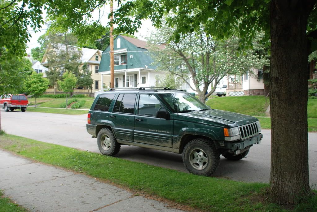

I wheeled it some in VT:
Added an AEM cone filter and TB spacer. I ended up building my own heat shield later. That's now replaced with K&N I found in a junkyard:
All along, I knew it needed a lift. I purchased a pair of 2.25" coil spacers online, traded a gas tank skid for a set of ProComp 3" rear springs, and bought some Black Diamond AT's. I also installed my transfer case skid. Had to wheel it some after I lifted it.
Flexing it out a bit on top of Nobscot Mountain in Sudbury, MA:
Over the course of the summer, I didn't do much in terms of modifications. I did wheel it a couple of times, and test out the tow hooks in Western Mass.
I didn't do much more until the end of the summer. I found a 5.9 sound bar for $55 shipped on ebay, and a set of clear corners in a junkyard. I wired up the soundbar and popped the corners on.
Once I started my new job, I had the cash to afford a bunch more stuff for it. I found a set of Hella 500FF's for $60 shipped on ebay for the front, which I mounted up. I stuck a set of Silverstar Ultras in the headlights (another ebay find), and added a 5.9 roof rack and shift knob.
I played around in the mud some, but didn't wheel it really until a few weeks ago. After I wheeled with a Bronco on 38's, I knew it had to go bigger, and the lift bug bit again, so I started accumulating parts.
Latest install involved Teraflex swaybar disconnects . . . thank you ebay again.
And the latest picture I have:

Did a few more things to it lately . . .
-Installed my Energy Suspension sway bar mounts front and rear. Big difference, due to the amount of slop that I had in the original bushings.
-Broke both of my Teraflex discos where they mount on the sway bar. They never fit perfectly, and I think they just gave out because of the stress over time.
-Installed my Rubicon Express steering stablizer over the weekend. Didn't really cover up my death wobble, but definitely helped the Jeep track straighter down the road.
-Installed Alpine Type S 5.25" in the soundbar. Nice to have that back in the ZJ after a couple of weeks without it.
Still needs a few things though . . .
-Exhaust. I have the tailpipe and cat, I still need the correct Flowmaster 40 series, and Mopar O2 sensors before I get it installed. I plan on doing a 2.5" pipe from the manifold back.
-Waiting on my spare wheel and I need some spacers before my new wheel/tire combo can go on.
-Still accumulating parts for my lift. The plan looks like 4.5" at this point.
