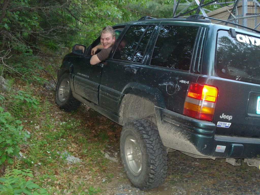

I decided it was time for some skids. I found a gas tank skid for $10, mounted it up, and did this shortly thereafter:

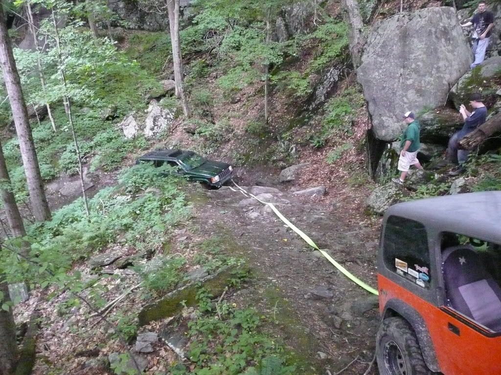

I made use of my shovel, a buddies shovel, 2 XJ's, my new receiver shackle, and 50' of tow straps to get the ZJ out. I was up to the hood in a snow drift, and sitting nowhere near the bottom.

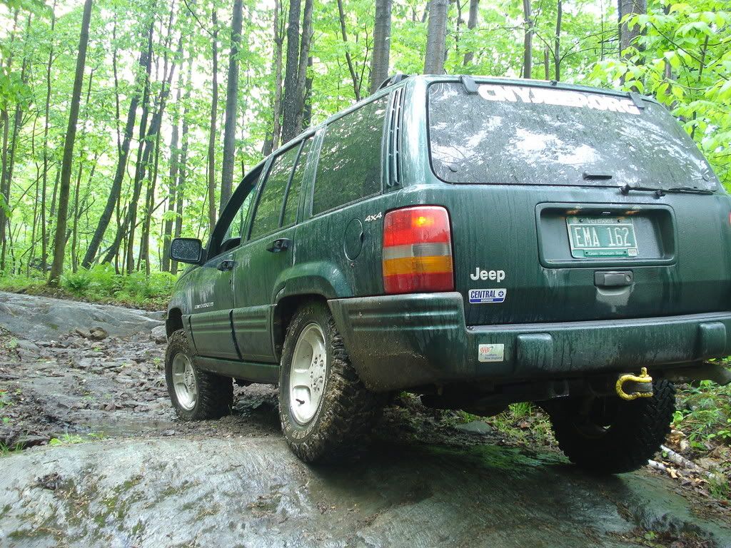

I wheeled it some in VT:

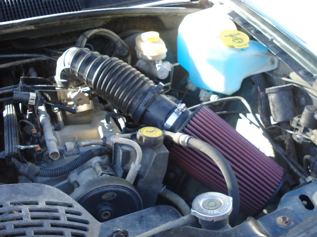

Added an AEM cone filter and TB spacer. I ended up building my own heat shield later. That's now replaced with K&N I found in a junkyard:
