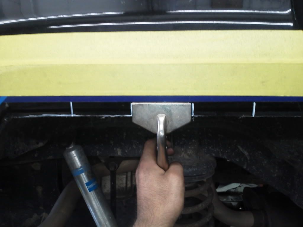

Got started on the rear driver fender this afternoon. I hate this inner and outer body panel crap. I was planning on riveting stuff together, but looks like I'm going to have to get it welded now. I guess I took to much metal off with the flap wheel and some of the outer panels came off. Part of me just wants to just fill it with silicone and be done with it.
Here's some pictures:
From the outside it looks decent, but if you look in there it looks kind of crappy.
What do I need to do different on the other side?
With that amount i would just fill it with silicon, smooth it with your finger and be done. Its looking really good man.

As far as the swing out,
I like that Idea a lot! I think it would look great tied into the exo cage. Another idea I always liked was the look of a fold down carrier that puts the tire in a sort of "cage" but that would be a lot of work to muscle up and down.
As for the fenders,
Get yourself a pair of duckbill pliers (vise grip style is what I used) that way you can make the tabs across the top a lot longer and get a straighter line. Just make the tabs as wide as the plier bills.
As far as the flaps, I wouldnt worry to much about them. But dont use silicone, at the minimum use panel adheasive. You should be able to lay that stuff on thick enough to give you a completely smooth (or close to it) edge. Plus, it's made to bond panels, which will save you from having to weld it, although a couple tack welds here and there wouldnt hurt either. The stuff isnt exactly cheap, but its definitly the way to go. I would see if you can buy a kit locally that includes the gun, and the cartridge that mixes them as you squeeze it.
Also, dont be scared to take the bfh to the lip on the far back where the bumper would go. I beat the guts out of that to take away the sharp edges. I think I only had to make one or two cuts to get it all to fold down nicely.

Thanks for the advice TJ. Right now I think I'm going to have someone weld it up for me. Just do it right the first time. There is a guy that is doing my buddy's cage in his YJ and from the looks of it he does pretty nice work. Charges very good prices, but has a long turn around since he works a lot. I figured if he was going to weld up the fenders, why not have him do up the bumpers and put me in a new radiator support while he has it. I'm about to send him a message to see what we might be able to work out.
Then when I get it back, I can smooth out everything with some adhesive. I remember seeing SaturnICL say duct sealant worked well, too.
That's what I used on mine. Tough to get smooth if that's what you're looking for, I didn't care, its an inner fender. I just wanted something to seal up the seam that i could spray black. Takes a day or two to cure too so take that into account as well.
Its sandable and paintable too which is nice.
