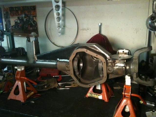

Why are they wanting you to convert over to kingpin? I really havent heard that much bad stuff about the balljoint axles, especially when your trying to keep the costs down!
Too bad you aren't closer to me, I'd love work it out to build your WJ
I think its because I put down "unit bearing elimination" as a maybe on my list of things that I gave them. I mean that conversion alone is like $1500. So they figured just going old school with king pins, spindles and true high steer would almost be less money in the long run. Even said they would retube the axle for 79 D60 axles mainly because the driver side tube is basically non-existent. But like you said, I haven't really heard anything that bad from these axles. They are actually building Allgood_73's TJ over there right now and he has the same axles. He is going coilovers as well, so I feel like they can handle that short side with my build...
(Picture taken from Allgood_73's build thread)
I'd also have to run 3/4 chevy calipers and rotors and not just off the self 99-04 SuperDuty stuff if this whole big conversion happened. Don't know how to feel about that...
