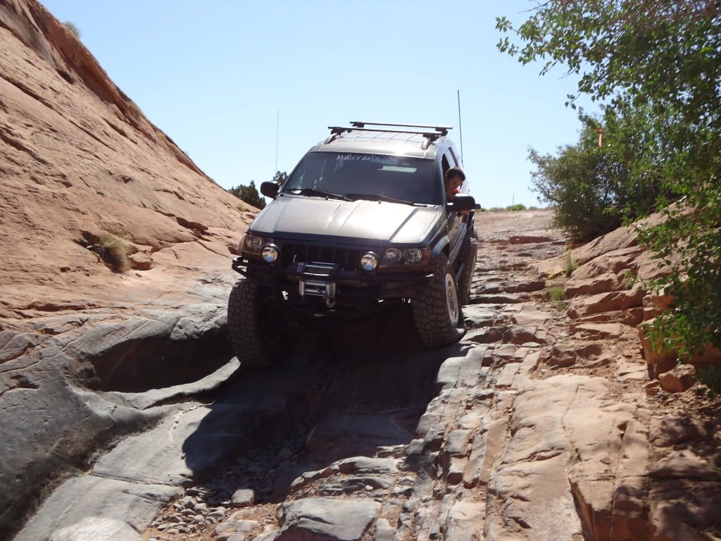

Most people don't air down that low. You start to lose to much clearance at that low of a psi. I run 8psi in mine and am probably going to bump up to 9 or 10 because it is almost to low. Look at my driver side tire at 8psi when flexed.
