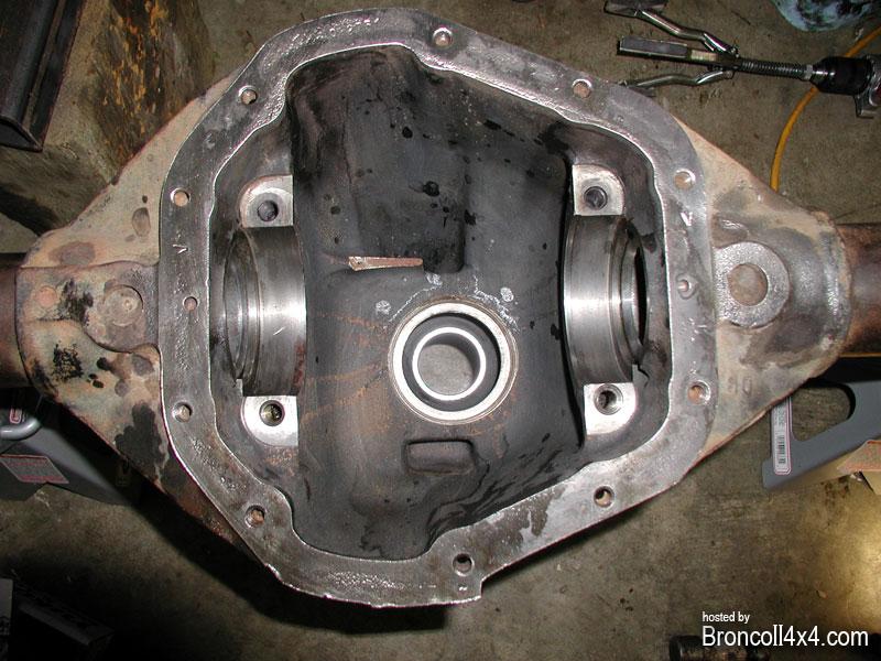

Now, I'll offer a little bit of tech for the folks here on JF or anyone that might find their way here through Google/Yahoo/Bing/etc.
In doing research about the front axle in particular, its pretty easy to mistake a solid axle Dana 50 and Dana 60 out of a Ford F-Series. Basically everything on the outside LOOKS the same but the internals are very different. Here are some facts about both from Randy's R&P (for Ford trucks):
Originally Posted by From Randy's Ring and Pinion
Dana 50 Front, Straight Axle
Ring Gear Diameter: 9.000
Cover Bolts: 10
Ring Gear Bolts: 10
Spline Count: 30
Dropout: False
Pinion Support: False
Carrier Breaks: none
Rear Suspension:
Pinion Nut Size: 1-1/8
Compatible with Models:
Excursion: 2000 - 2005 (Front)
F-250 3/4 Ton: 1999 - 1999 (Front)
F-450: 1999 - 2005 (Front)
Super Duty F-250 3/4 Ton: 1997 - 2004 (Front)
Dana 60 Reverse Rotation Front
Ring Gear Diameter: 9.750
Cover Bolts: 10
Ring Gear Bolts: 12
Spline Count: 35
Dropout: False
Carrier Breaks: 4.10 / 4.56
Rear Suspension:
Pinion Nut Size: 1-5/16
F-350 1 Ton: 1978 - 1997 (Front)
F-450: 1999 - 2004 (Front)
F-550: 2000 - 2004 (Front)
Super Duty F-250 3/4 Ton: 1999 - 2004 (Front)
Super Duty F-350 1 Ton: 1997 - 2004 (Front)
Another notable difference is the pinion nut size. I actually used this when I was at the salvage yard to be 100% sure they were giving me a D60 and not a D50. Reason I didn't trust them was because they said the front end out of the F-250 was EXACTLY the same. As soon as they brought over the axles I put the 1-5/16" socket I had with me on the pinion to make sure. Now I wouldn't say the D50 is necessarily a bad axle, its just that the aftermarket sucks for it.
Here are some pictures of a D60 vs. a D50 (notice the casting on the inside):
Ring gear size differences (left to right: D60, D50, D44, D30):
Maybe it will help someone down the road.
