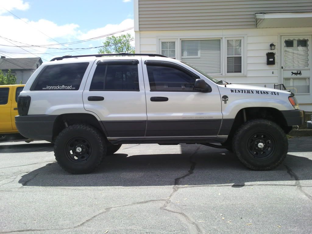

I think you should paint it the color of your jeep. I painted mine Silver and added the same decal I have on my fender to the diff, my jeeps name is ''The Punisher" so I found it fitting.
My jeep:
My 44hd:
