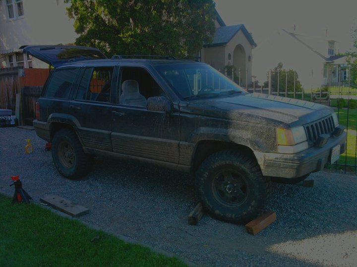

post #87 of 218 Old 10-03-2011, 08:12 PM Thread Starter
ninjastar
Location: Carson,CA
Posts: 551
Okay heres my baby with its new shoes. Seemed like everything workedout fine and I went with the 31's. No rubbing anywhere but the front bumper. So I trimmed it to the point where it stopped rubbing. But quick question, I measured all my wheels from the center cap to the fender and everything seems good but my right side rear sits at 21 while the rest sit at 20. Did do something wrong durning my installation for my 1.75in spacers??
ninjastar is offline
post #88 of 218 Old 10-03-2011, 08:32 PM
sabzz
Location: Wichita
Posts: 1,436
Dang those look good! Nice job man! As for the off set, I wouldn't worry about it unless it causes big problems.
