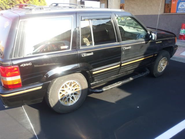

Was at Kragen and was like hey it would be fun to go up on here xP

how have you not taken your side steps off yet? that would have been the first thing i'd done.
Freestyle713 is offline
