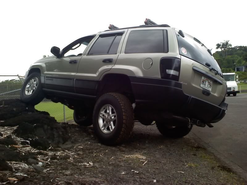

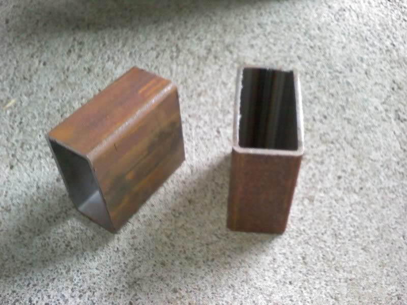

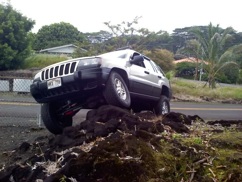

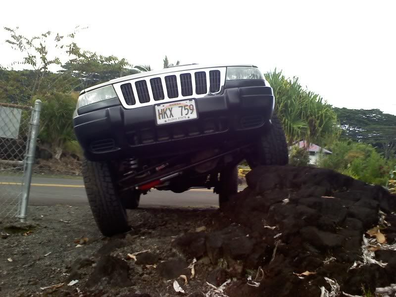

Today I made my own extended bumpstops since I couldnt bare to spend 50 bucks on something so simple...
Bought rectangle block metal from a local shop. They cut them and gave them to me for 5 bucks. Hella alot better than 50 + shipping!! Measurements of the blocks are 1/8" thick, 1 & 1/2 wide, 3" long, 3" tall. I then disconnected my battery terminals, grounded as close as I could and prepped the axle and blocks with sandpaper. Welded them down to the axle and goooood to go
I couldnt get any pics of the blocks welded to the axle, everytime i tried my camera phone blinded it with the flash, or was too dark without it...
Is it me or could I flex more? I couldnt find anything more to climb..
